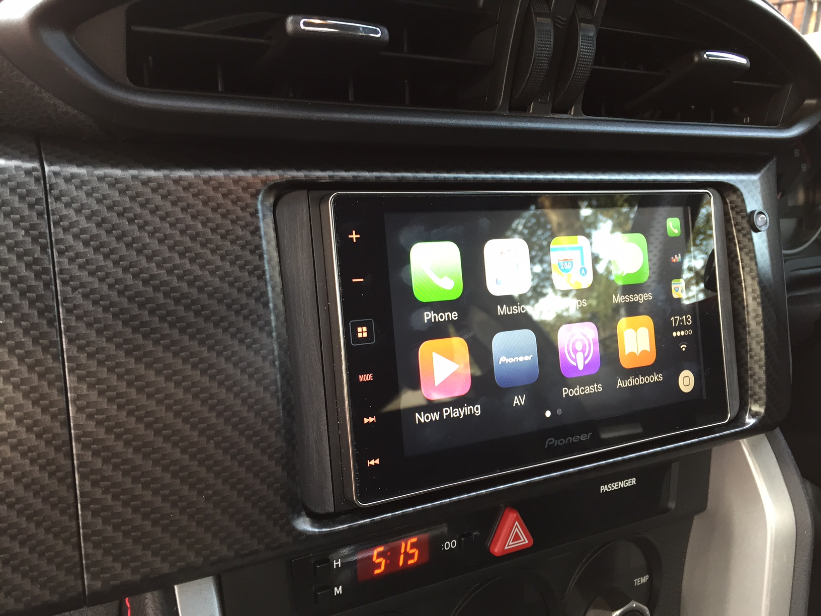

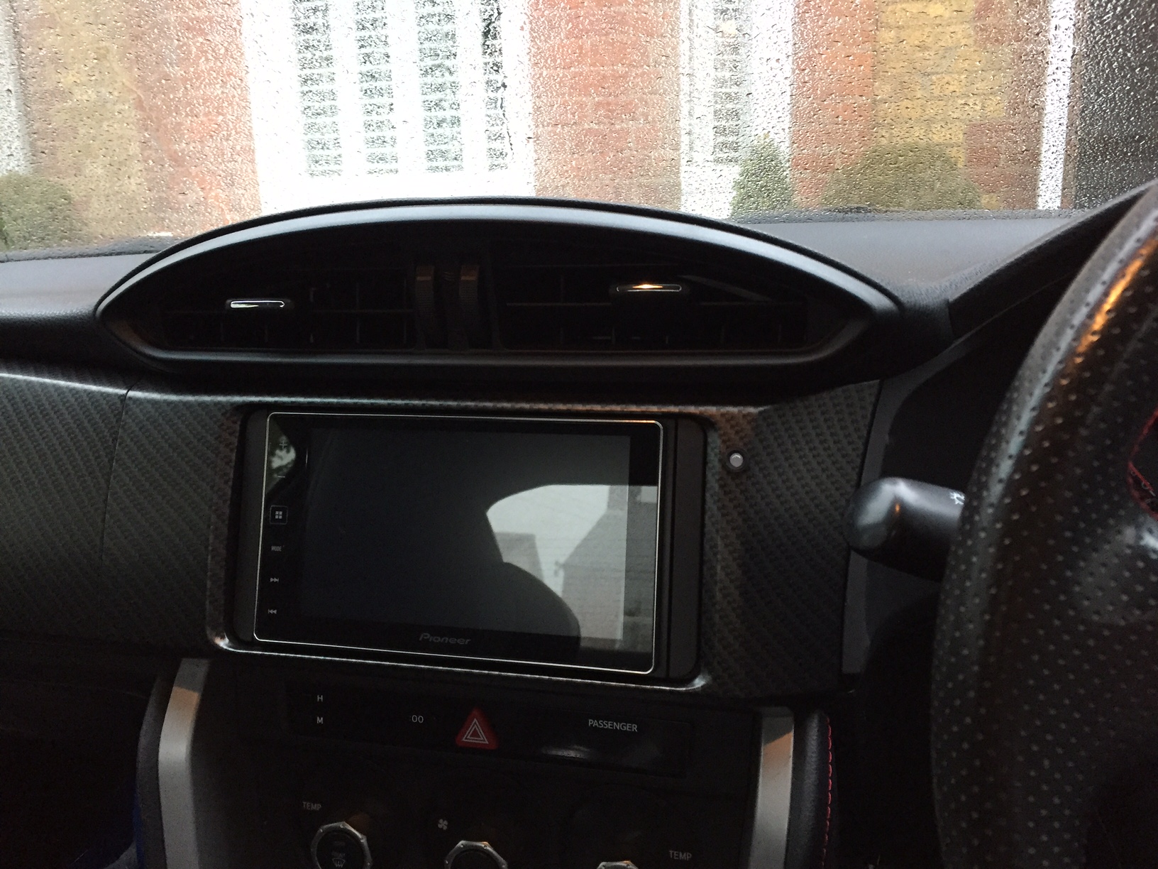

McDude 40 Report post Posted September 25, 2017 For what it's worth, here is what the Apple CarPlay looks like: It's actually a very nice piece of functionality BUT you do have to have your iPhone connected. There's another screen which also has the apps for things like Spotify so you can run that painlessly. Overall I'm delighted with the unit and would recommend both in terms of looking right for the car and functionality, provided you don't need to play CDs and don't want DAB. As per previous post there is a unit coming out (possibly out now) which has DAB as well but it puts the price up. As for sound: it sounds fantastic even with the stock speakers but I'd bought the Focal IS165TOY speakers so fitted them anyway! The Focals have a significantly bigger magnet on the back: They weight a chunk more too (sorry Colin Chapman). What is astounding is just how light the stock speakers are! They do add a depth to the sound which the stock speakers couldn't manage, bass is deeper and tighter. Now the system really does sound the pips! I know there are plenty people on here with additional amps and subs but I find myself wondering where you 'fit' this additional sound!?! I can get this system to ear bleedingly loud with no distortion; the bass is nice and acceptable - I'm not hitting the brown note and setting off car alarms but I don't want to. I've been down the road of big ICE installs in the past and I'm not knocking it, just if someone like me is pondering what to do with their stereo and wondering what is 'enough', a decent headunit and some fairly cheap (they were only £119) speakers and you're away. I didn't bother with the back speakers, save your cash. I also bought some lightweight Dynamat but I've hardly used any up, I did the doors, threaded a sheet about the size of an A4 piece of paper through the speaker hole and covered the bit of door around the speaker, but that's it. Maybe it's my old ears but I don't drive along thinking the NVH is terrible; it doesn't sound like a particularly refined car but frankly I hate that all what we used to call feedback has been dialled out on modern cars. I've thought about lining the boot, but there's already some soundproofing there and it seems to do its job. In conclusion - I bought the car to drive and enjoy it. I like that it is 'under' powered and 'under' tyred; the handling is sublime and it looks great so I don't want to change a thing about it. But even I had to concede that the stereo was dreadful, but I believe for ~£500 I have purchased a whole new system which will give all but those with robot's ears a high quality audio experience. 2 nerdstrike and TommyC reacted to this Share this post Link to post Share on other sites
Guest 86guns Report post Posted September 26, 2017 I like what you’ve done here. If I had my time again I might do something similar. I was told numerous times that the stock head unit is sufficient and so I went with speakers and an amp, but what you have done is very similar as the Pioneer will have more power than the stock head unit. Your system is a neater solution to achieve similar results. Share this post Link to post Share on other sites
McDude 40 Report post Posted September 26, 2017 2 hours ago, 86guns said: I like what you’ve done here. If I had my time again I might do something similar. I was told numerous times that the stock head unit is sufficient and so I went with speakers and an amp, but what you have done is very similar as the Pioneer will have more power than the stock head unit. Your system is a neater solution to achieve similar results. Thanks 86guns - I didn't have a choice in updating the headunit as the Subaru stock item is such a turd. I was close to going down the external amp route, 3-way speakers up front and all the rest but figured that a 165mm speaker should be able to put out a fair bit of sound and that an internal amp 4x50W should be more than capable of filling the car. Like I said, I'm very pleased with the result and would personally struggle to get value out of anything additional - my ears just aren't that good! Share this post Link to post Share on other sites

nerdstrike 186 Report post Posted September 26, 2017 Nice work on the bezel filling, but does sound like a lot of fiddling about to make it fit flush. I fear I'll have to do something similar when I ultimately ditch the Toyota unit. It may not suck Subaru blue balls, but it's still annoying a lot of the time. Is the Pioneer bolted in? i.e. can someone pinch it with some coat hangers? Share this post Link to post Share on other sites
McDude 40 Report post Posted September 26, 2017 43 minutes ago, Nimz said: I had this unit on my 350z, great bit of kit and very subtle/OEM looking. Did your original BRZ unit have the ability to take phone calls? Just wondering if I can keep the existing mic from the standard 86 head unit if I upgrade. The original Subaru unit couldn't make calls, it was one of the reasons for ditching it. So I've had to run a new mic, however if your GT86 has a mic already I'd use that if I were you, my mic install is okay but it is a bit aftermarket looking. I'd imagine you might need to cut it out of the Toyota loom when you take the original headunit out, but it's only 2 wires so should easily splice into a 3.5mm jack which then goes into the back of the Pioneer unit. 18 minutes ago, nerdstrike said: Nice work on the bezel filling, but does sound like a lot of fiddling about to make it fit flush. I fear I'll have to do something similar when I ultimately ditch the Toyota unit. It may not suck Subaru blue balls, but it's still annoying a lot of the time. Is the Pioneer bolted in? i.e. can someone pinch it with some coat hangers? Not too much fiddling, just 5 mins with a Dremmel to make the sides of the plastic thinner. The Pioneer unit is bolted in just the same as the original unit so it's as secure as that is (arguably not massively as it is only 4 x 10mm to take out). I reused the original brackets but I did have to cut the very top off them to make them fit. The holes line up perfectly with the Pioneer unit and they go straight into the chassis not the wire cage that comes with it - I didn't use the cage at all. 1 nerdstrike reacted to this Share this post Link to post Share on other sites

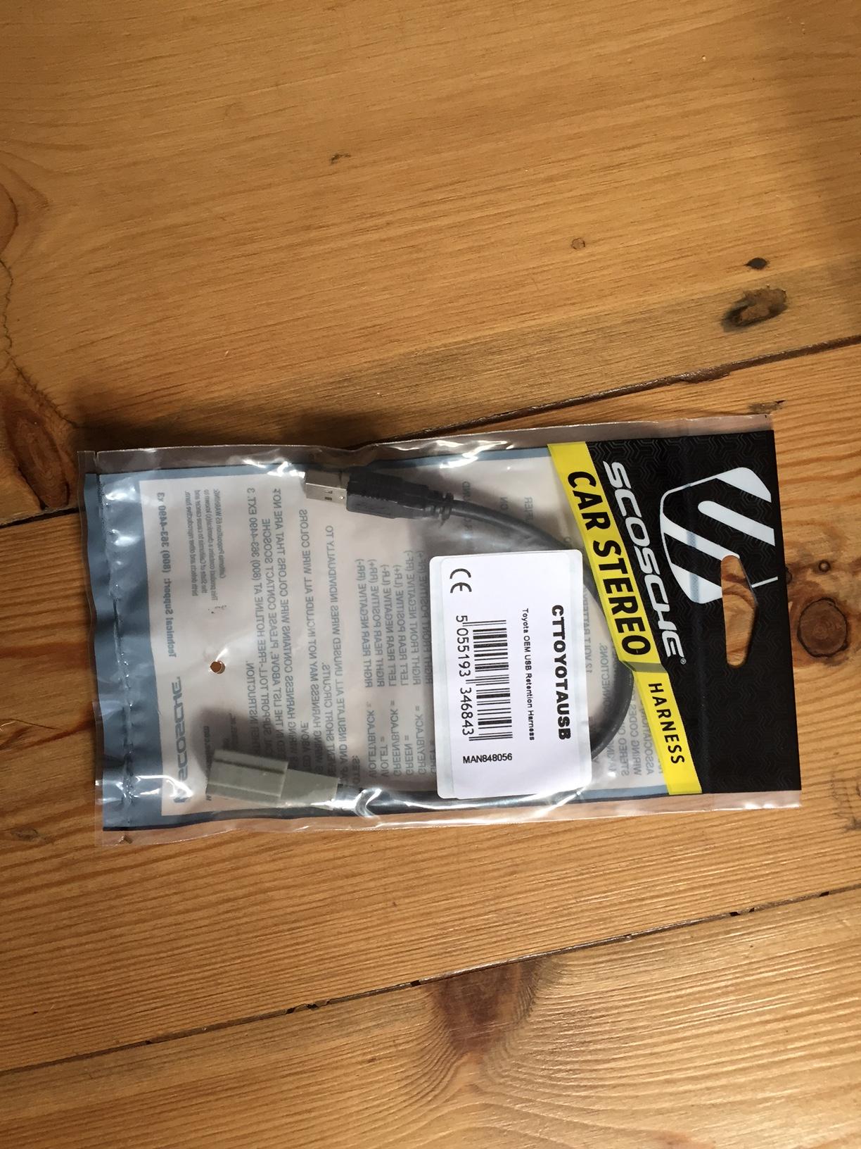

benmmellor 44 Report post Posted February 25, 2018 Currently considering the SPHDA230DAB unit - it's mechless to no CD lot but looking at the notes you made, I should be able to use the USB port still... Yet another decision to make - can I live without the CD slot! Share this post Link to post Share on other sites
McDude 40 Report post Posted February 26, 2018 19 hours ago, benmmellor said: Currently considering the SPHDA230DAB unit - it's mechless to no CD lot but looking at the notes you made, I should be able to use the USB port still... Yet another decision to make - can I live without the CD slot! Yep - the USB works if you buy the jumper loom. I'd actually be tempted to run the cable to the armrest as this is where my phone tends to sit. I don't miss the CD slot at all and it's a great excuse not to play Disney CDs if the kids are in the car! Share this post Link to post Share on other sites

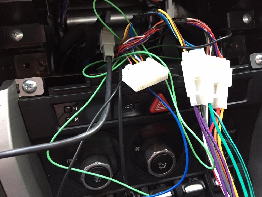

Phl White 0 Report post Posted March 4, 2018 Thanks for this great guide. I have just replaced the factory TAS300 with a Pioneer SPH-DA230DAB and installed the same Antenna Adapter as you have but i am not getting any FM reception. Do i need to link the blue lead in somewhere and if so where do i do this please. **** RESOLVED **** I connected the blue wire from the antenna adapter to the blue/white wire from the loom supplied with the new head unit after watching a video on Youtube, however the blue/white wire was labeled Remote Control so i tried it and it worked. I just need a DAB antenna now and the job is complete. Share this post Link to post Share on other sites
McDude 40 Report post Posted March 5, 2018 17 hours ago, Phl White said: Thanks for this great guide. I have just replaced the factory TAS300 with a Pioneer SPH-DA230DAB and installed the same Antenna Adapter as you have but i am not getting any FM reception. Do i need to link the blue lead in somewhere and if so where do i do this please. **** RESOLVED **** I connected the blue wire from the antenna adapter to the blue/white wire from the loom supplied with the new head unit after watching a video on Youtube, however the blue/white wire was labeled Remote Control so i tried it and it worked. I just need a DAB antenna now and the job is complete. Glad you found the answer - yes, the antenna is powered and needs a feed from the head unit. I don't have DAB but others have put the receiver in the recess in the dash where your tweeter sits. There's plenty of space there if you don't have the 4" speaker (which most don't). I've put my GPS antenna there. 1 General_Kirby reacted to this Share this post Link to post Share on other sites
