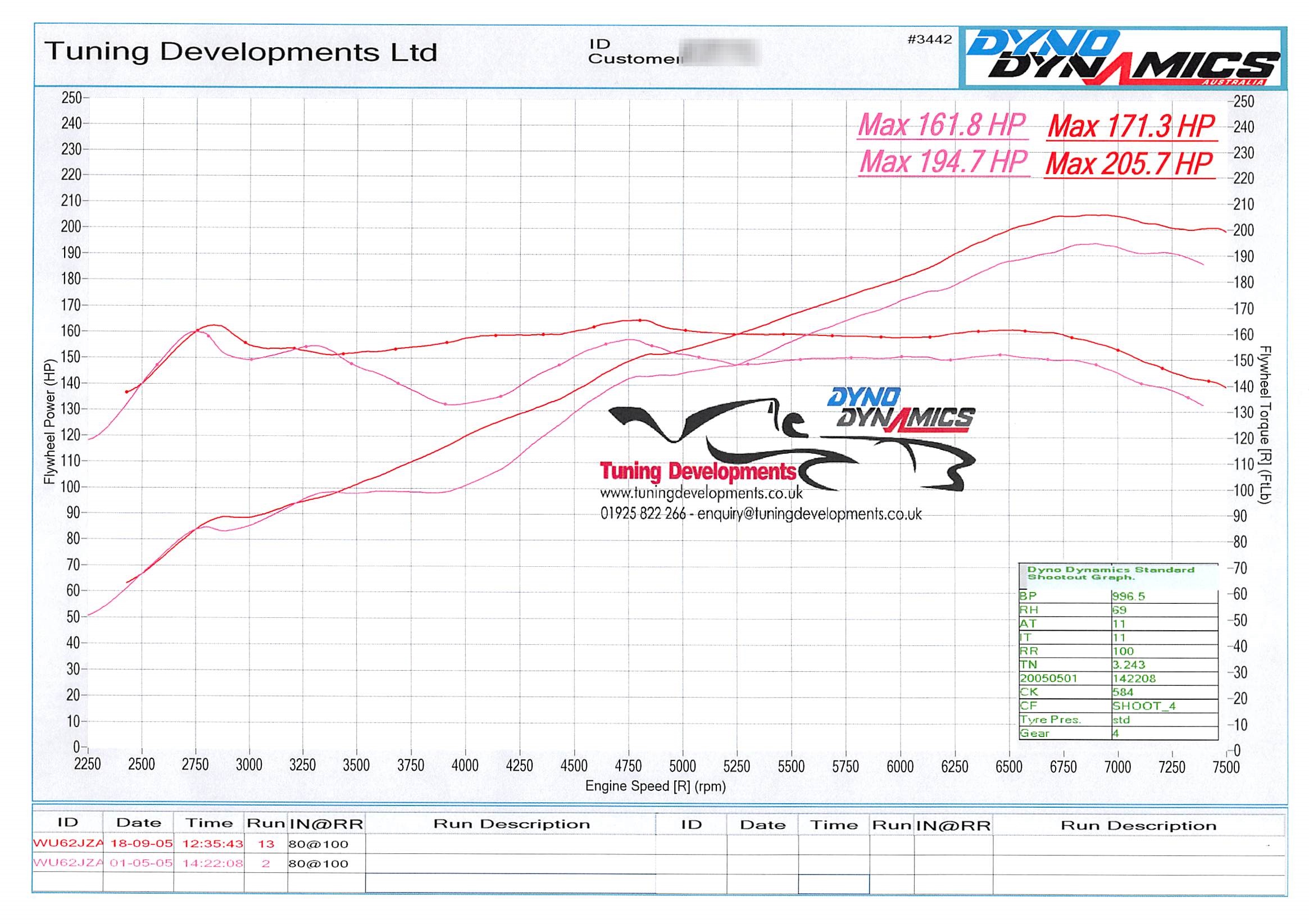

long-gone 152 Report post Posted August 14, 2016 Further to my post here: CLICK - job's a good'n. Mike and co at Tuning Developments has done a sterling job, despite time consuming complications. Not sure what the problem was exactly, but they were working on it until gone 9 o'clock on Saturday night and again Sunday morning 'til lunchtime. I'm pretty sure I'm not their favourite customer right now. Anyway, the work. 50,000 mile interim service couple of gaskets on blowing exhaust swap front & rear tyres install Bilstein B14 suspension kit UEL manifold fit & map It's the first time I've used Tuning Developments and very happy with service and all aspects of communication. Mike explains everything very clearly so even those of us hard of thinking can understand. Not greedy either, as he could've pushed me into the over pipe but said that as I have no plans to go FI I'd probably not see the benefit, so that saved me a few bob. Once I get back to the office I'll scan the chart, but for the moment, just be assured that the infamous torque dip has been eliminated. Not just in black and white on the chart, but according to my arse/seat dyno too. It's not been miraculously transformed into a rocket ship, but it feels like it. A bit. Mainly because it's so feckin' loud! Seriously. When I first heard it I didn't appreciate quite how loud it is - I just grinned like a kid. It has a very Subaru, off-beat, four banger, boxer burble which barks like a NASCAR on full chat. I suspect it's the AVO TurboWorld 2.1/2" cat-back combined with the TD UEL headers that's responsible. Others with stock exhaust don't seem nearly as loud. It's all a bit ASBO for my liking so am investigating how to reduce the volume a little for those early morning starts and my neighbours' peace of mind. Extremely happy with the coilovers so far. Nice one nicebiscuit. I think the ride is slightly firmer than OEM, but the damping over rough surfaces is leagues ahead. Grip and cornering is also much improved. Aesthetically, not sure by how much it's lowered the car, but the wheel arch gap is reduced a little so guessing maybe 3cm(ish). Oh yes, Mike (the b*st*rd ) took me for a spin in their turbo charged car. It's a very nice implementation - not savage like some of them, but a steady surge of increased power and torque. One thing that's hilarious is the 'screamer pipe' I think he called it. It's brilliant! One day, I will go for one of the FI mods, but not today. 5 Mike@TD.co.uk, Will T8WMM, Lauren and 2 others reacted to this Share this post Link to post Share on other sites

Robins 4 Report post Posted August 17, 2016 The after graph looks a lot better. It must help massively in day to day driving with a nice big lump of torque instead of the flat spot I'm pretty sure I'll be going to tuning developments with mine in the future Looks to sit really nicely on the billies as well mate, I had the B14 kit on a Golf R32 I had and really rated them. 1 long-gone reacted to this Share this post Link to post Share on other sites
