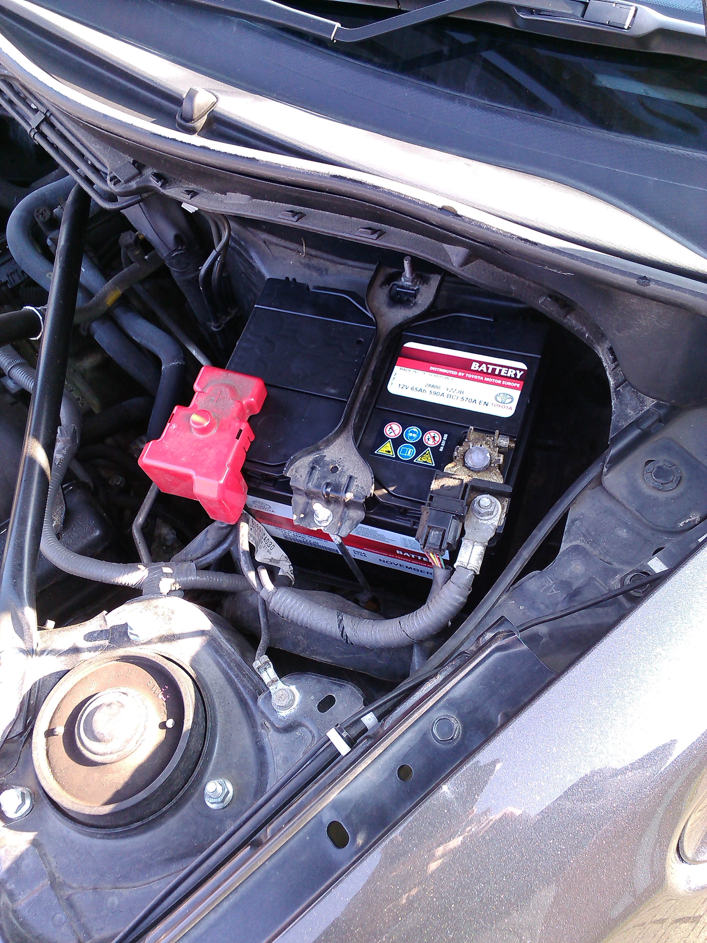

Deacon 1357 Report post Posted March 6, 2016 Thought this might be useful for people who have bought their 86's used and are unsure whether they have a 'new', more powerful, or 'old' battery. First picture is the 'new' battery (you can see it's all black):- Second picture is the 'old' battery (you can see it's white with a black top):- 4 Keethos, Gringosteve, Rallyenick and 1 other reacted to this Share this post Link to post Share on other sites
Rallyenick 30 Report post Posted March 6, 2016 Just gone through this ordeal myself, battery would go flat, would have to jump to get to the dealership for them to test the battery, which would never fail, so I stumped up and bought the replacement. Below is a picture of the old battery and the new one. Note the significant power difference. Sent from my iPhone using Tapatalk ** note top is old, bottom is new ** 1 Gringosteve reacted to this Share this post Link to post Share on other sites
nerdstrike 186 Report post Posted March 6, 2016 Wow, these things are puny. My ol' RX8 had 68 Ah and crazy cranking amps. I don't know how they ever thought the white-sided batteries would take all the electrical accessory loads, auto-controlled headlights, keyless entry and alarm etc. in poor conditions. Share this post Link to post Share on other sites
rob275 1817 Report post Posted March 6, 2016 The sad thing is they are still putting the crap batteries in the cars at the factory... Faiths new aero has the 48Ah battery lol. 1 Gringosteve reacted to this Share this post Link to post Share on other sites
