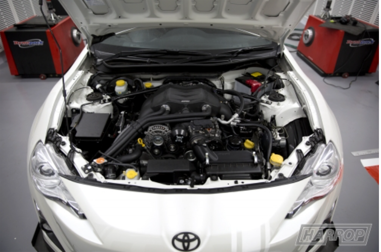

Yes they have smaller losses but the kit doesn't fit as nice/look a snice in our eyes that why we use the Harrop kit, regards R&D can you enlighten me please what Cosworth have done over and above what Harrop had done please? I presume you referring to the engine work they did in regards engine loading.
, exactly them same as Harrop did when they developed the kit , they have had a GT86 Development car for a long time.

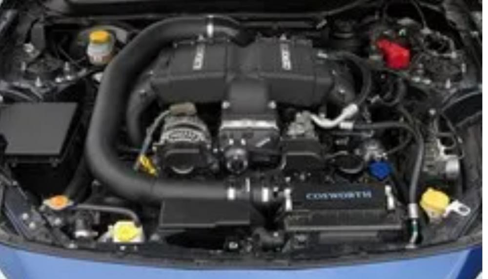

Thank you Mark. That's a great start to acknowledge that Cossie has smaller losses.
On the looks department, they are very subjective and i have good forum friends who use this kit , so i dont want to get too judgemental.
On balance, i prefer the clean no pipe design of the Cosworth SC. Harrop has too many flex pipes coming out. The pictures speaks a thousand words.
Are you saying having a test car is sufficient evidence that Harrop have been as thorough in their design? I am very keen to see them talking / writing about them having engine dynos  (not chassis or hub dynos please) which Cosworth has from their F1 experience and the engine being tested for 10000 hrs on full load vs no load for 30 sec interval each. If Harrop had done this kind of work, i would imagine it would be all over their marketing to show their prowress and i have seen none.
Individual cylinder pressure tailoring, calling out reliable power limits and their mathematical simulation software used for it, what are the weak points/failure points are, limiting factors are all signify amazing engineering and thorough R&D. Cosworth support the kit with tunes which they personally remote tune for every customer, whether the first owner or later. I have never seen this level of customer support and focus on perfection!
A company with one third the size  (revenue, resources, people) has the same credentials and ability to test is something you are saying and i find it very hard to comprehend. And on this note, i will carefully say that i am not slating Harrop but saying car industry (including aftermarket) is a highly resource intensive industry. There is a reason why Cosworth is used by Aston Martin to make the Valkyrie engine and Gordon Murray not Harrop unfortunately. And with this, i rest my case!
You could say that the long intake pipe on the Cosworth is a little ugly and un-needed when the intake can go directly into the from of the Charger housing, like wise the Harrop Charge cooler pump is hidden away and the header tank built in the back of the Manifold which is a far tidier build.
When Cosworth designed the kit the front inlet based TVS 900 did not exist. Harrop came in a bit later, so had the front inlet based Eaton option. The intake pipe made of aluminium and not silicone hose, shows the commitment to quality and looks amazing to me :)

It’s worth pointing out that the reason the TVS900 is more efficient is because it’s a much smaller blower. Consequently if the buyer decides they want more power in the future they’ll find the limit of the Cosworth kit a lot earlier as it simply isn’t capable of moving as much air as the Harrop kit.
Good point, well made but lets get it into context. In the context of the capability of the car, the engine and other parts will give up far sooner than the Supercharger will reach its limits even with smaller pulley. It is about right sizing, not over sizing. Also refer to point 2 below, where Harrop will hit its limits far sooner.
Now that you get technical, lets put more things on the table for you to think through:
1. Ever wondered why Harrop need 0.7 bar to make the same power with a bigger blower while the Cossie does it with 0.5 bar with a smaller blower? The intake runners are not optimally sized in Harrop (short).
2. Even though Harrop is designed in OZ, why are their intercooler cores a lot smaller and their high power car runs E85 not premium unleaded? The E85 is because the IAT will go very high on Harrop without it and you will pull timing and get knock before you hit your Blower limits :)
For most common folks who just want a bolt on kit and more powah!, it is much of a muchness, but for the initiated, these things are imperative.
Like for like on the same dyno?
I'm not going to get into the debate of the relative worth of both superchargers except to make the obvious point that the Harrop is available (albeit with supply shortages) and the Cosworth is no longer available.
My observation of having lived with the Harrop for a year is that it is so OEM-like as to have become a part of the engine.  This is in terms of the look, the integration and, most importantly, how it drives.  It appears to be virtually maintenance-free although I will always have Abbey take care of it as and when needed.  My respect for it has gone up the more I have learned to drive and enjoy the BRZ with it fitted and with appropriate grip in terms of suspension and wheels/tyres.  It really is a pleasure to have lightning-fast responses (unlike any turbo I have ever driven) and torque where you most need it.  I have no regrets and, together with the Rogue EL manifold, it gives me great performance within the safe cylinder pressure limits that Mark has applied.
