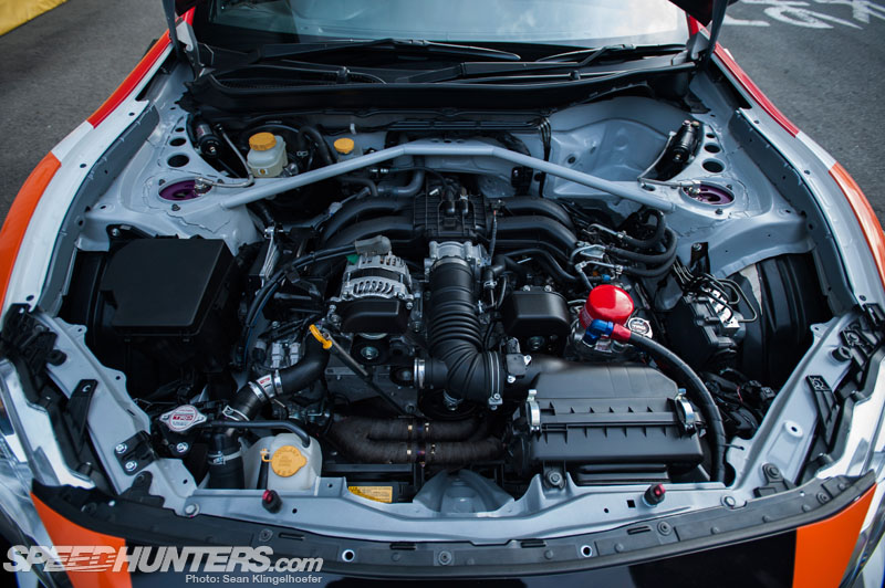

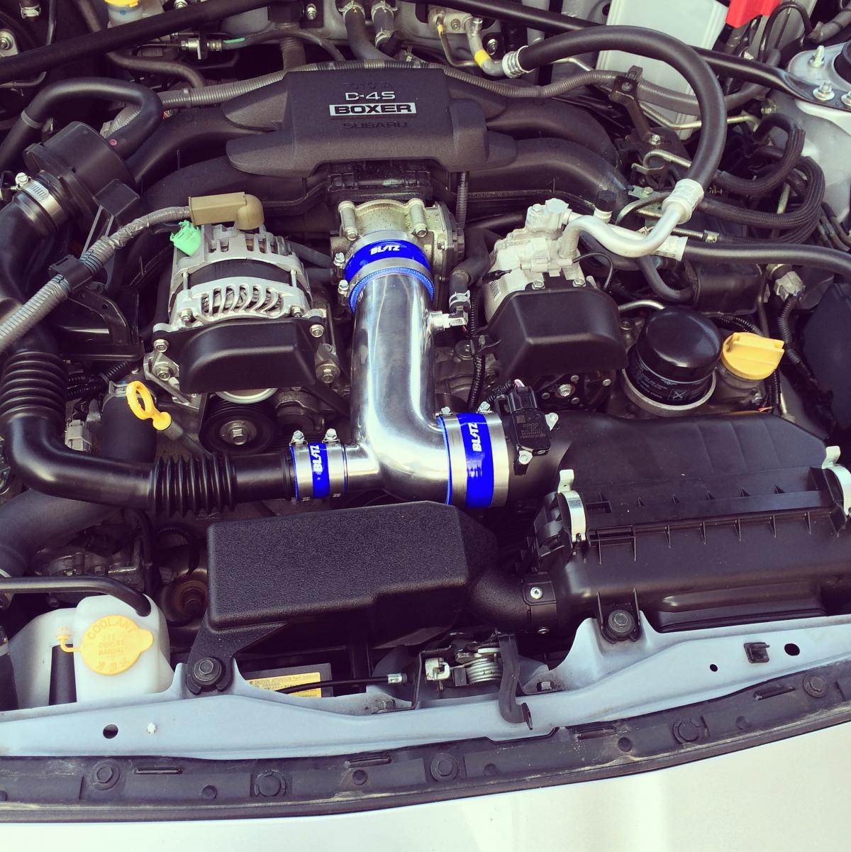

Kodename47 446 Report post Posted February 11, 2015 James, put the big resonator back in. It's there for a reason, it helps with torque at certain revs. 1 HowardMet reacted to this Share this post Link to post Share on other sites
JamesP1991 222 Report post Posted February 11, 2015 James, put the big resonator back in. It's there for a reason, it helps with torque at certain revs. Cheers for the heads up KnightRyder, I thought it was a Helmholtz resonator that was there to just stop certain frequencies of sound?? The TRD Griffon car was running the setup I chose with the stock airbox (see below) I thought given those guys are not running the resonator box attached to the airbox in a car of that magnitude then it can't be that beneficial in terms of performance.. however I could be wrong! 1 HowardMet reacted to this Share this post Link to post Share on other sites
Guest Report post Posted February 11, 2015 You could indeed be wrong James?? No one will know except for you.. if you feel a big drop in torque somewhere, put it back on and see if your torque comes back.. Be carefulk of copying Race Cars though.. they dont always have the best mods for your daily driver Share this post Link to post Share on other sites
JamesP1991 222 Report post Posted February 11, 2015 You could indeed be wrong James?? No one will know except for you.. if you feel a big drop in torque somewhere, put it back on and see if your torque comes back.. Be carefulk of copying Race Cars though.. they dont always have the best mods for your daily driver To be honest, the car is a weekend toy at the moment so I haven't had the seat time recently to offer a conclusive opinion. With the UEL Borla header and a decat front pipe fitted now I feel more in the mid range torque wise anyway at this point. Will test it perhaps this weekend and see if there is any difference in higher gear, lower Rev pulls Torque is obviously sparse with this engine so I'd hate to be throwing away any I did have originally haha! 1 HowardMet reacted to this Share this post Link to post Share on other sites
Kodename47 446 Report post Posted February 11, 2015 Cosworth engineers told me that it's there for low down torque, I have tried it on and off and you do notice the difference in daily driving and I put mine back on. Obviously a track car won't need it as it's only at WOT and that's why the Griffon had it deleted. 1 HowardMet reacted to this Share this post Link to post Share on other sites
JamesP1991 222 Report post Posted February 11, 2015 Cosworth engineers told me that it's there for low down torque, I have tried it on and off and you do notice the difference in daily driving and I put mine back on. Obviously a track car won't need it as it's only at WOT and that's why the Griffon had it deleted. Thank you for the insight Knightryder, will unseal the hole and put the resonator box back on at the weekend then just a shame really as it does clog the engine bay up some what! I am guessing the smaller ones on the intake pipe and also the ones on the intake duct can be removed though? 1 HowardMet reacted to this Share this post Link to post Share on other sites

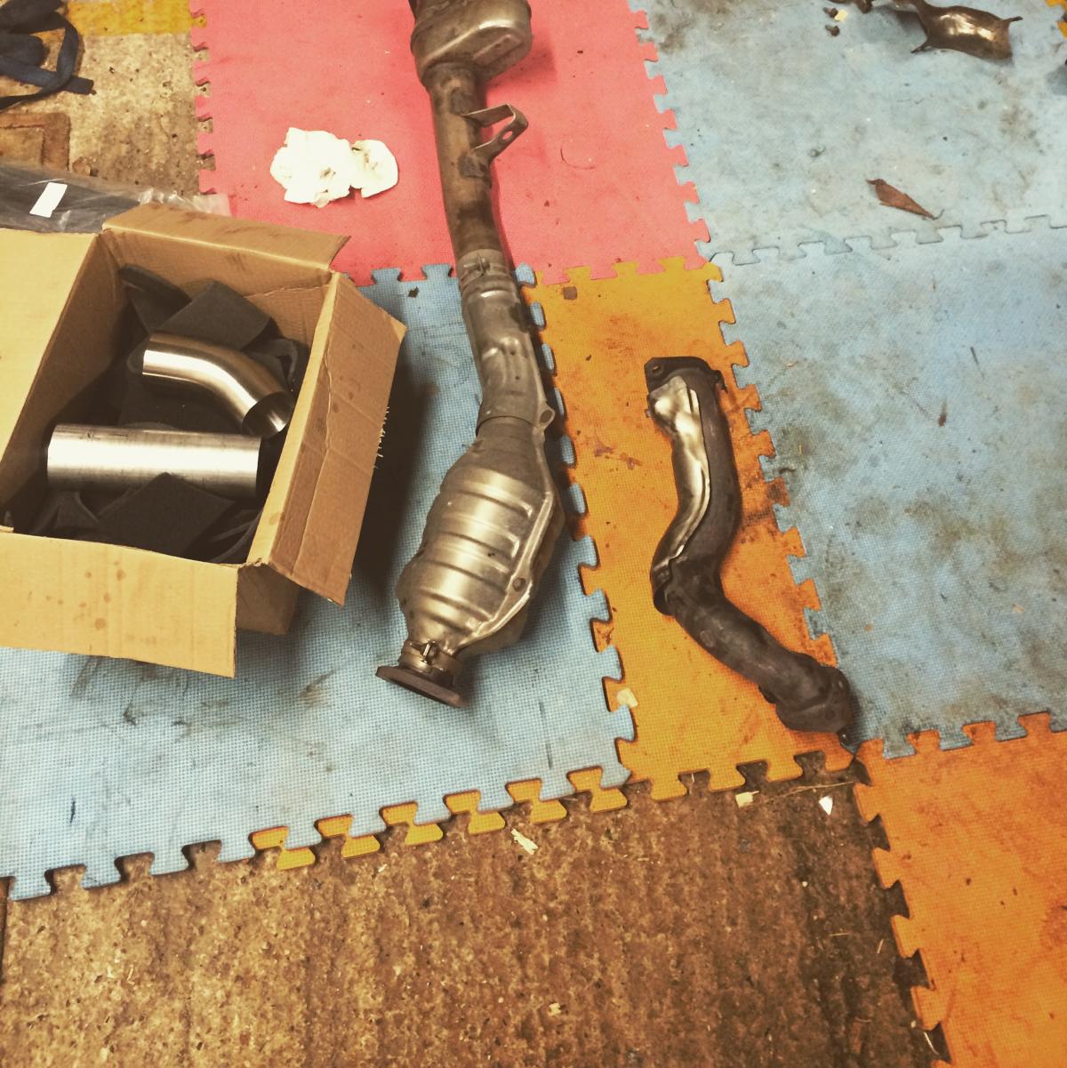

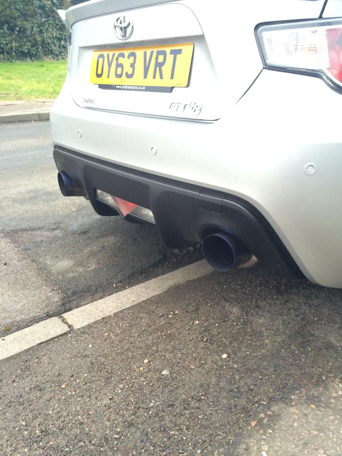

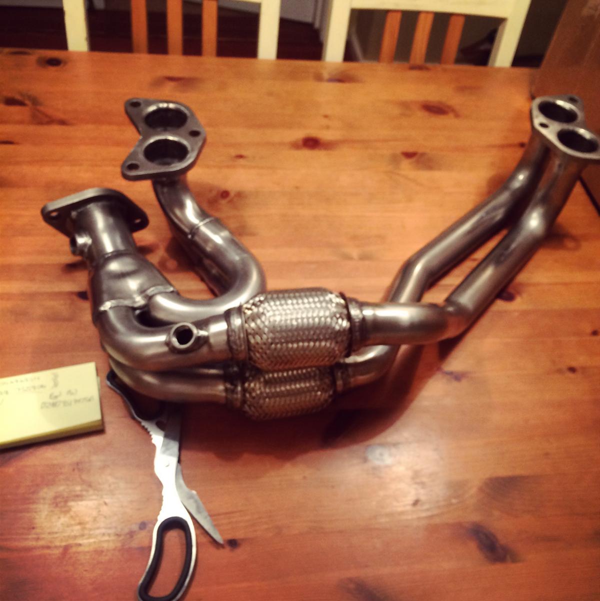

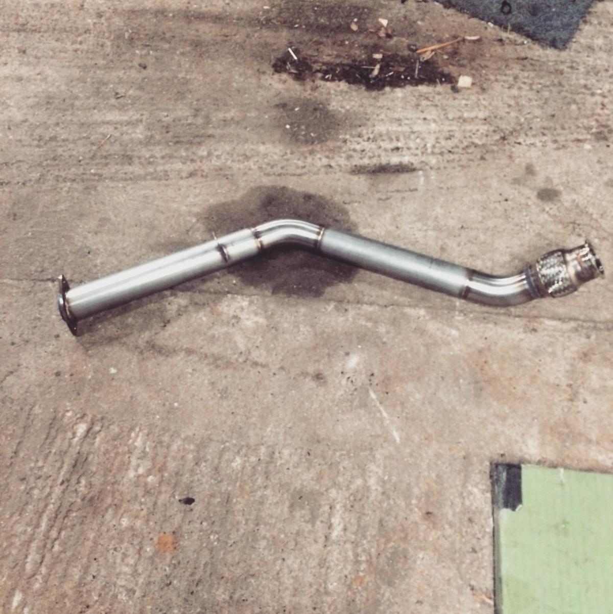

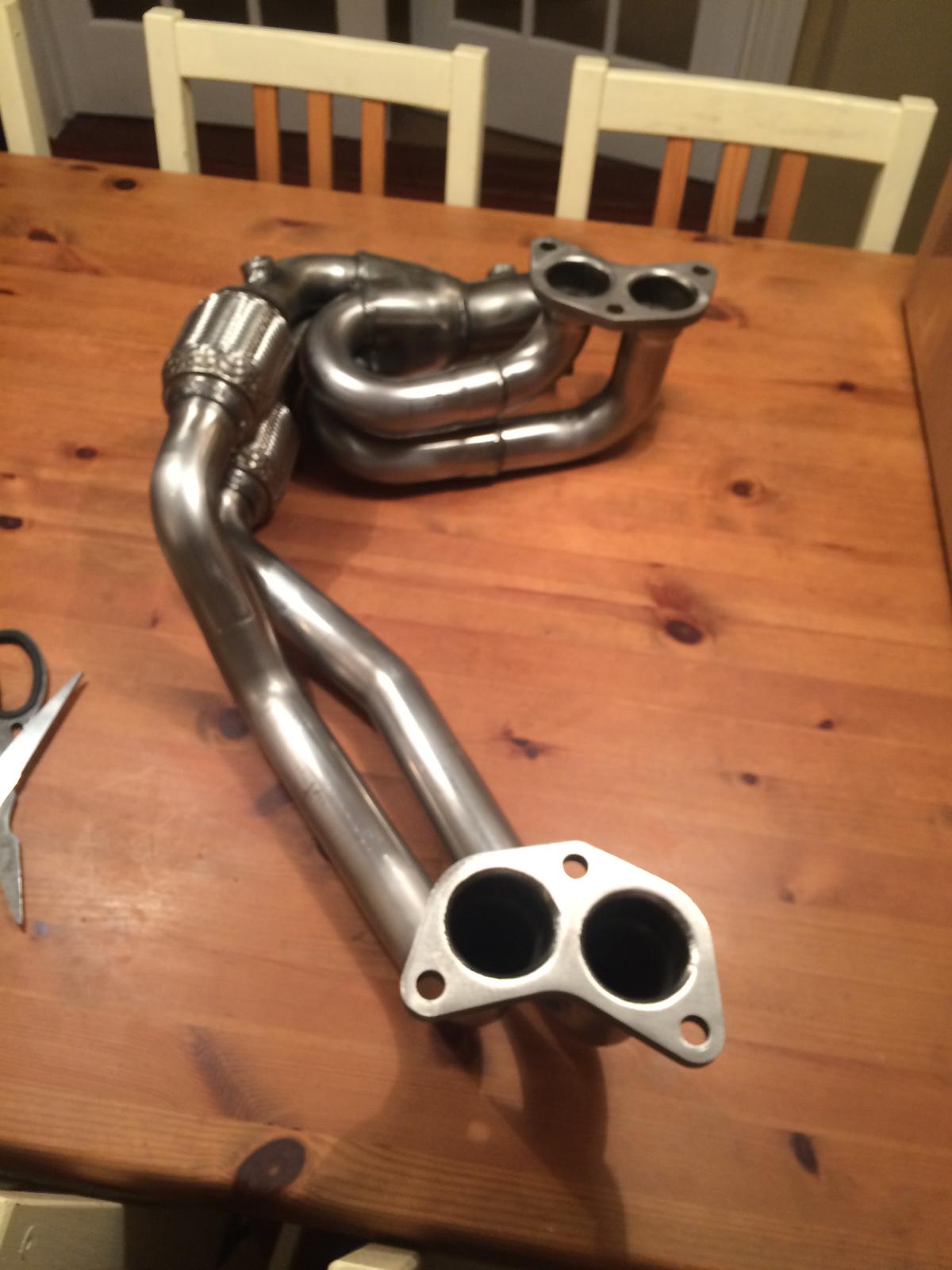

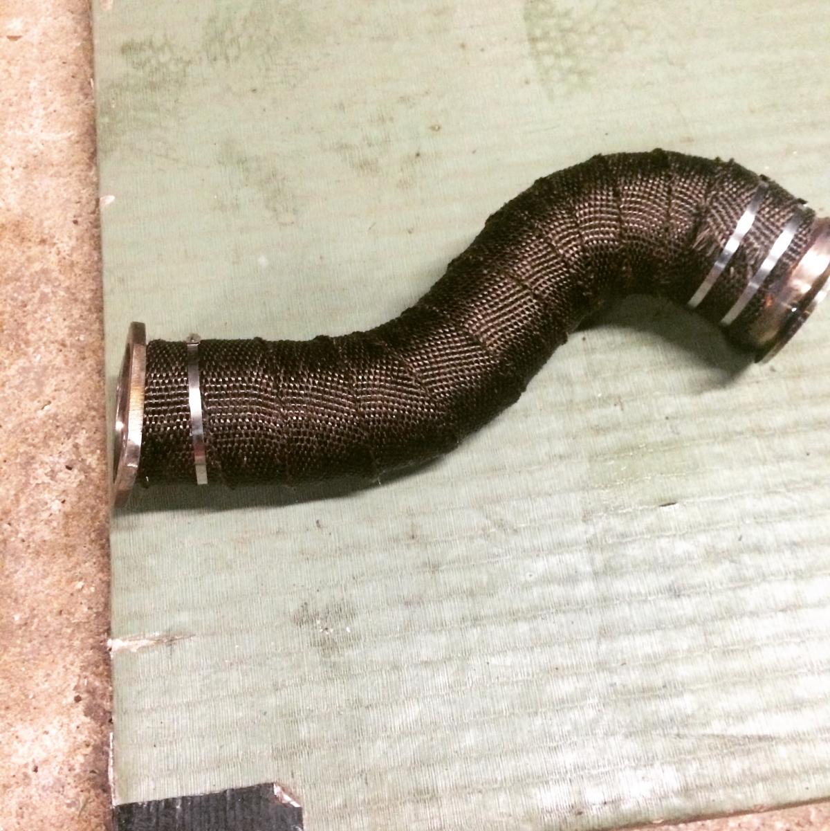

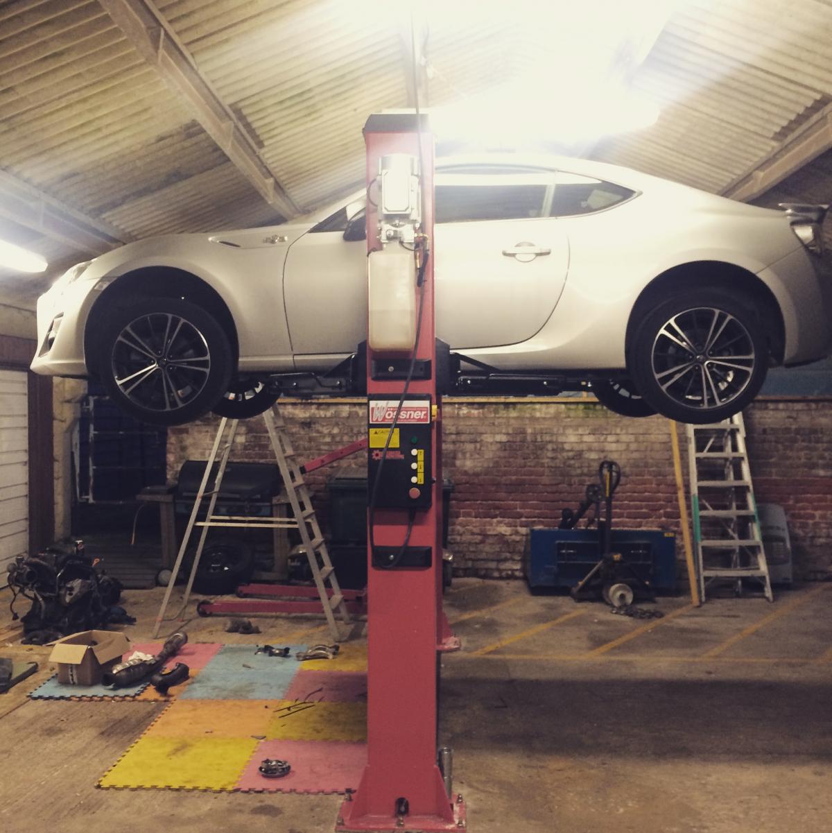

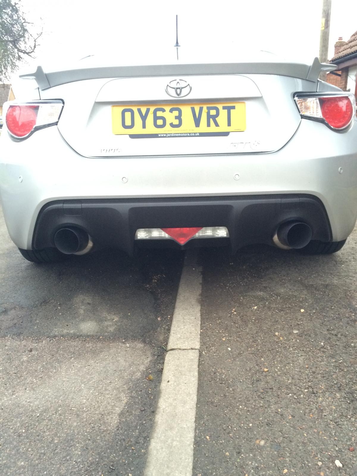

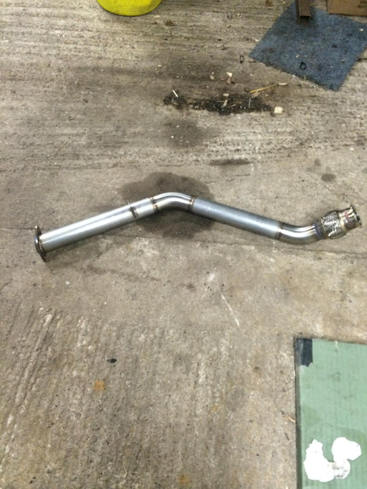

JamesP1991 222 Report post Posted February 12, 2015 So today I thought I would focus on the second area of the car I really wanted to change which was the exhaust. At the time, I didn't have the money for a proper catless header, so thought It would be better focusing on the downpipe/front pipe/catback combination first off. The initial two things I looked for when choosing my catback was value for money and also noise. I felt many of the UK based systems such as Milltek and Supersprint were hugely expensive, especially when comparing them to some of the US based catbacks at the time. I also wanted the system to sound quite aggressive and also possess a fair amount of bass, rather than create that "tin" sound. After speaking with Chris from Tarmac Sportz, I finally settled on an Invidia N1 exhaust with the blue singed titanium tips, which is over 11 lbs lighter than the stock system, was a reasonable £650 and also sounded the part from many videos I had watched. It arrived promptly from the postie: I had it fitted at a garage I knew, as at the time I didn't have the bits at home to properly get underneath the car. After fitting I was thoroughly pleased with the result, and thought the blue tips looked great: 2 Keethos and HowardMet reacted to this Share this post Link to post Share on other sites
JamesP1991 222 Report post Posted February 12, 2015 After the catback had been installed, I wanted to free up the exhaust flow and start deleting the restrictive cats that were in the stock exhaust setup (primary in the header and also the second cat in the front pipe). How I went about this was rather different to how I initially planned. My initial thinking was to go and buy a catless Invidia front pipe and then connect it to a Cobra or Berk overpipe. However one evening I went to go and see a friend of mine who is an extremely talented fabricator, and modifies his own S3 (500hp) and Seat Ibiza Cupra (430hp). He said he would love to work on mine and expand his skillset (having never worked on an 86 before). I agreed and arranged a day for the car to be dropped off. He measured every part of the fitment process to create a totally custom 2.5" straight through front pipe and overpipe combo to connect to my Invidia N1 catback. After a couple of weeks he contacted me and said it was all ready so I went down to see how it all looked! Both the components looked incredible, with the overpipe even being wrapped in titanium for heat shielding, and would be connected via a V band to the front pipe. Custom brackets were also used to ensure the fitment was perfect. Here are a few pictures from the day.... Up on the lift ready to go: Overpipe taken off: Start of the catback where the custom front pipe would join: Stock Overpipe and Front Pipe off: New Custom Overpipe (titanium wrap): New Custom Front Pipe: As you can see, the difference is incredible and I was thrilled with how she sounded afterwards. The fitment was great and I haven't had any problems since. You do not realise how restrictive the stock components are until you take them off and compare directly with the new parts just before fitting. Overall I was a very happy chap On a side note, did anyone else notice when they fitted their aftermarket overpipes how tight the fitting is over the sub frame where it joins the header? It took us quite a while to find a way it would sit nicely. 2 Keethos and HowardMet reacted to this Share this post Link to post Share on other sites
JamesP1991 222 Report post Posted February 16, 2015 Been absent for the past few days as apparently there was an important date over the weekend which I had to give my total commitment to?! After listening to KnightRyder's advice, over the weekend I have put the large resonator back on the airbox to claim back some torque low down that I have been obviously missing! But any way, back to the car and what direction I took next just before Christmas. Above I mentioned that I thought only a few aesthetic (and mechanical) changes were needed to make the car perfect in my eyes. To be honest I hated the way the stock car sat in terms of stance. The wheels were engulfed in the arches and the whole body sat way too high for my liking. Now the most logical choice would be to go a for a nice set of coilovers, which I could adjust to get the car to my liking. However at the time, I didn't have the money to throw into a set of top quality coilovers. So I dug a bit deeper and thought that some great quality springs, shocks and an aggressive realignment could get me to where I want to be, at a much cheaper option. I want to do a couple of trackdays over the next 18 months, and thought whilst I would not have the adjustability, the direction I would take would make the car at least half decent on the track when I did venture out there as well as the road. So to begin with I went for a lovely set of 25mm Luxury Master High Tech TEIN Springs that I purchased from Fensport just before Christmas. This would give me that more aggressive "squat" image I wanted with the car: 1 HowardMet reacted to this Share this post Link to post Share on other sites

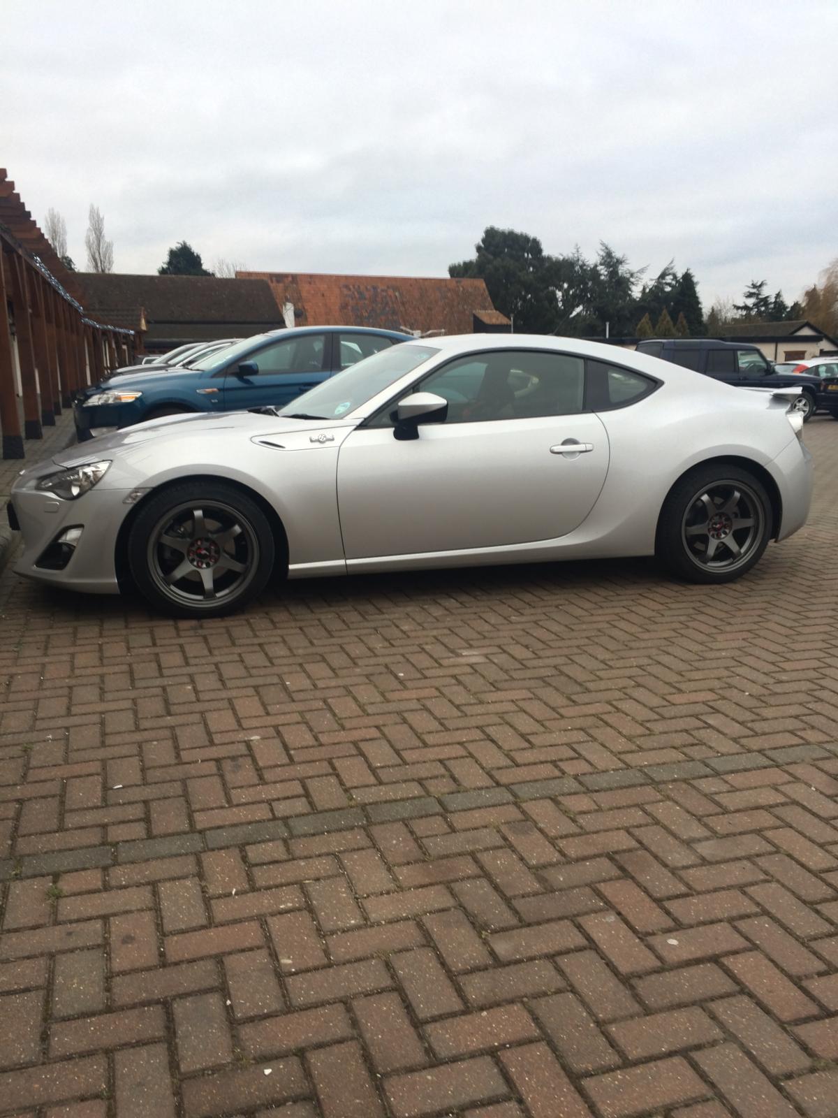

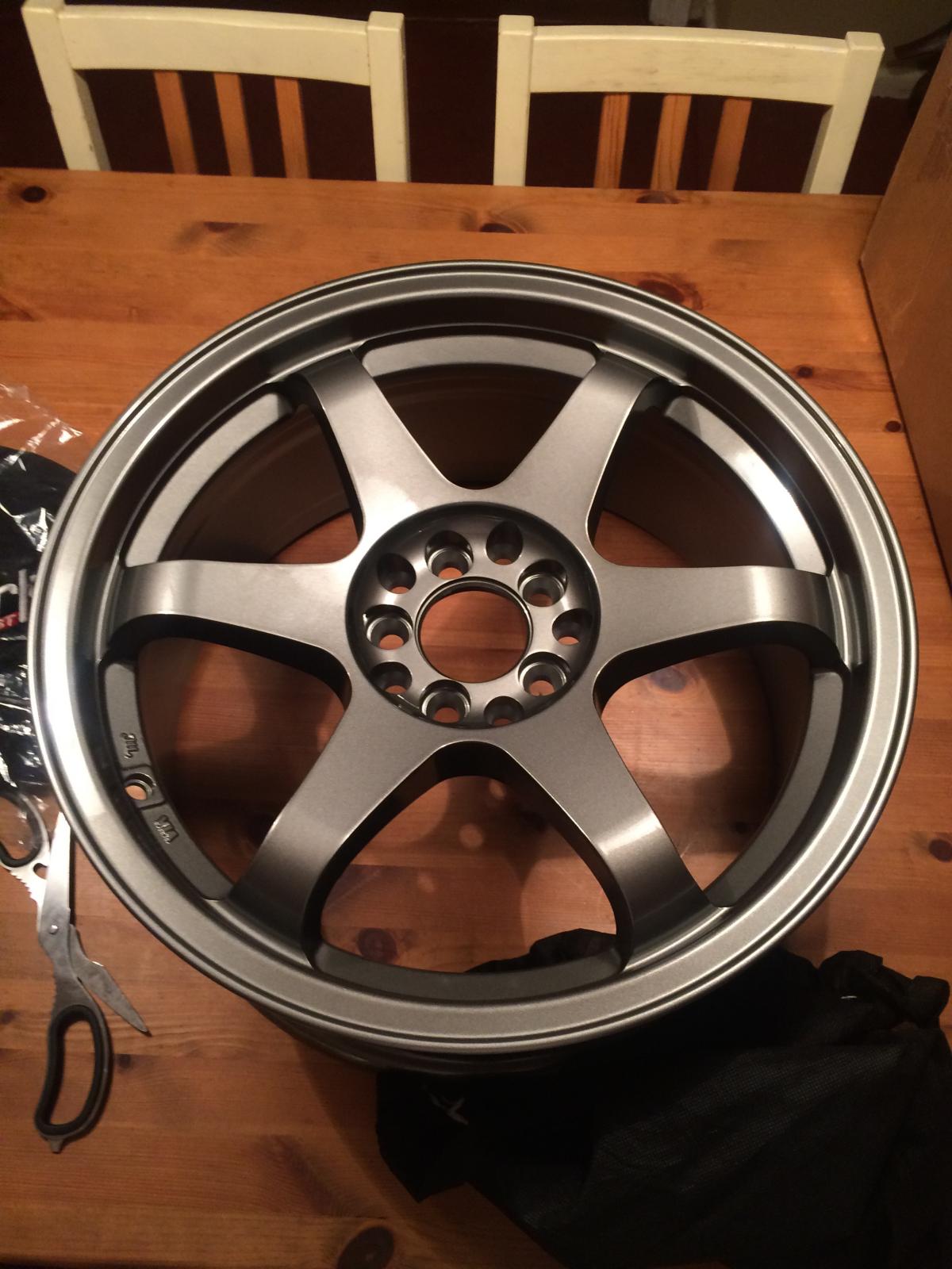

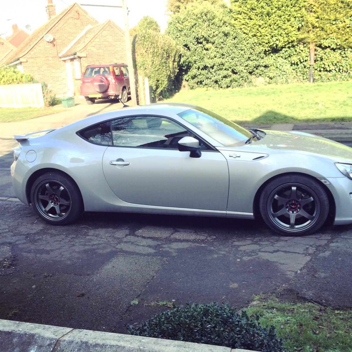

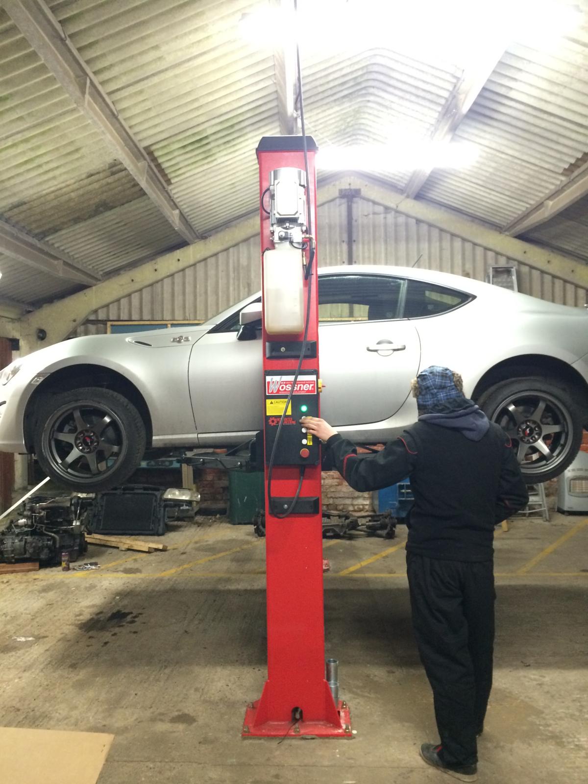

JamesP1991 222 Report post Posted February 16, 2015 Once the springs were fitted (sorry forgot to take pictures of fitting process) I then thought alongside some Valenti lights (which will come further down the line this year) that to complete the look, only wheels were needed. At the time I was speaking to Chris from Tarmac Sportz about ordering a Borla UEL header, when I thought I would ask the question in regards to what wheels he had available. He delightfully told me that a new range of Japan Racing Wheels were coming to the website and I had the choice between the multispoke JR11's or Rota Grid esque style JR3's. Now the inner JDM in me was instantly drawn towards the JR3's and when I enquired about the price I was pleasantly surprised. I didn't want to go too wide, and thought that 17" would give me some retained ride comfort on the road whilst still being more aggressive than the stock wheels. After some playing around with images, I settled on 17 by 8's with a 35 offest, which would still allow me to go larger in regards to tyres (225 section) when I could afford it. I managed to get them for £500 for the set (not including fitting kit or spigot rings)! Having a silver car with the red and black interior combination, I thought the likes of black and gunmetal wheels would suit best. Since the black ones were out of stock at the time, I went with gunmetal, and open ended red nuts which after fitting ended up being a great decision. After payment was made they swiftly arrived! By the time the weekend arrived it was finally time for fitting and here was the finished result: By the time the wheels were fitted, the TEIN springs had finally settled and the car looked far more aggressive than stock at last! The open ended red nuts finished off the look nicely against the backdrop of the gunmetal coloured wheels in my opinion too. A picture when the car was stock for comparison: 2 Keethos and HowardMet reacted to this Share this post Link to post Share on other sites
JamesP1991 222 Report post Posted March 2, 2015 Been away for a little while as I am currently waiting for the right amount of pennies for an Ecutek remap. Knowing I have my service and tax to pay for in May as well as Japfest to attend, I thought I would take March out to save some money and then book it in for April. At which point I will also probably get a few cosmetic bits. But one thing I did forget to post about in this build thread which I have put on last ready for a remap is the Borla UEL manifold. Now I know a lot of people were having problems with them when they first come out. The quality was fairly ropey at best. However Borla redesigned the header and brought a second version out, a much better quality design and still at a respectable price point. Now I always wanted to go UEL as I love a good boxer burble, and with options in the UK limited I turned to Chris at Tarmac Sportz again. The reason was that, if Supersprint or Cosworth thought I was going to pay £1200 or £1500 respectively for just an exhaust manifold alone I was going to walk away instantly. Chris, after telling the me the redesigned second version Borla unit was a lot better, and was a reasonable £600 I thought I would bite the bullet and go for it whilst I was purchasing my wheels. Now the Borla header is very popular with members on FT86club and there is ample amounts of video footage to hear how it sounds. So I thought why not and went for it. This would mean my exhaust would be completely catless, relatively light (Borla header being only 4.5kgs) and produce a fairly god like sound. It arrived together with my wheels and I was super excited to get it bolted on. I promptly contacted my friend Stuart, who not only fabricated my entire custom exhaust, but also had a two post lift that I could borrow to get it fitted! I fired her up shortly after fitting and I instantly fell in love! Whenever I drive her (which is not that often unfortunately) I literally have the biggest smile on my face wherever I go. Not only that though, but some other guys on the road have stopped me at lights or at a petrol station and told me how great she sounds, I even gave one guy a drive round the block because he wanted to hear what she sounded like at full chat. A deep burble below 3.5k which then changes to a scream all the way up to the redline, I just cannot wait to get the car mapped now in April and unleash all that lovely exhaust flow properly! 2 Keethos and HowardMet reacted to this Share this post Link to post Share on other sites
Lauren 2259 Report post Posted March 2, 2015 Nice, looks like you went with running the stock tyres on 8" rims. I do the same with my 8" TE37's. I actually like the little bit of stretch as it keeps the sidewalls stiff which makes the car more responsive. 1 HowardMet reacted to this Share this post Link to post Share on other sites
JamesP1991 222 Report post Posted March 4, 2015 Nice, looks like you went with running the stock tyres on 8" rims. I do the same with my 8" TE37's. I actually like the little bit of stretch as it keeps the sidewalls stiff which makes the car more responsive. I did for the time being Lauren, my long term goals were to save up and buy a nice set of 225 section Conti Sport tyres to bolt on. This would coincide with the Primacy's finally giving up, but the tyre compound is so hard I expect they will last longer than I will on this planet haha! Saying that though, the car is really progressive on the limit at the moment, even with a bit of stretch on the tyre. Out of tight corners you can shift the weight accordingly with your right foot and decide how much fun you want to have! 1 HowardMet reacted to this Share this post Link to post Share on other sites
