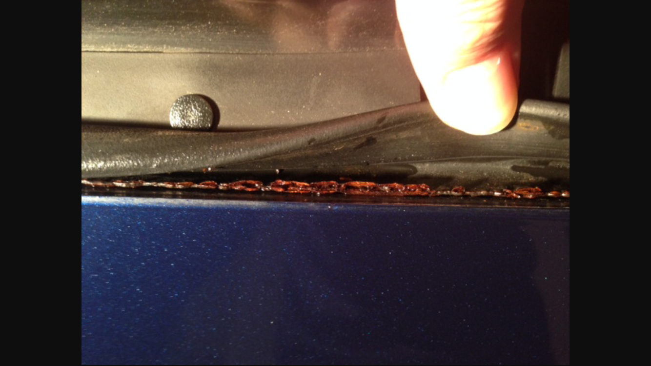

Gary p 46 Report post Posted August 2, 2017 Don't know if any one else has spotted this issue but a poor design in the metal plate where rubber weather strip sits holds water and rusts the metal work. This picture isn't my car but damage looks very similar. I've taken my car back to Toyota to claim on warranty. Awaiting verdict will let you know the outcome. 4 Foulsmell, Deacon, nerdstrike and 1 other reacted to this Share this post Link to post Share on other sites

Deacon 1357 Report post Posted August 2, 2017 14 minutes ago, Gary p said: Don't know if any one else has spotted this issue but a poor design in the metal plate where rubber weather strip sits holds water and rusts the metal work. This picture isn't my car but damage looks very similar. I've taken my car back to Toyota to claim on warranty. Awaiting verdict will let you know the outcome. I don't have my car to look at and am failing to picture where that is under the bonnet? Share this post Link to post Share on other sites
Cerastes 204 Report post Posted August 2, 2017 I think it's right at the front, where the rubber sill is. Where you would reach under to undo the bonnet latch. 2 Gary p and Deacon reacted to this Share this post Link to post Share on other sites
Gary p 46 Report post Posted August 2, 2017 @DeaconYeah it's the rubber sill that sits at the front between bonnet and front bumper👍 1 Deacon reacted to this Share this post Link to post Share on other sites

Gary p 46 Report post Posted August 3, 2017 Just had a call from Toyota they claim that this comes under paint work which is only covered by a 3 year warranty 🤔. But as I get on really well with my Toyota dealer they are going to sort this out for me👍. But all who have the same problem and under 3years old would recommend to get it sorted before the 3 years are up. 1 cropzy reacted to this Share this post Link to post Share on other sites
Gary p 46 Report post Posted August 8, 2017 May have good news Had toyota contact me again today to say they can replace the metal piece that the rubber sill sits on so it's not a bodge repair. At least this part can be replaced which is a good thing👍👍👍 1 cropzy reacted to this Share this post Link to post Share on other sites

Lauren 2259 Report post Posted August 8, 2017 I haven't looked at the bit under the rubber, but look at mine from a random pic I took on Sunday: GT86 Rusty bonnet trim by Lauren Blighton, on Flickr 1 Gary p reacted to this Share this post Link to post Share on other sites
GT86-Ian 351 Report post Posted August 8, 2017 I took mine off a few years back removed the rust & painted it myself. 1 Gary p reacted to this Share this post Link to post Share on other sites

Cerastes 204 Report post Posted August 12, 2017 Just cleaned mine and thought I would check. Car hasn't even done 17000 miles yet, mine is '63 plate so my warranty has run out? rusty1 rusty2 rusty3 Share this post Link to post Share on other sites

Foulsmell 120 Report post Posted August 12, 2017 I'm sure they will replace it. It's not happened over night and if it's been serviced by Toyota they should have check for it. If they missed it then that's their fault. This will turn out on every 86 probably so will be a recognised design fault. 1 cropzy reacted to this Share this post Link to post Share on other sites
Gary p 46 Report post Posted August 14, 2017 Yeah toyota say that this problem comes under paintwork which is covered only by 3 year warranty. But in saying that they are replacing mine under good will and getting it done next week👍👍 Share this post Link to post Share on other sites
Cerastes 204 Report post Posted August 15, 2017 22 hours ago, Gary p said: Yeah toyota say that this problem comes under paintwork which is covered only by 3 year warranty. But in saying that they are replacing mine under good will and getting it done next week👍👍 What is it they are replacing exactly, I'm not even sure what that bit of metal is for. It doesn't seem to serve no function as far as I can see. Edit: Sorry never mind, I just read one of your earlier posts. I have sent a little polite email to my local Toyota dealers and see what they can do for me. 1 Gary p reacted to this Share this post Link to post Share on other sites
Captain Duff 79 Report post Posted August 26, 2017 I peeled the rubber back the other week when I first read this and couldn't spot anything, however having just got some engine bling bolts to replace the black painted ones in the front area that were looking tatty I took it off completely today for a clean underneath and yes, there was a fair bit of rust on the underside. Thankfully it sits on the plastic front nose/bumper (and serves to fasten that to the car) so the rust isn't going to affect anything else. I've cleaned and sprayed all over with ACF 50 so it at least shouldn't get any worse, although it was annoying finding it just after my 4 year service!. I'll have a look before the service next year to see if it looks like it needs replacing or not. 2 Foulsmell and Gary p reacted to this Share this post Link to post Share on other sites
