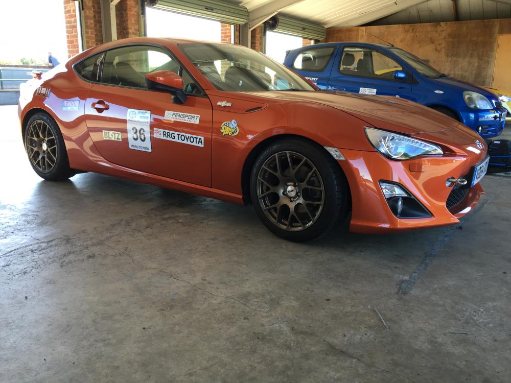

MikeB 79 Report post Posted September 27, 2016 7 hours ago, Varelco said: Thats right, your fitment will be flush to the wheel arch with that set up and you won't scrub, no spacers required. If you want to see what it will look like google our cars fitted with TSW wheels (such as their nurburgring or interlagos) they only offer a 5x100 fitment in 8" width ET35 offset. TSW 17 x 8 et35 with 225 17 yoko 105's with 20mm drop Share this post Link to post Share on other sites

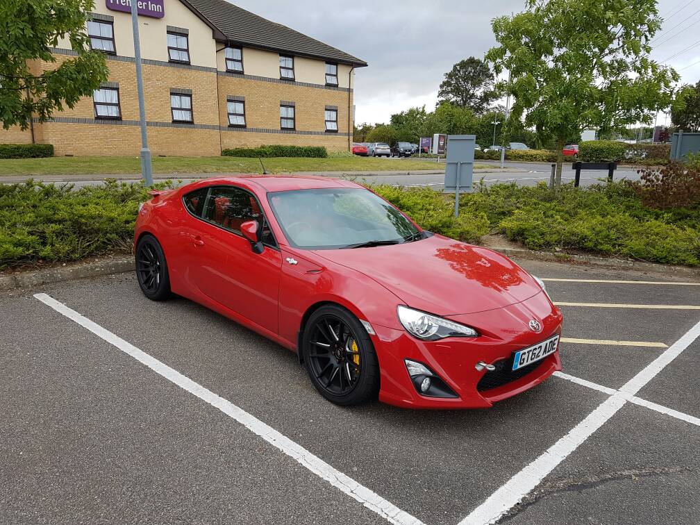

Ade 517 Report post Posted September 27, 2016 Mine. Lowered about 15-20mm on 18x9 et35 Share this post Link to post Share on other sites

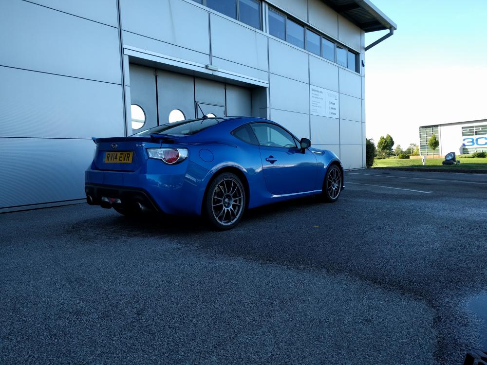

DanJ 374 Report post Posted September 27, 2016 I'm on 18x8 ET48 Ultraleggeras with 225/40 18s Share this post Link to post Share on other sites

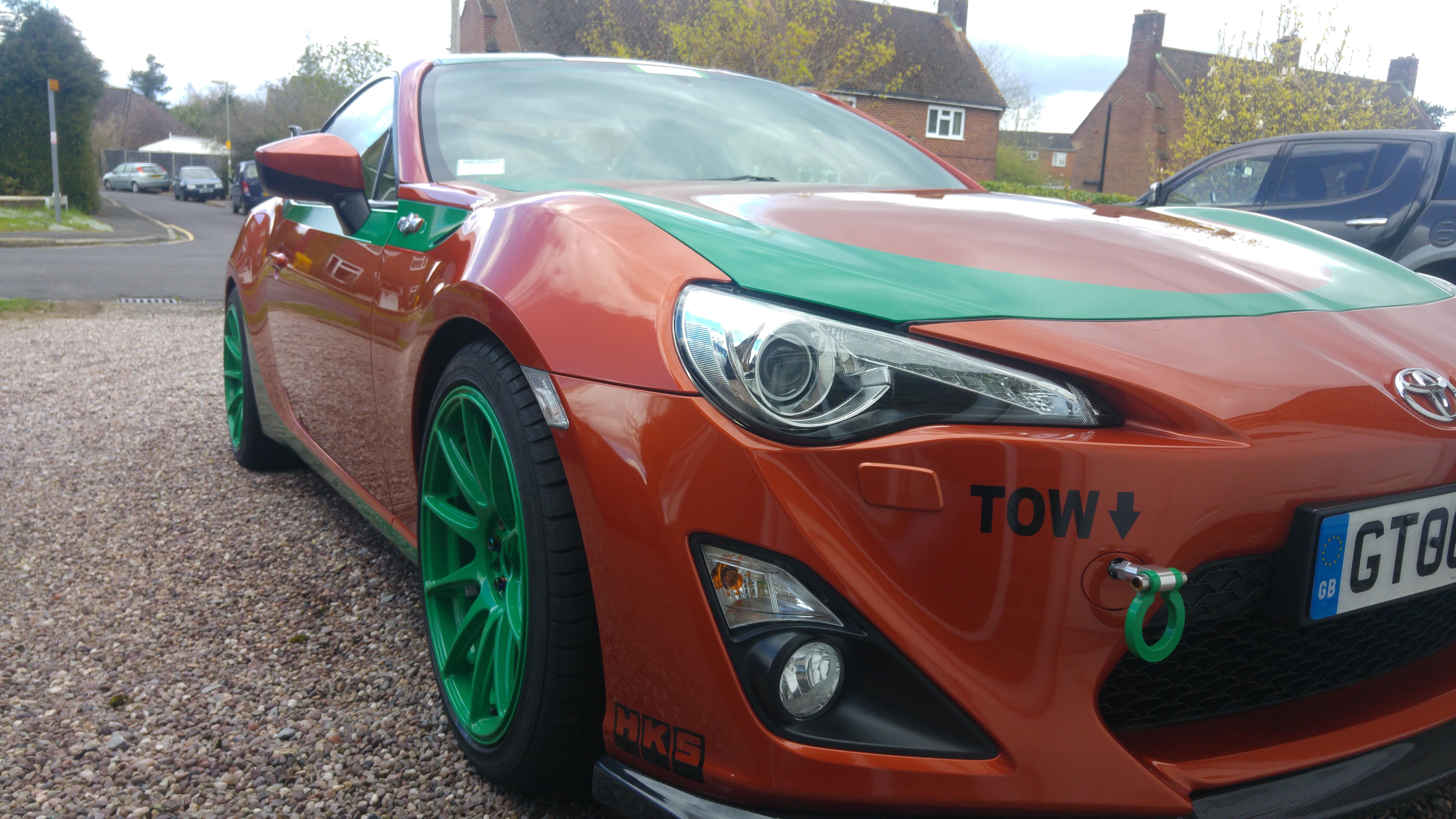

Varelco 211 Report post Posted September 29, 2016 I've lowered mine 25mm on Tein luxury masters and the ride quality hasn't really changed at all. Would highly recommend them. Coilovers are a waste of money if you are only looking to drop the car for cosmetic reasons Share this post Link to post Share on other sites

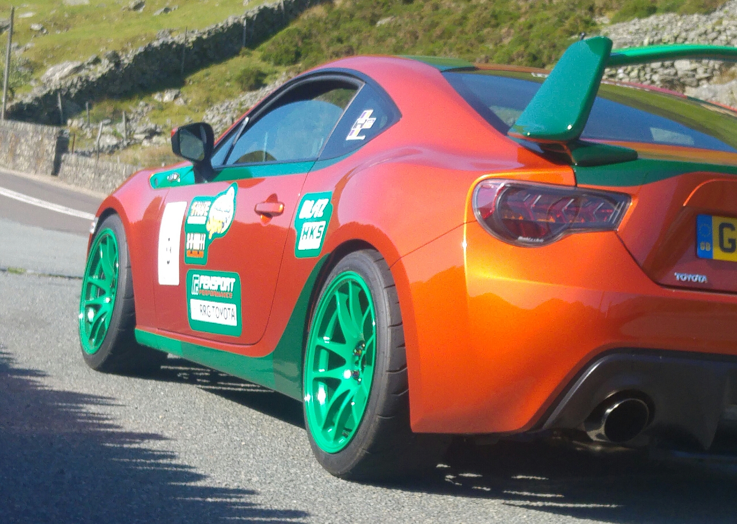

KevinA 695 Report post Posted September 29, 2016 1st one 18x9.5 et 35 2nd one 18x8.75 et35 car lowered 20mm Share this post Link to post Share on other sites
