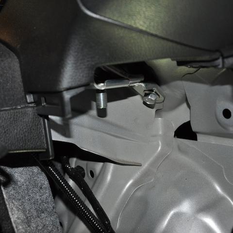

37 minutes ago, GraemeI said:I used the same mounting point as the one in @VAD17‘s pictures, but rather than fatigue the metal by bending it, I used the supplied longer bolt and spacer. It’s very solid as a mounting point
hth
Sounds like a solution to bending it then. Will make a decision when I do it. As long as the plastic trim isn't causing a bend in the strap, think it'll be bolting to the car.
I get that, but that bolt is what the belt reel is attached to so surely must be strong enough?
2 hours ago, maurice said:It's designed to be able to be bent. I wouldn't use that bracket.
Any specific reason why you wouldn't use it?
I might end up doing that as I don't know if the harness will foul the seat belt or not (if a spacer won't fit either) but using that bolt seems a cleaner install as there's no bending or twisting of the harness.
Just want to make sure I'm not missing anything as it must be strong enough as the load from the seat belt will go through the bracket before the car itself. Your pics are the only ones available of the actual mounting points, other than a number of Germans who have used the top isofix point which isn't strong enough.
Finally getting round to installing my harness and not overly comfortable with bending the metal connecting the rear strap to the pillar.
Is there a reason not to bolt it in between the actual seat belt reel and the bracket (using bolt in image below)? Seems a better place as its directly out towards the front seat then rather than coming down and being held in a bit by some plastic??
