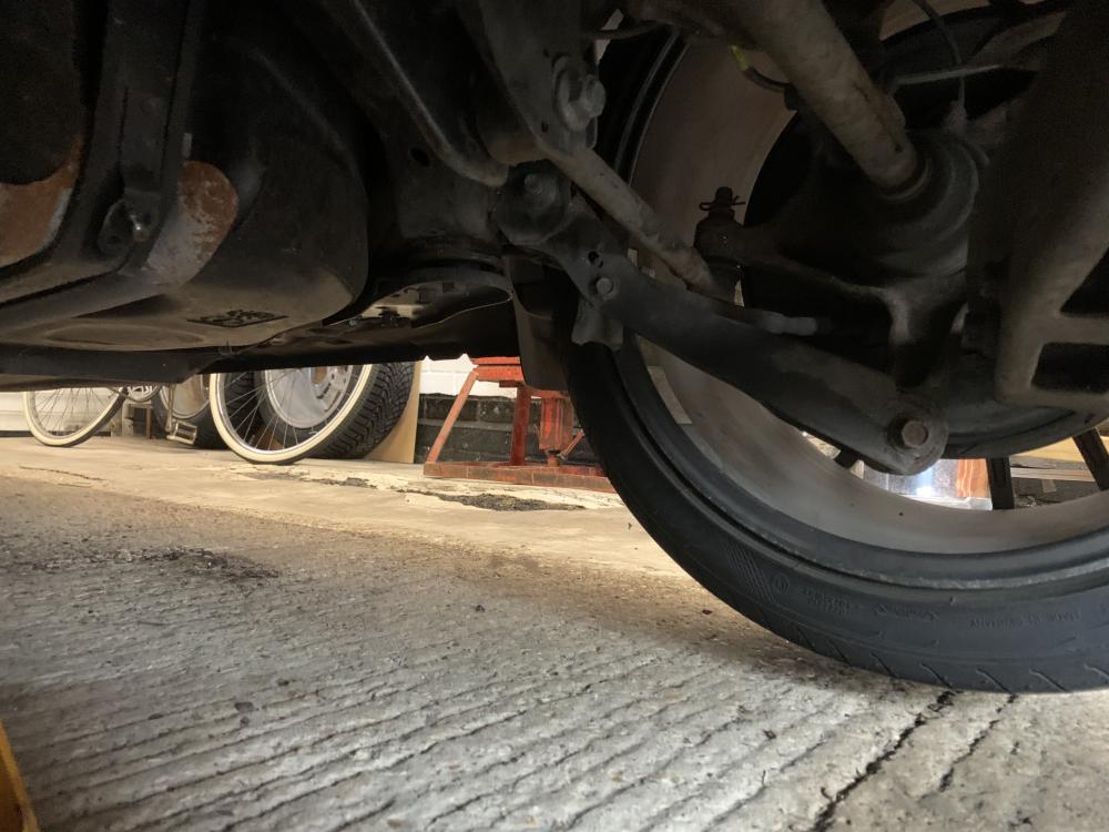

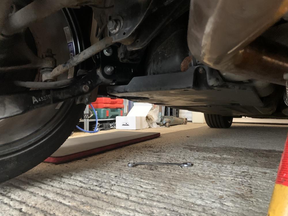

Went to fit it today. Its quite incredible the stock arm angle when the wheels are hanging.
You can see from the pictures the difference these mounts make. Once the weight of the car is back on the wheels the arm will be pretty much horizontal now.
