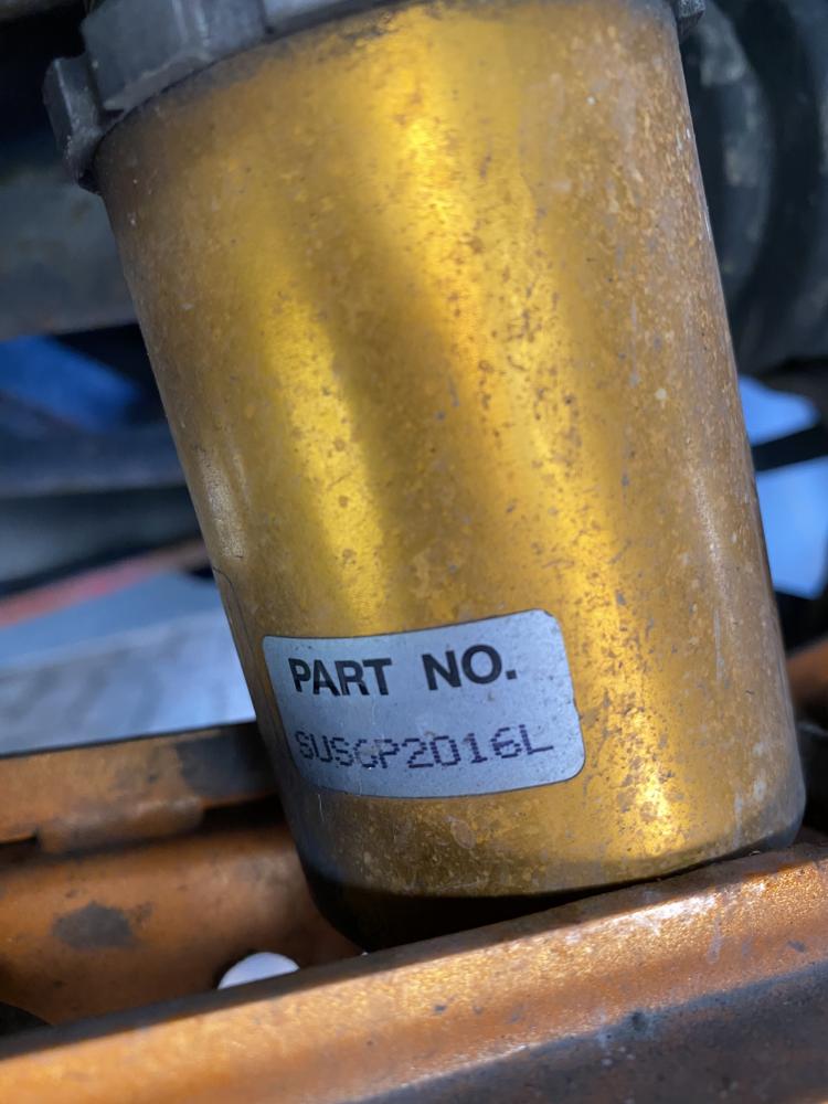

The one thing I’m not 100% sure of is that my rear socks from the MP20 kit have SUS6P2016L stamped on them and the manual for the MP21 kit only quotes the first part, SUS6P, however I’m not sure if the shock valving is different.
I would’ve thought it should be since the 5k setup should require more rebound damping and less bump damping vs the 3k damper.
Does anyone know for sure if Ohlins revised the rear damper valving MP20 to MP21?
Well, imho good adjustable shocks should be able to accommodate +/-30% spring rate change.
As for MP20/MP21, IIRC they are essentially same, just that MP21 is German TUV approved and has rubber spring seats. So if there are any damping changes, then imho they might be vs earlier, MI20 shocks with stock 60/60Nm springs and included Ohlins camberplates in set.
Hmm, that sticker .. i wonder if it's for shock itself, or just for that "cup" with threads for height adjustment and mounting hole to suspension arm .. if later, it might be from generic Ohlins parts-bin and to be in many kits (eg. for some other Subaru cars), and not linked what valving in shock "core" with shims used is.
