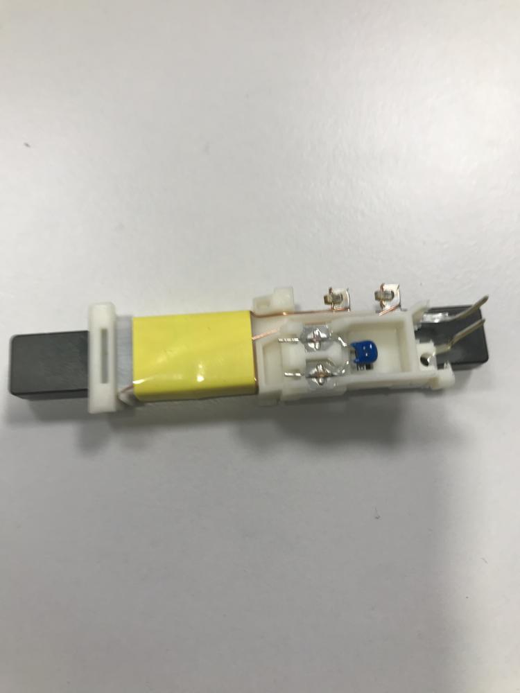

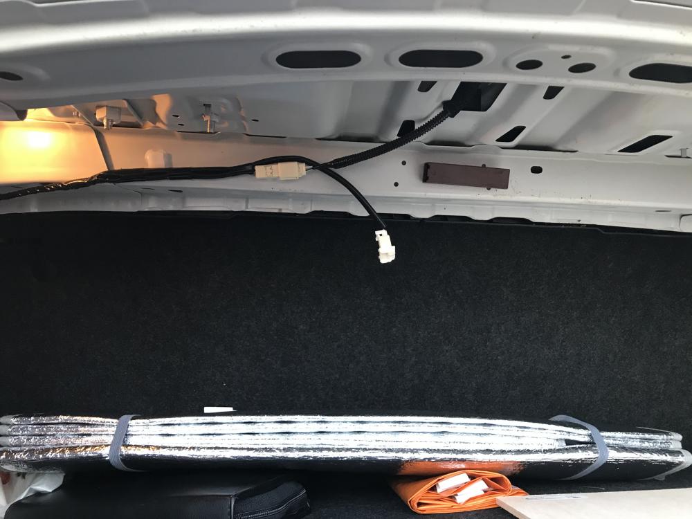

SlowSpeedDemon 1 Report post Posted January 15, 2020 I shoehorned a Christmas tree in the boot and ripped this part apart, as seen in the photos. It seems to be a solenoid of some sort housed in the brown enclosure placed on the boot/trunk arch, and connected by the dangling connector. What component is this and what purpose it serves? Thanks. Share this post Link to post Share on other sites
SlowSpeedDemon 1 Report post Posted January 15, 2020 Forgot to mention there is no apparent impact and I couldn’t notice a loss of functionality anywhere. The car is 2017 reg (67) and owned from new - the only option I didn’t take was the sound upgrade to JBLpro - so it is not the case that a previous owner tried to install some extras. Share this post Link to post Share on other sites

Conscript 45 Report post Posted January 15, 2020 1 hour ago, 86iain said: Is it the key sensor for the keyless entry? I think it's this. There is an identical box mounted behind the trim which holds the Start button. OP - are you still able to open the boot with the key in your pocket while the car is locked? Share this post Link to post Share on other sites
Jay 37 Report post Posted January 15, 2020 I can see a capacitor and a coil, which may form a resonant circuit, making a keyless entry detector rather plausible. Share this post Link to post Share on other sites

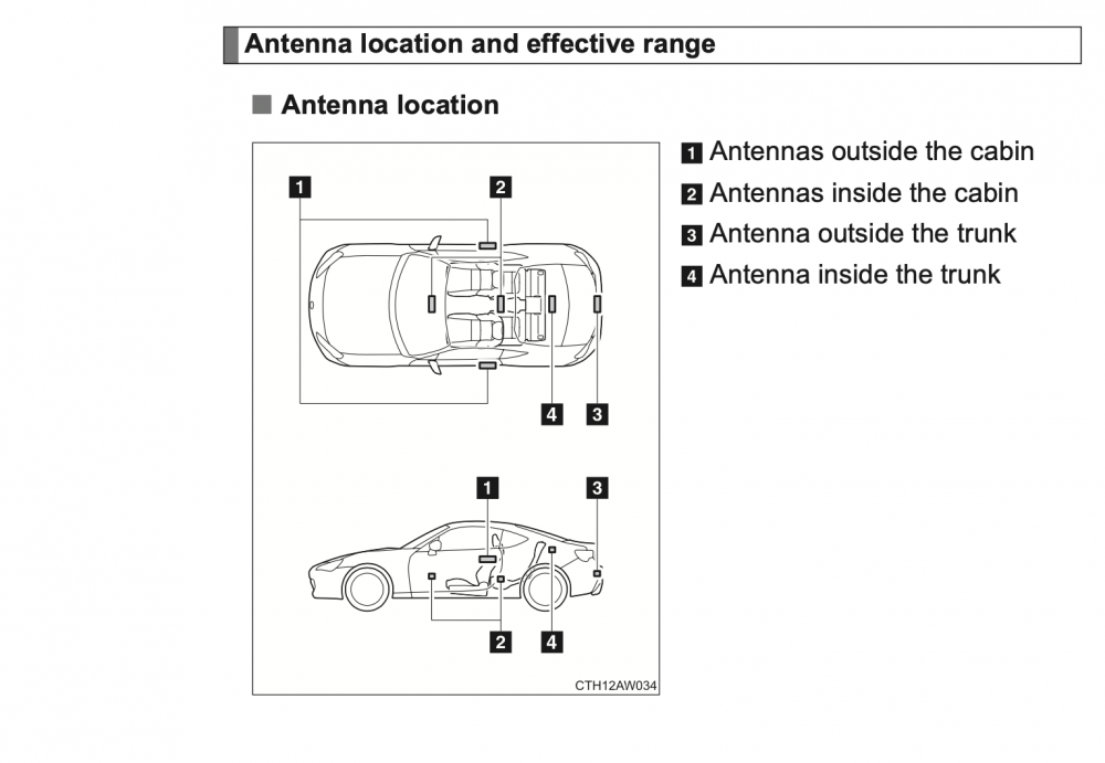

SlowSpeedDemon 1 Report post Posted January 16, 2020 Cade Bull, it is definitely antenna no 4 the one busted (figure from the car manual below), and I haven't seen any issue so far (yes the boot still unlocks when sensing the key in my pocket, but we know that is antenna no 3 which should work). I'll try to lock the key inside - but that in the evening when I'll have access to my spare key 🙂 1 Jay reacted to this Share this post Link to post Share on other sites
