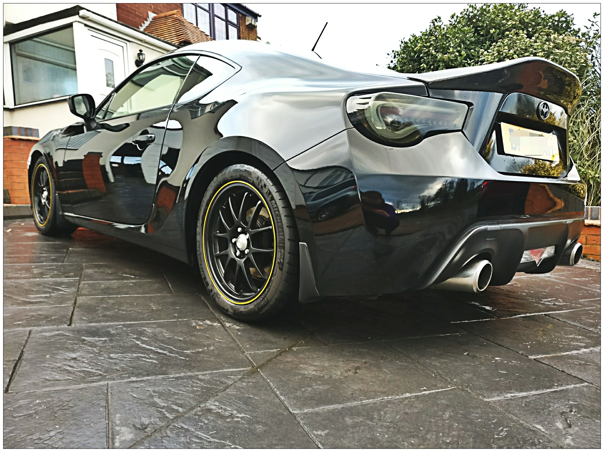

My current track wheels will be for sale soon. They're 17x7" et40. They're as very light at under 7kg a corner and they're shod with Michelin Cup 2's in 215/45/17. I haven't tried them over the AP BBK but if you were interested I'm sure I could arrange with @will300 to check the fitment?
It's these wheels below (Konig Daylite)
