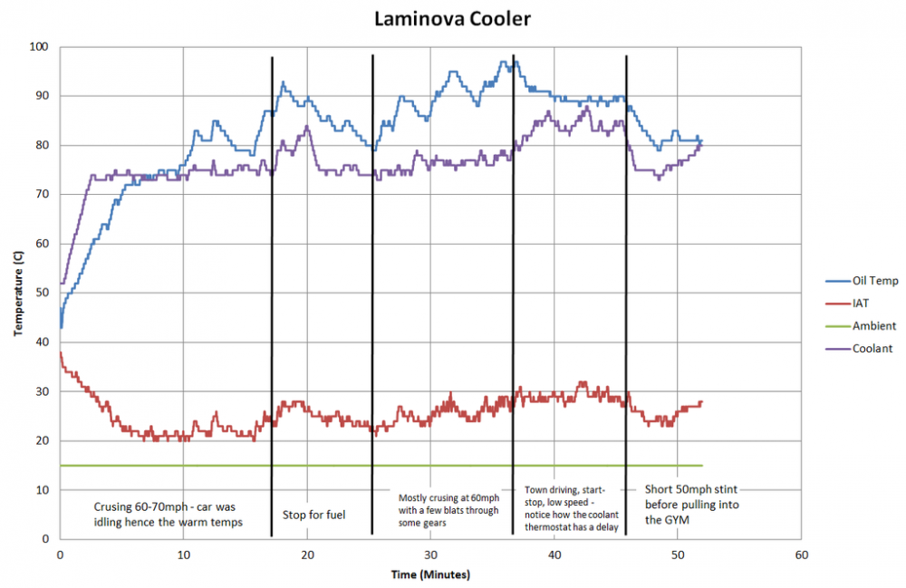

S18 RSG 429 Report post Posted March 16, 2017 Both @DanJ and @Ade run superchargers on track, so have collected a fair amount of data. They're running the Harrop and Cosworth respectively. Any setup will almost require an oil cooler for extended track use, but that's true of the standard car as much as it is with an FI application. I've not done any track time since December when I had my TD turbo fitted, mostly cause it's winter, but I've been able to run the car very hard on some Welsh B roads, and after an hour or so of passionate driving, my IAT's were only around 5 above ambient. The large FMIC on the TD setup should, in theory, aid with track abuse fairly well. One of my main areas to focus on when I get on the track is the intake pipe being so close to the hot downpipe. I'm tempted to wrap the intake pipe in some gold foil or similar to reflect the heat away from the intake air if it looks to be a problem come the warmer months. On the flip side of all that, I also daily my TD turbo car. I average 35mpg, and can easily see mid 40's on a run. What I miss out on compared to the supercharged applications is the immediate throttle response and low down torque, but comparing to a typical NA>Turbo conversion, this package is a lot closer to an OEM turbo than anything I've tried before. Almost no lag, boost builds from around 2500rpm with max boost coming in around 3k. That means the car drives quite similarly to stock, where you have to rev it to get the best out of it, you just don't have to rev it so high. My only good experience with supercharging was with the Harrop setup @DanJ has (although I've never tried a Cosworth, but they are very similar I understand). It was very impressive. Whereas the turbo application feels like an FI car, the Harrop felt like you dropped a 350Z engine in a GT86. Bags of low down torque in any gear, but very little drama. Only way you could really tell you were going faster was by watching the speedo. Really all depends on what you want specifically, as although the end results are similar, the delivery and drivability have some differences. Share this post Link to post Share on other sites

Ade 517 Report post Posted March 16, 2017 @alucardo you are doing the right thing to choose a kit with test data. There are many kits that cannot stand up to repeated lapping of a circuit. I've done a few trackdays with @DanJ and can happily say both Harrop and Cosworth kits running stock boost are more than capable of running continuously are the track in high ambient temperatures and keeping intake temperatures down. I would recommend an oil cooler, though Dan (and others) just back off when they hit 130C after 10 minutes or so. This is not a bad idea as oil coolers are another failure point in the system and loss of oil pressure can be catastrophic, but if like me you are keen to be able to stay out 20mins+ and oil cooler is not a bad idea, but choose wisely and again look for test data. Here's a couple of sessions from different track days i've done in my Cosworth SC' car. and road driving Share this post Link to post Share on other sites

Paul 442 Report post Posted March 16, 2017 6 minutes ago, Ade said: I would recommend an oil cooler, though Dan (and others) just back off when they hit 130C after 10 minutes or so. This is not a bad idea as oil coolers are another failure point in the system and loss of oil pressure can be catastrophic, but if like me you are keen to be able to stay out 20mins+ and oil cooler is not a bad idea, but choose wisely and again look for test data. @AdeYeah you couldn't get enough of the sight of my taillights round Snetterton.... Share this post Link to post Share on other sites
