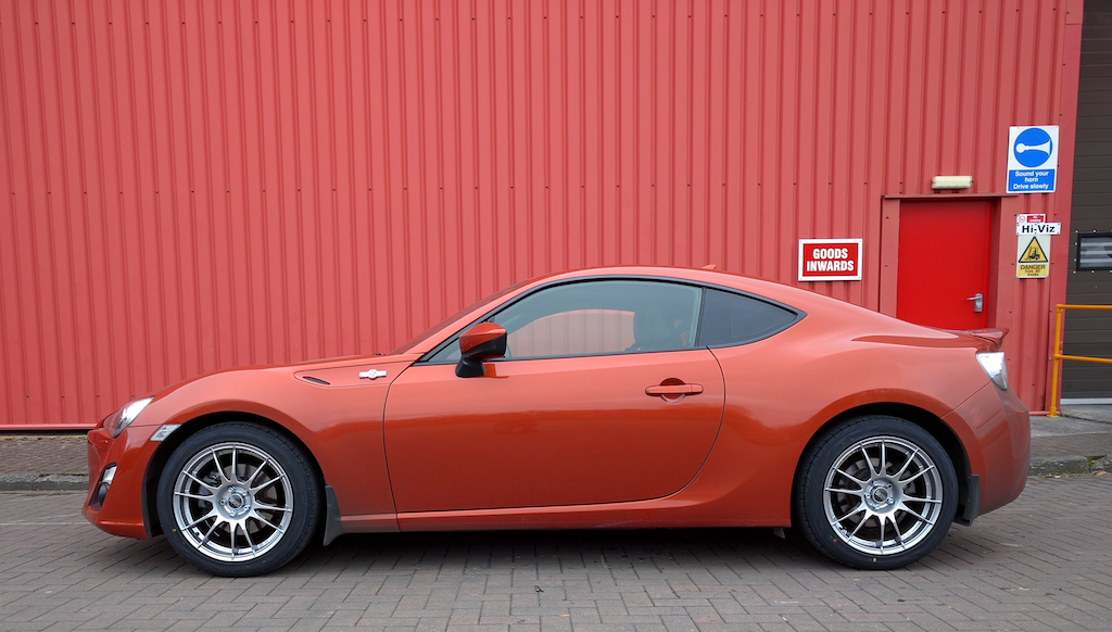

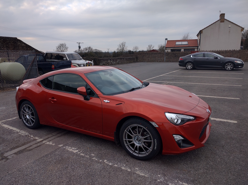

long-gone 152 Report post Posted March 20, 2016 Went for the Yokohama: 4 Rich, Keethos, MangoNo5 and 1 other reacted to this Share this post Link to post Share on other sites
long-gone 152 Report post Posted March 21, 2016 Got the white pen out later... hehe 2 MangoNo5 and Keethos reacted to this Share this post Link to post Share on other sites
