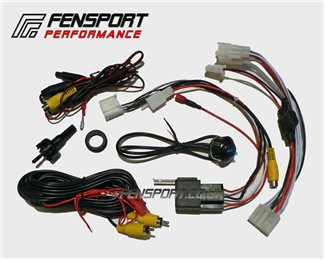

Test Drives Unlimited 278 Report post Posted July 30, 2015 Well I would like to thank Fensport for fitting my New Reversing Camera yesterday This was the first time that they had ever fitted such a Kit to the GT86/BRZ and now that they know how to fit such a Kit,they will be offering this service to other Customers A couple of Photos Post below : 1 Keethos reacted to this Share this post Link to post Share on other sites

ABs_GT 6 Report post Posted January 4, 2017 Install links and images for Fensport Rear View Camera Kit I've been looking for ages for easy install instructions as my Fensport Kit didn't come with any and everyone online seems to have a different kit with and without harnesses. So here are a few links to videos I used when installing mine. Not all of every video is relevant, but at least all the links are in one place here. 1. Check Head Unit receives signal when reverse is engaged. Both my brother's and my cars had this already working. Follow this video to access the service menu of the HU. In "General" (I think - have a play - you'll find it) you'll see reverse as "No". Engage reverse (engine doesn't have to be on) and this will change to yes. GREAT!! If this doesn't happen for you, two of the videos below show how to add one wire to inform the HU when reverse is engaged. Ok so the video doesnt show English headings, but it's essentially the 'navigation volume'...also I think it's more the rate of taps and not the actual number...not sure...but it's easy enough to access. 2. HU removal and plugging harness into HU - note these videos show tapping etc but the Fensport kit didn't any The video above I found really useful as he installs the exact same camera harness as Fensport into a set up with SatNav, so if you've already got Sat Nav OEM fitted, it's a useful heads up. 3.Video and PDF guide of principles of wiring through boot/trim & cutting hole for camera http://carboncarsystems.com.au/files/gt86-reverse-cam.pdf 3 Keethos, Philip and Squadrone Rosso reacted to this Share this post Link to post Share on other sites
