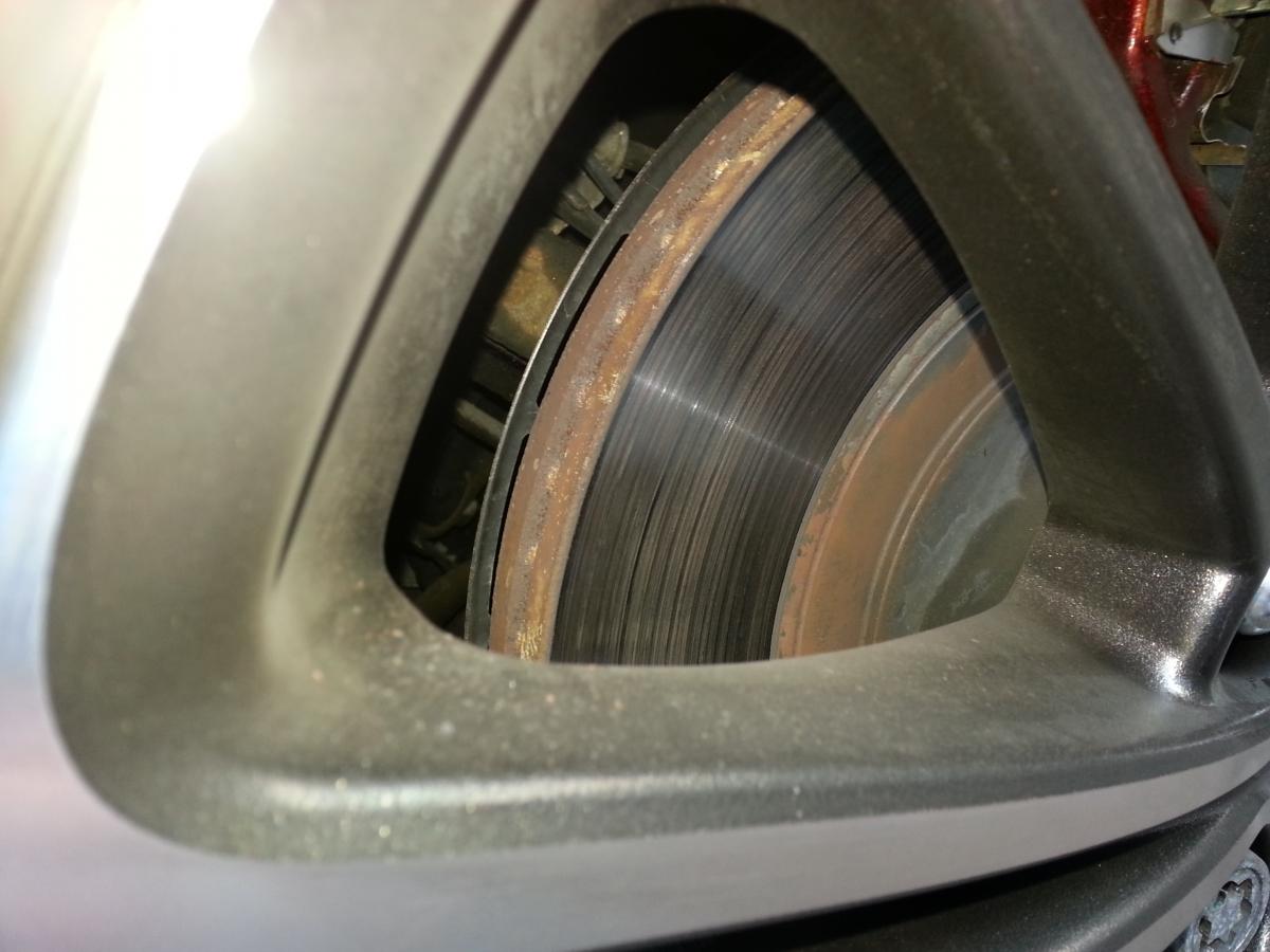

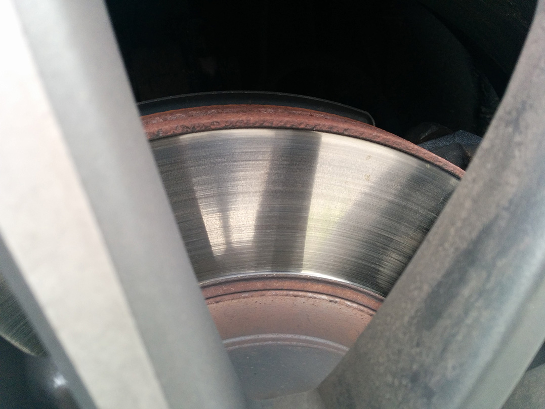

Mike 458 Report post Posted June 2, 2015 How obvious would the compound be on the discs? They look like they have always done to me, not that I've actually looked at them much! Mike-p looked at them and said they looked clean and so did Rich... Share this post Link to post Share on other sites
Ade 517 Report post Posted June 2, 2015 Sometimes you get ribbing. If you run your finger nail over the surface of the disc, you'll feel tiny ribs. They should look like a nicely bedded in set of discs of ther than that. Pads are designed to transfer some pads material onto the disc. The problem is when they get too hot, they transfer too much compound in an unevenly. Here's a pic on mine when they were badly juddering: Share this post Link to post Share on other sites

Mike 458 Report post Posted June 2, 2015 Can't feel anything on the discs at all. Attached a pic of the right one, left one was covered in some crap from the rain this morning >.< So, what I'm getting from this thread (and the others on here), it seems to be basically personal preference? Share this post Link to post Share on other sites

Ade 517 Report post Posted June 2, 2015 P.s. Mike that disc surface looks lovely but are they quite worn? Might be worth checking the thickness of the disc. Share this post Link to post Share on other sites
