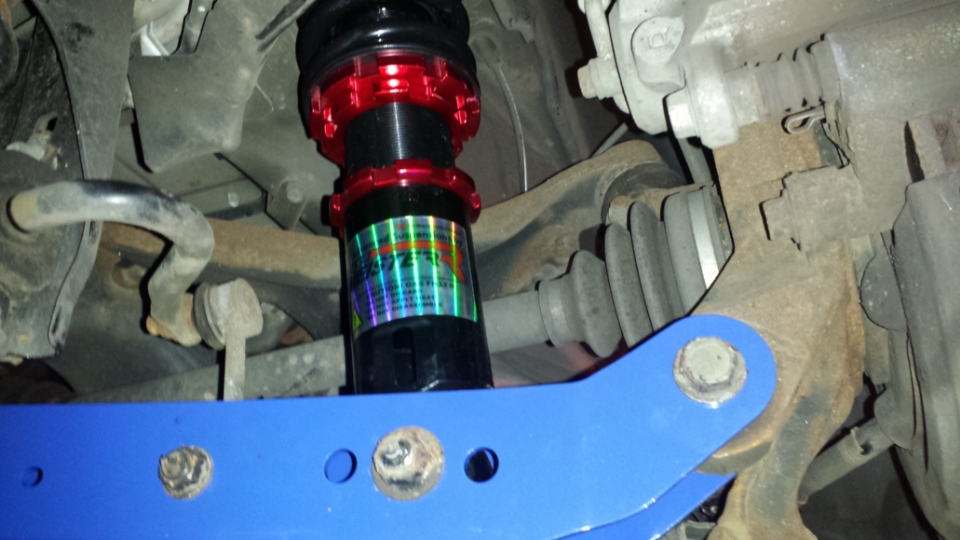

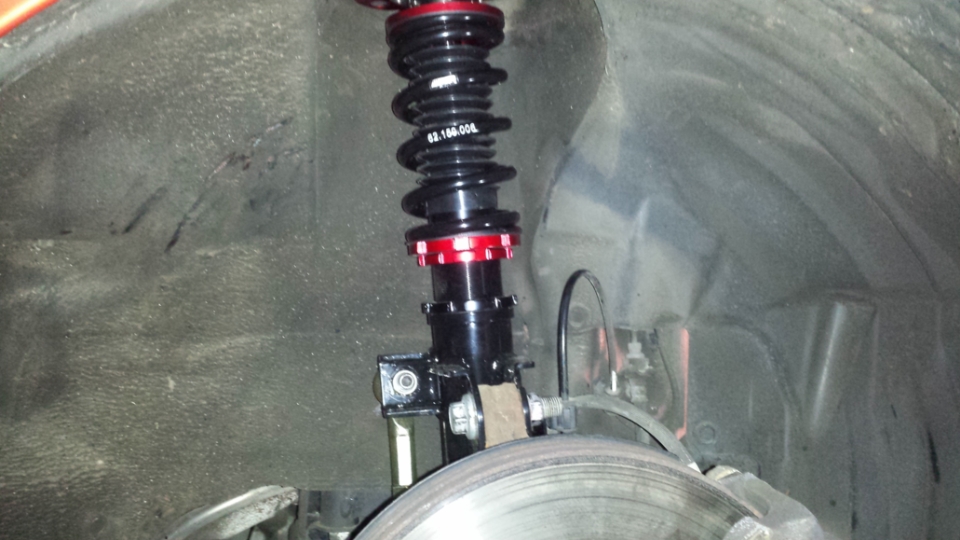

KevinA 695 Report post Posted July 24, 2014 Started the fit complete with new lower arms and toe rod arms for total adjustment, been off the spanners for a while so probably wreck my nail polish lol Will post some pictures later Kev Share this post Link to post Share on other sites
KevinA 695 Report post Posted July 24, 2014 Job done, fitted complete with the lower control arms and adjustable toe rods. Will be on the alignment rig early next week, be good to hear any set up numbers from you guys. Kev 1 Keethos reacted to this Share this post Link to post Share on other sites

smudge 1020 Report post Posted July 25, 2014 What arms and rods did you go for Kevin? Share this post Link to post Share on other sites

KevinA 695 Report post Posted July 25, 2014 Smudge the lower control arms and adjustable toe rods are from Japspeed, arrived promptly and good quality. Lauren after conversations with the guys at Meister ( who it turns out I know ) I decided on 6 and 6 with the choice of swapping with no issues at all. The ride is very good, with the dampers on minimum setting it's pretty much stock and you dial it up from there. Very impressed so far but will give feedback as time goes on. Kev Share this post Link to post Share on other sites

KevinA 695 Report post Posted July 26, 2014 hi kev did you change all this with car on floor not on a ramp any think of note to watch out for? All on the floor in a single garage, needed help a few times but the the OH popped in and lent over me to hold bolts now and then ( also distracting ) The worst bit by far is undoing the front drop links, go tight loose back and forward all the way to the end, this stops you getting into trouble. Very pleased with the Meister Coilovers for fit etc.... Share this post Link to post Share on other sites
GT86Jay 202 Report post Posted July 26, 2014 Nice! I also have the Meister R coilvoers and have never had any prolems! Share this post Link to post Share on other sites
KevinA 695 Report post Posted July 27, 2014 Well first test of feeling for the suspension today, I drove the 86 on some small b roads to where I keep my horse. The road is bumpy and twisty with some undulations etc.. the ride is not hard or crashy, best description would be firm but not bouncy. Alignment is being done early this week and the acid test will be in 7 days when we are driving to and touring Scotland, should be varying roads and conditions for both coilover and tyre reviews. 1 Keethos reacted to this Share this post Link to post Share on other sites
