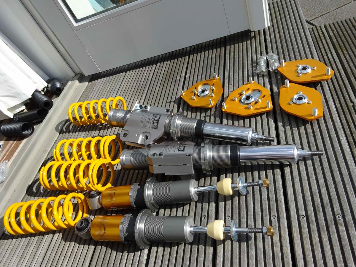

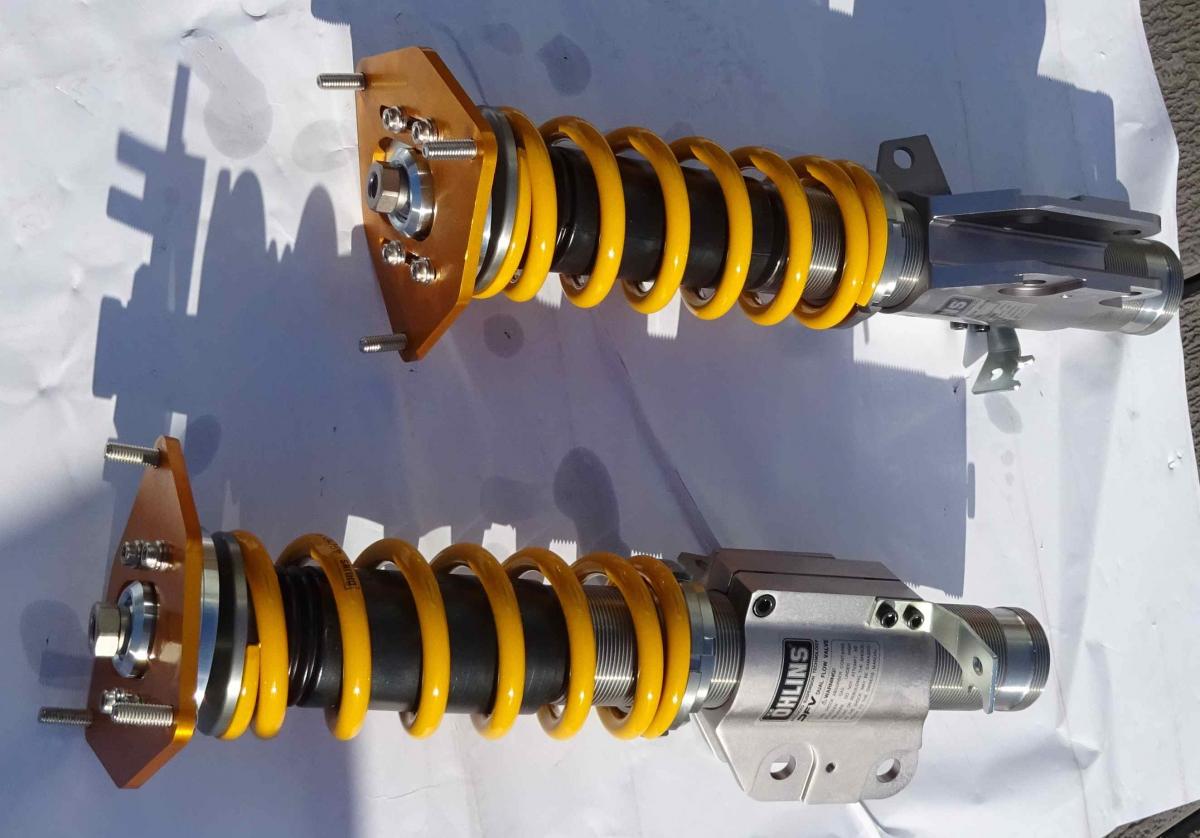

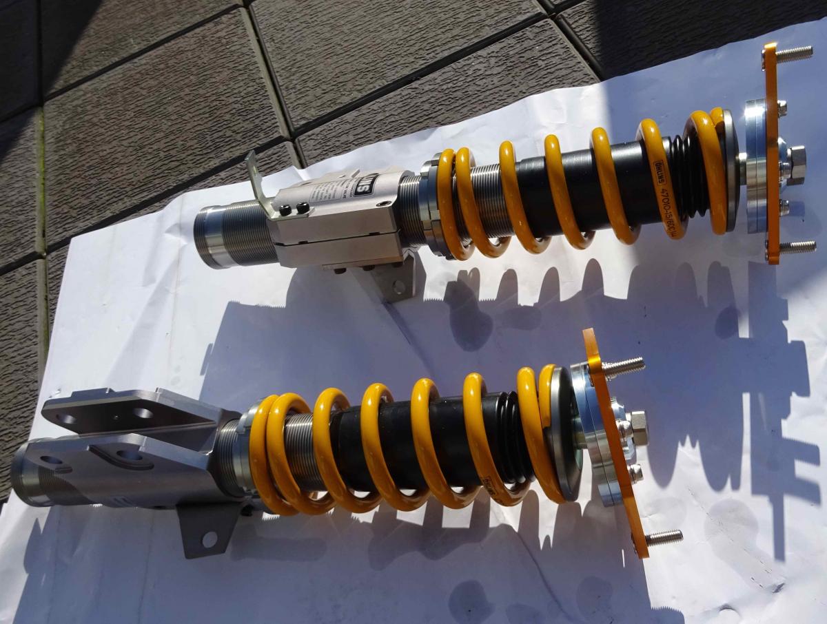

Stephen seems to want longer travel dampers. The GT86 has short stroke dampers, so there is no way in getting more travel really. Unless he spent £4K and upwards for some serious kit that will require rebuilding on occasion, like Ohlins, AST etc. Those dampers won't necessarily have any more travel but are much higher quality.
