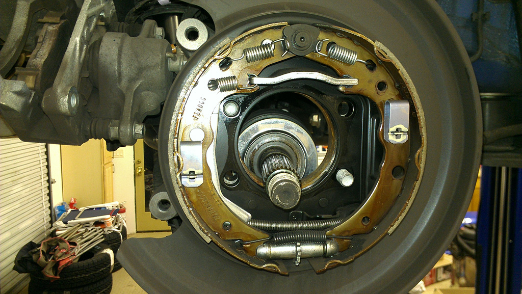

If youre doing the rear disks, you'll need to wind the handbrake off the disks by removing the rubber gromet from the disk, have that located at the bottom. The bit at the bottom of the pic with the spokes pointing out (visible through the newly revealed hole in the disk). Turn it one way with a screwdriver through the hole, it pushes/pulls the shoes from the disks, that will allow easy removal. Dont forget to wind it back in on the new set until tight and release it 2-3 notches otherwise the handbrake will do sweet FA.
