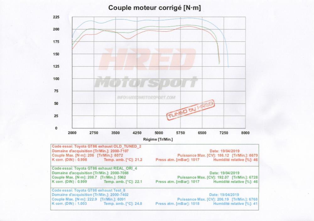

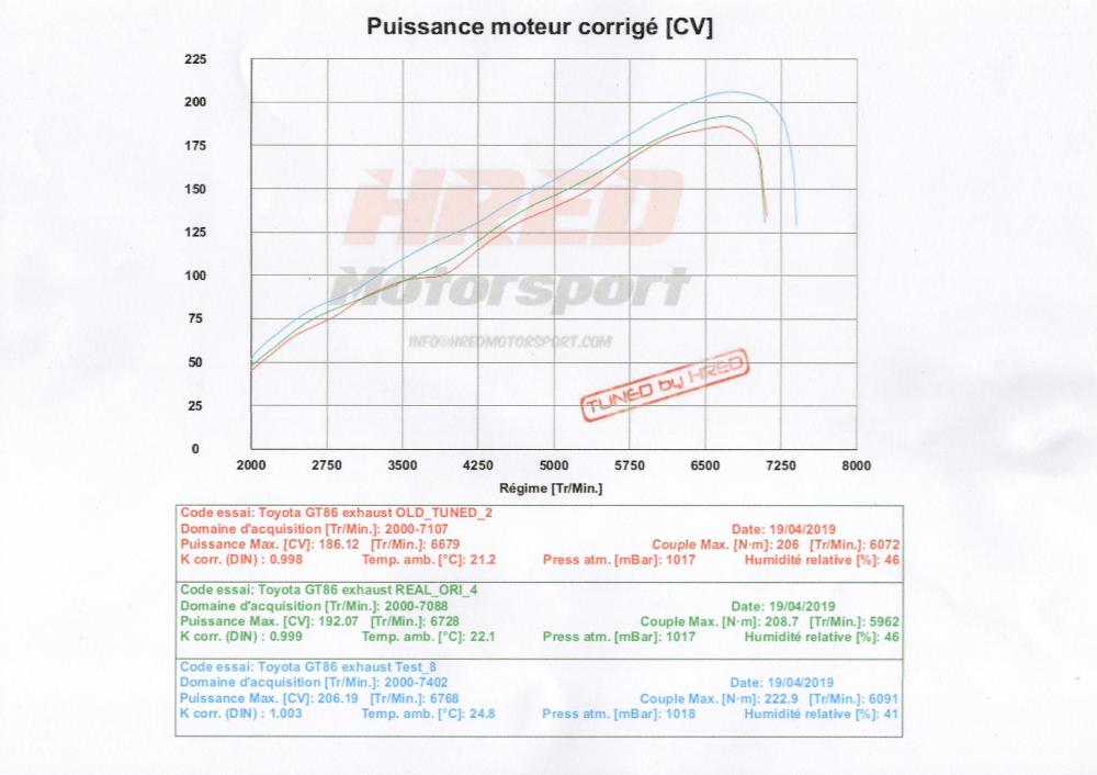

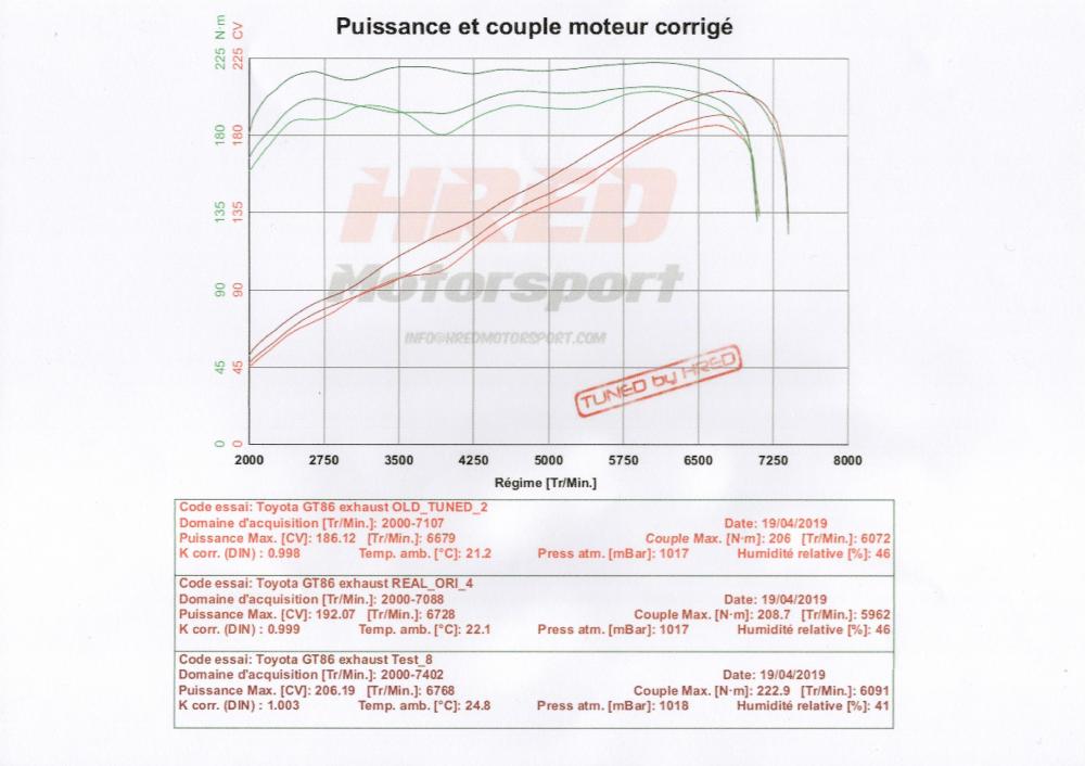

k2r79 12 Report post Posted April 19, 2019 Today I got my remap done at HRED Motorsport and I'm really satisfied with the outcome I also discovered that one of the previous owners had the car remapped in a weird way. Here are the charts representing the weird remap, the stock ECU and the HRED remap : I found the engine fuller on the whole RPM range and the difference isn't crazy like adding a turbo : the GT86 should come out the factory like that. For those who wanted to hear the exhaust, this is for you 2 BRZ-123 and BristolLee reacted to this Share this post Link to post Share on other sites
MartinT 514 Report post Posted April 19, 2019 Very similar numbers to mine for a similar setup (except you have EL and I have UEL). Nice to drive, isn't it? Share this post Link to post Share on other sites
k2r79 12 Report post Posted April 20, 2019 7 hours ago, MartinT said: Very similar numbers to mine for a similar setup (except you have EL and I have UEL). Nice to drive, isn't it? It's fantastic to drive, I spent my whole day driving it yesterday Can't wait to try it on the track ! 1 Lauren reacted to this Share this post Link to post Share on other sites
