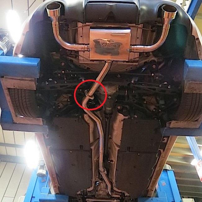

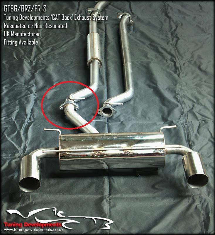

will300 812 Report post Posted August 27, 2018 No, you won't be able to combine a TD mid pipe to a cobra back box (muffler). Why don't you just get a TD resonated system? Here's a couple of photo's showing the difference (I've highlighted the join so you can see it's physically different): Cobra Exhaust: Tuning Developments Exhaust: 1 willclarke reacted to this Share this post Link to post Share on other sites
