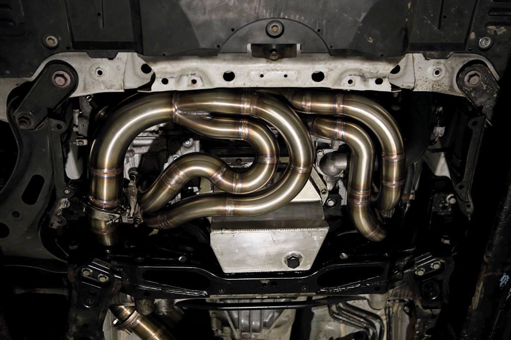

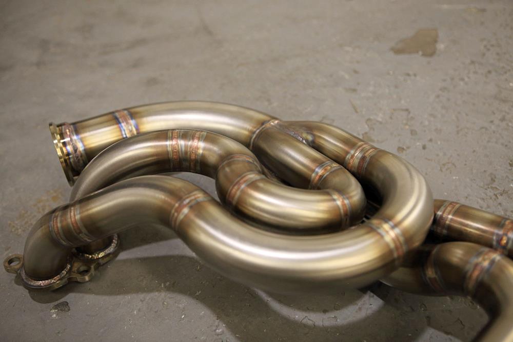

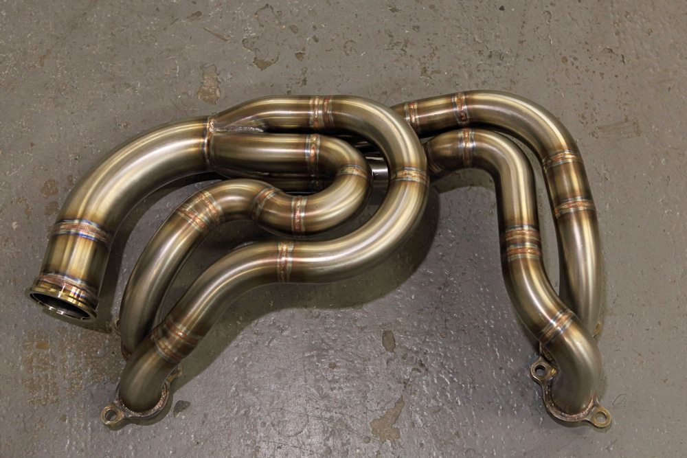

CGR Automotive 28 Report post Posted December 23, 2016 Hi Everyone! Here is our equal length GT86 / BRZ manifold for forced induction engines. We’ve meticulously designed the manifold to make sure that the primaries are all perfectly equal, and that our collector has optimised gas flow properties. We just can’t help being perfectionists! We know it looks pretty awesome, but this is only our development system so further refinements will be brought to our production models. We chose to develop equal length primaries coupled with a properly developed merge collector ensure that you’re getting maximum scavenging effect between cylinders therefore increase power as much as physically possible. At CGR we don’t use billet collectors, we know that the smoother the airflow the greater the power, so we precisely construct our collectors to maximise gas flow. Although this is a very difficult way of manufacturing, this ensures the gas leaving each cylinder merges effortlessly. Most people can’t work out how we can weld them with full penetration, maybe we’re just magicians! We're also able to offer manifolds for naturally aspirated models, and forced induction exhaust systems for people running more power than our initial 2.5" system was designed for. As usual with our products quality is very important to us, all welds are back-purge TIG welded and our bends are mandrel bend from 304 stainless steel. This forced induction manifold will be priced at £1355, the naturally aspirated version will be on sale for £1290. If you wish to add a Zircotec thermal ceramic coating we are happy to provide this at an extra cost. Get in touch for more information! www.facebook.com/cgrautomotive info@cgrautomotive.co.uk 01709 530871 4 long-gone, Keethos, Lauren and 1 other reacted to this Share this post Link to post Share on other sites

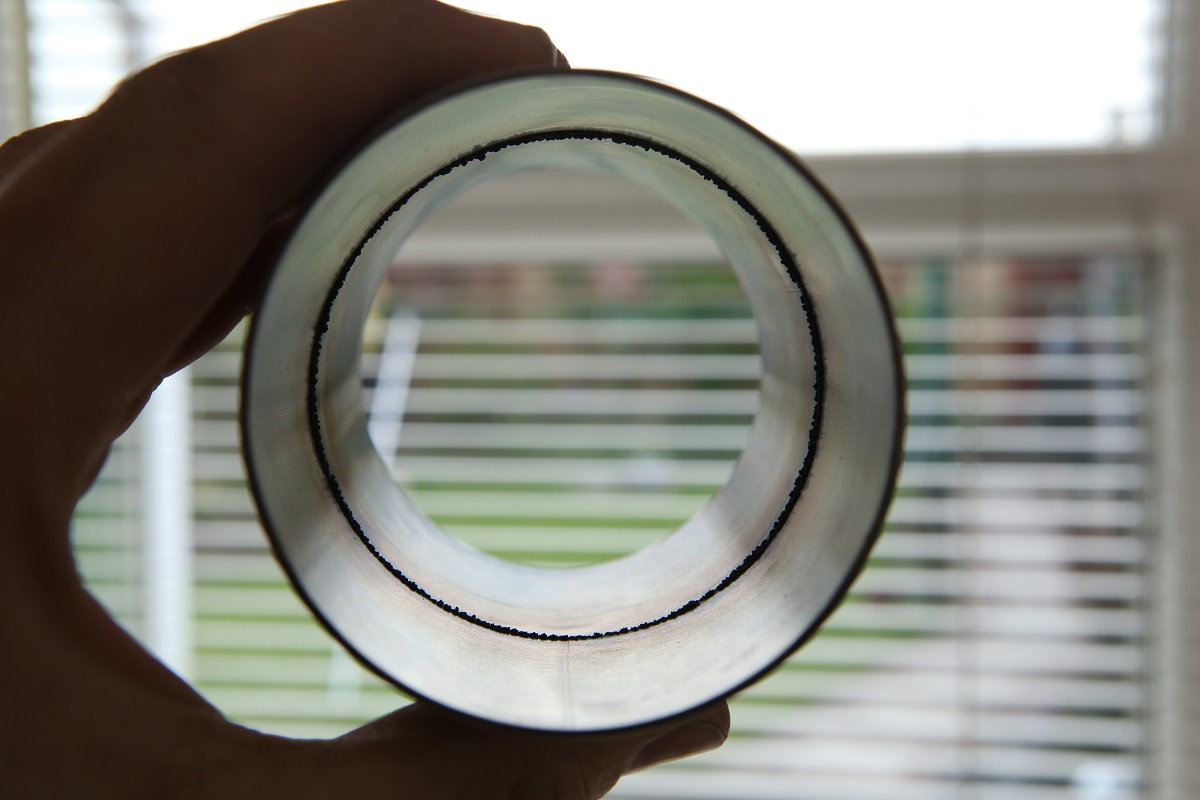

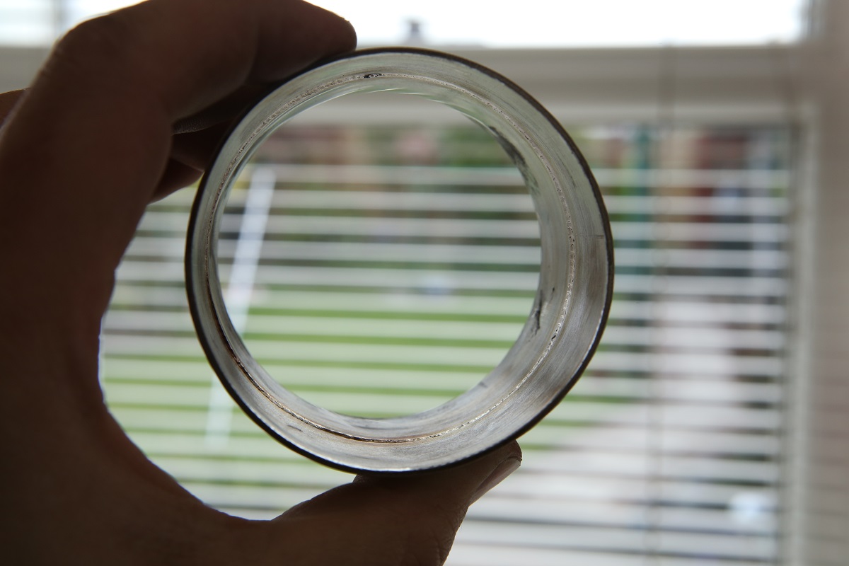

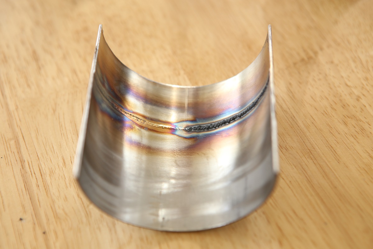

CGR Automotive 28 Report post Posted January 3, 2017 Thanks for the kind words guys all the welds are back-purged so it's guaranteed to flow and perform as well as it looks (if not better). Here's the difference between a back-purged and non-purged weld; Non back-purged, showing how restrictive the oxidisation can be. Back-purged with full penetration, a much stronger weld which poses no restriction on the gas flow inside the tube. Share this post Link to post Share on other sites
