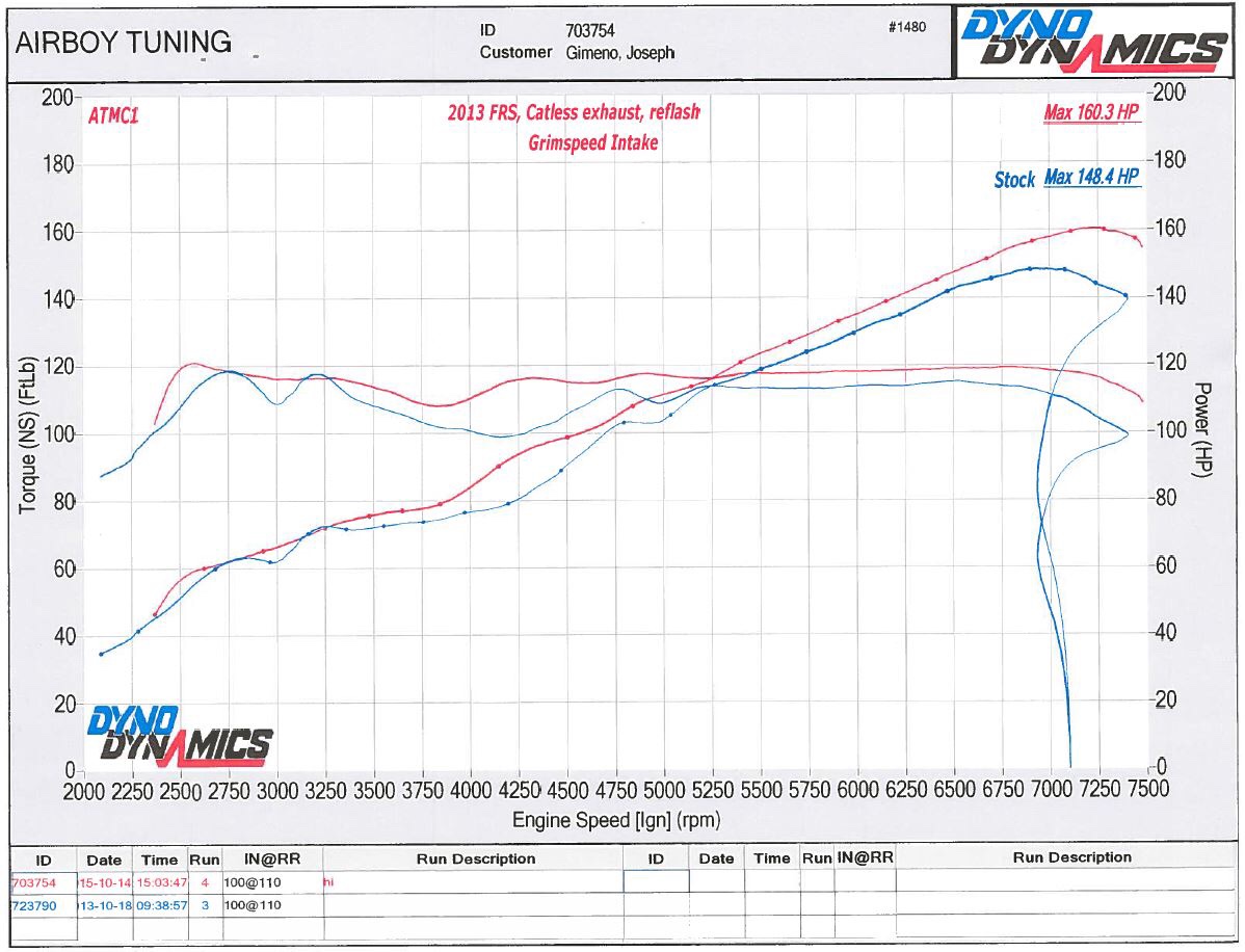

Was looking at this thread...
http://www.ft86club.com/forums/showthread.php?t=96235
.. where they have just gutted the cats and tuned the car basically.
The results look around 80% of a replacement header but at a fraction of the cost. Also almost deleting the torque dip.
IMG_8004.thumb.JPG.94a8a3b7ad1002681c13f
Has anyone done this over here? What are your thoughts?

Yes we did a few of these a while ago , It doesn't remove the torque dip we found, it helps make the torque dip a little less obvious.
approx a £400-00 job , quite labour extensive job , to remove all the heat shields , cut the cut out and fabricate the pipe to replace the Cat and weld up and refit all the heat shields

The one on the thread just smashed the cat in and didn't replace with a straight pipe.
Don't suppose you've got any plots?
Even if not £400 with replacing with stright pipe, but simply smashing primary cat, i'd leave stock as is.
1) cheapest aftermarket headers are not too expensive, eg. gruppe-s and alikes ..
2) they'll get rid from torque dip too & are lighter then stock
3) you'll have your free stock header for when/if sometime in future MOT inspection rules may get stricter and for when you'll sell your car without need to buy one used from someone parting out. Unmodded/stock cars often are much easier to sell, and sometimes even at premium vs modded ones.
