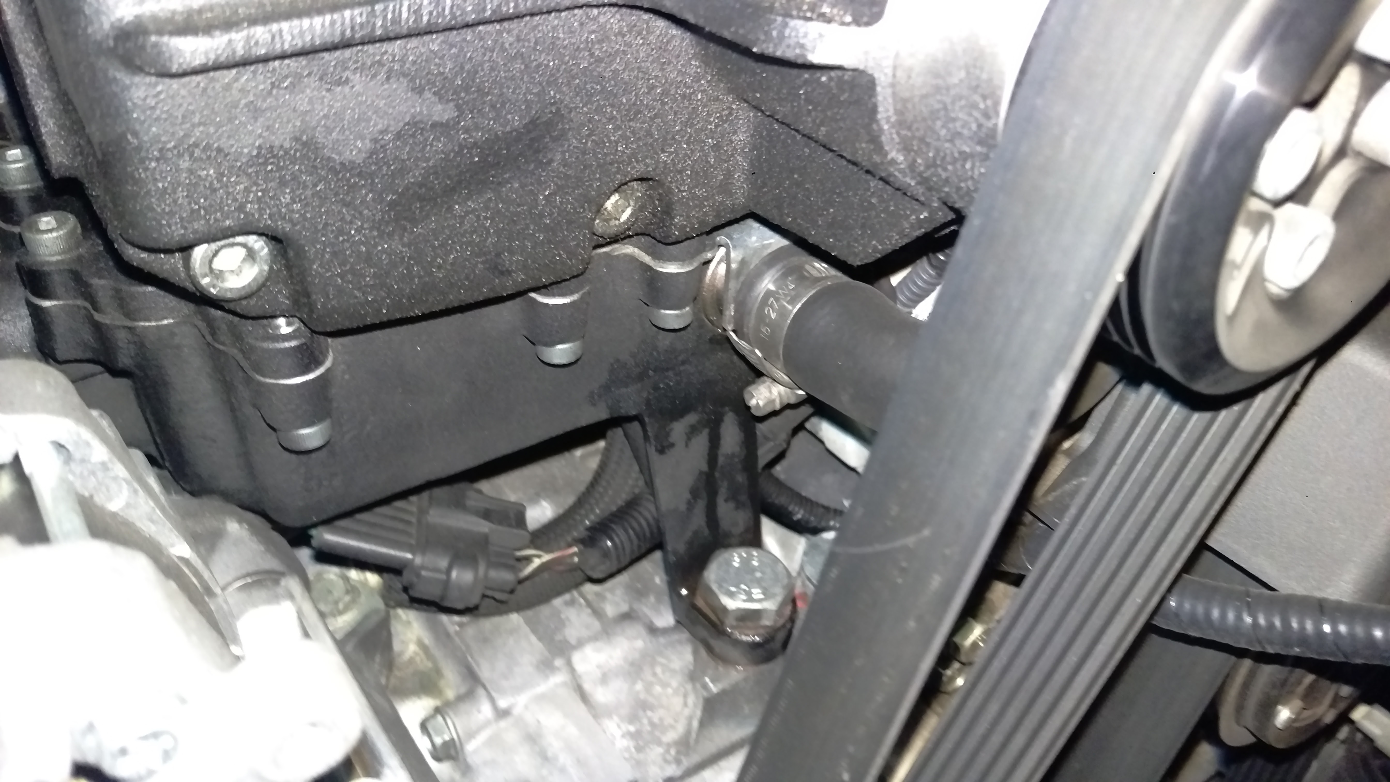

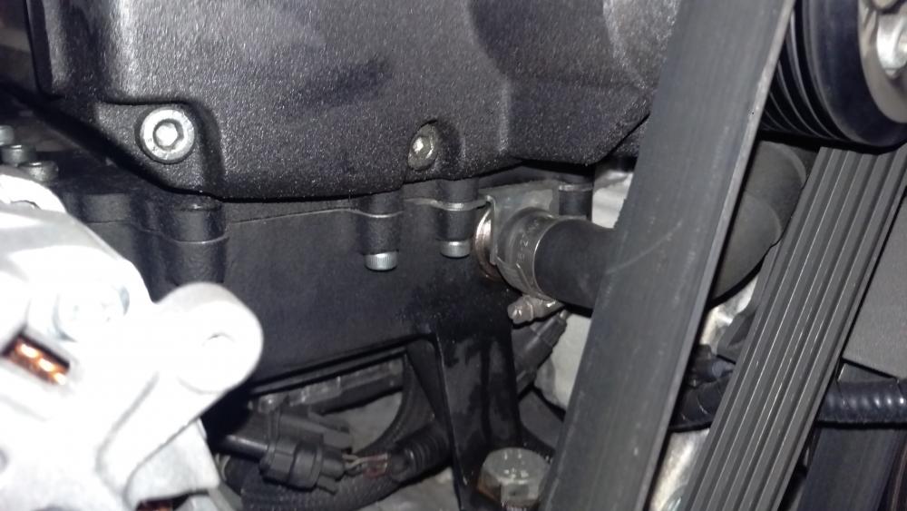

tegunulgener 84 Report post Posted November 6, 2016 Hi all... I assume the noise is coming from the s/c. The noise wasn't there in the morning. Checked oil. It was little low and topped it up but no change. Please check the photo and video. I need help since I need to go to work in the morning. Is it safe to drive like this? VIDEO0004.mp4 Share this post Link to post Share on other sites

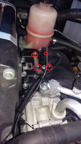

tegunulgener 84 Report post Posted November 10, 2016 Hey people... I fixed it. It was really a silly thing but it's always better to be cautious than sorry, isn't it? There are 4 screws on the sensor piece attached to the intake manifold. All were loose. Tightened them up and VIOLA! Noise has gone. I wonder why the screws (4 of them) were lose? Thank you one more time for your concerns. 1 nikndel reacted to this Share this post Link to post Share on other sites
