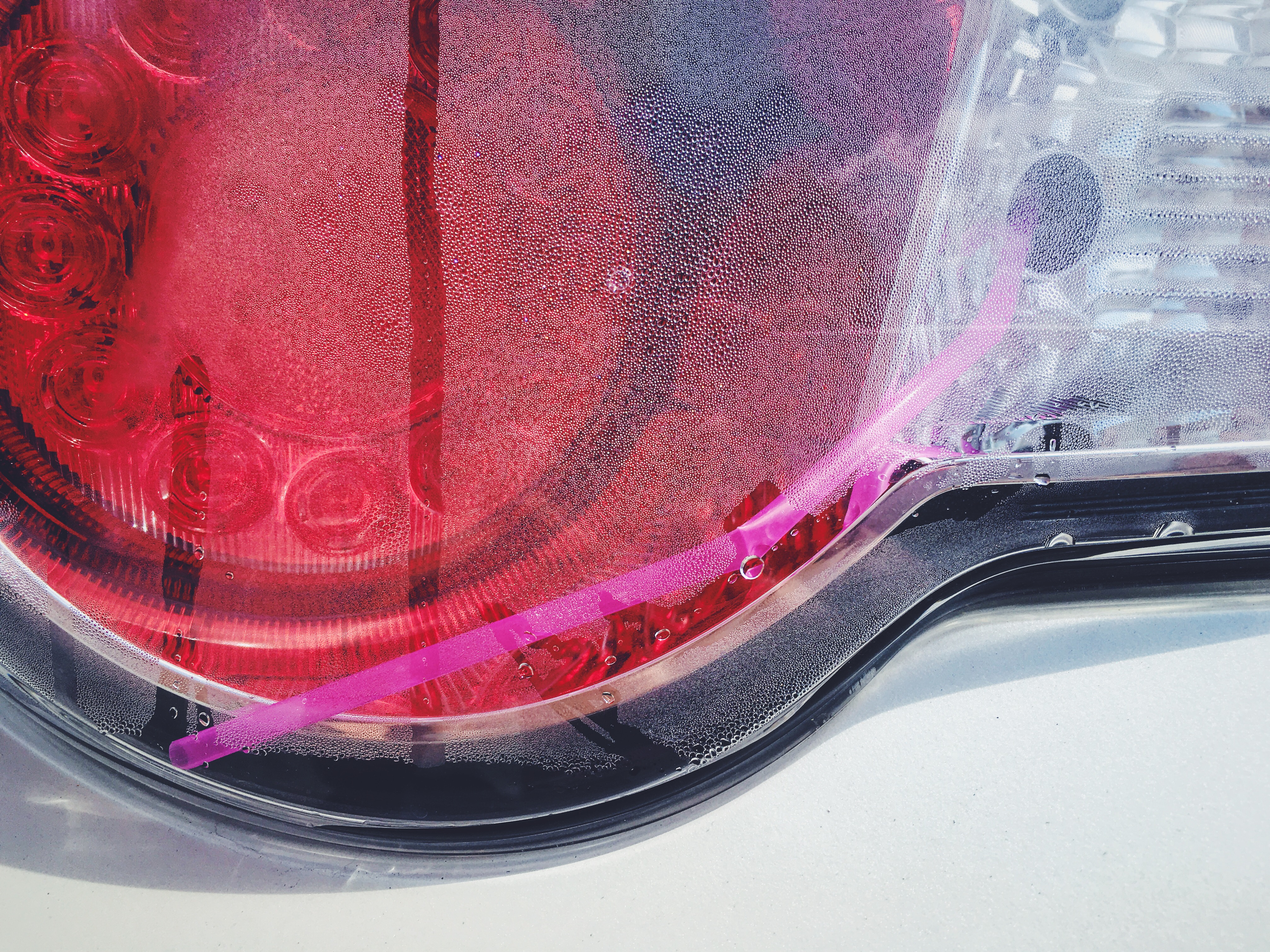

undercharged 17 Report post Posted June 18, 2016 After only 2 months of owning the car, I have a tail light full of steam devaporating on the clear housing and precipitating into a tiny lake on the bottom. Looking at numerous images of lightly and heavily tuned Toyotas and Subarus I am now starting to realise that stock units are rare. I do actually like the look of Valentis with matching lower piece, but not in this topic. Let's imagine our goal is to keep the car it it's perfect stock form as a showpiece. How do I dry the inside of the tail light in the most effective way, and how do I seal it? Share this post Link to post Share on other sites

rob275 1817 Report post Posted June 18, 2016 Remove them from the car and either air dry them out or place them in the oven on a low heat. Then just put them back on the car but don't over tighten them as this is what causes them to get water in them. 1 undercharged reacted to this Share this post Link to post Share on other sites
nikndel 509 Report post Posted June 18, 2016 Put some sealant under the black trim of the lights to divert the,water over the lights not down the back of them I showed Kevin Atkins this and it solved the same problem with his Buddy Clubs 1 undercharged reacted to this Share this post Link to post Share on other sites

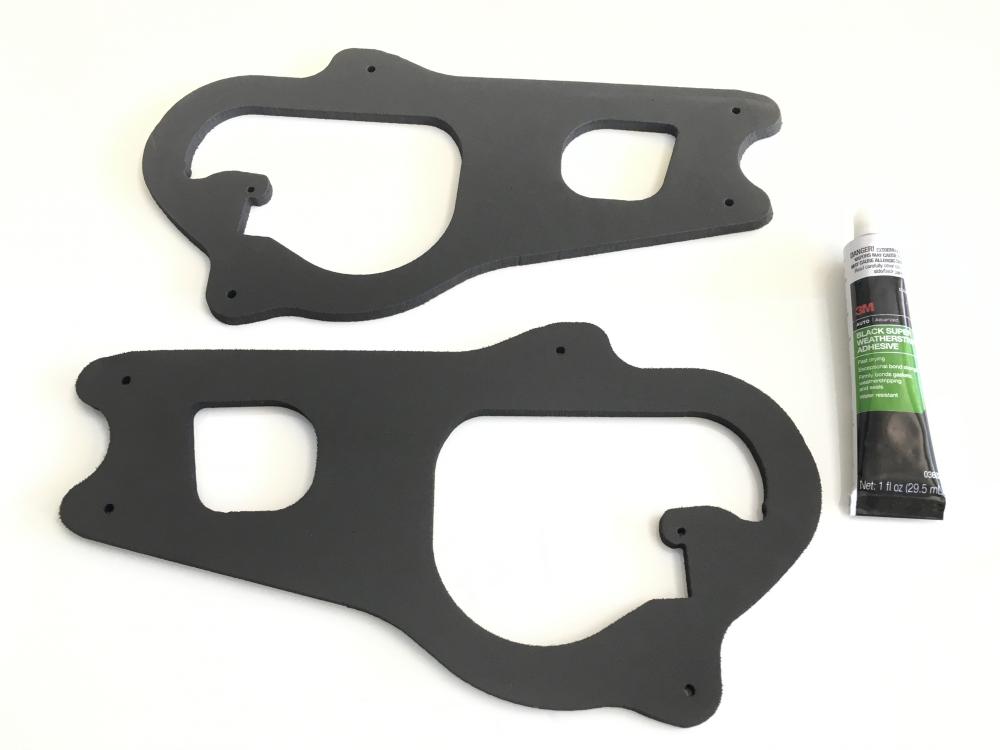

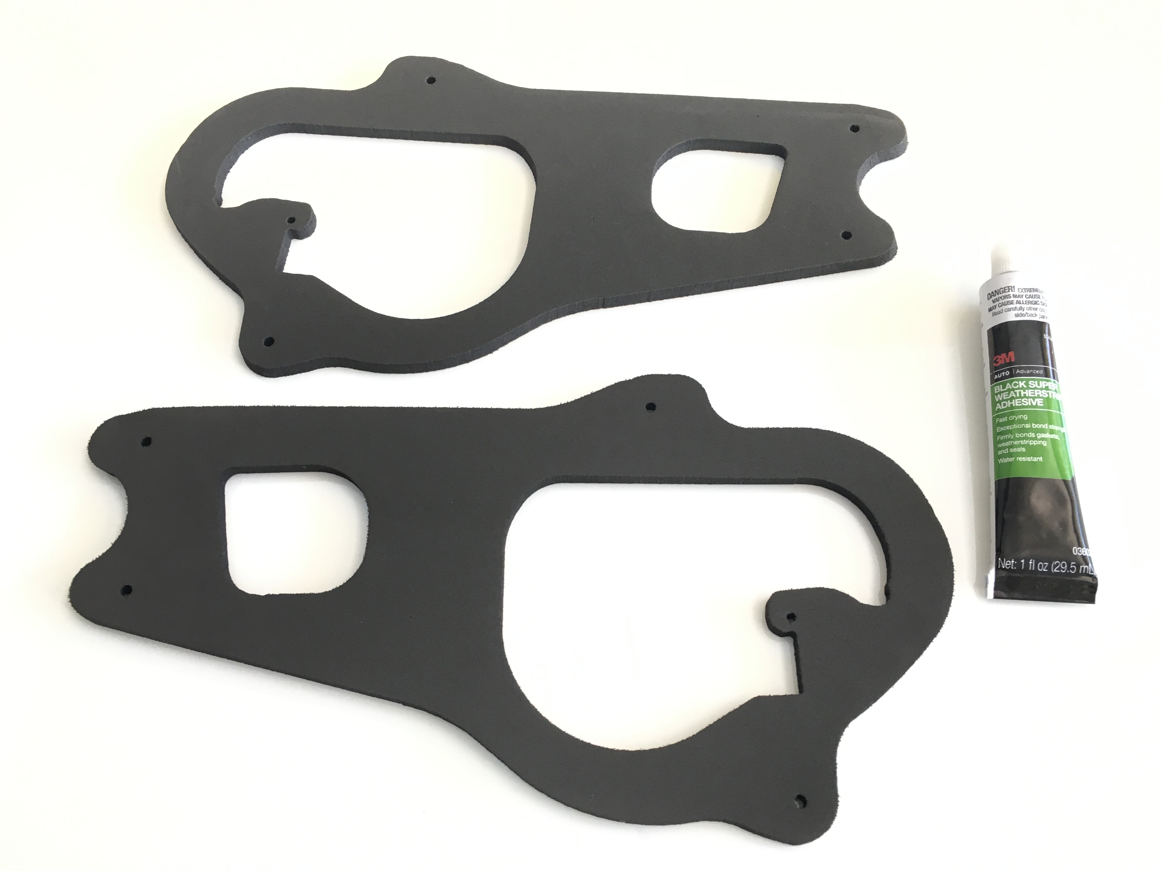

Kodename47 446 Report post Posted June 18, 2016 Just get new gaskets from Toyota if not under warranty or go one better and spend £30 and get the complete kit with neoprene gaskets and sealant from gaaketninja. Job done. 2 Gringosteve and undercharged reacted to this Share this post Link to post Share on other sites

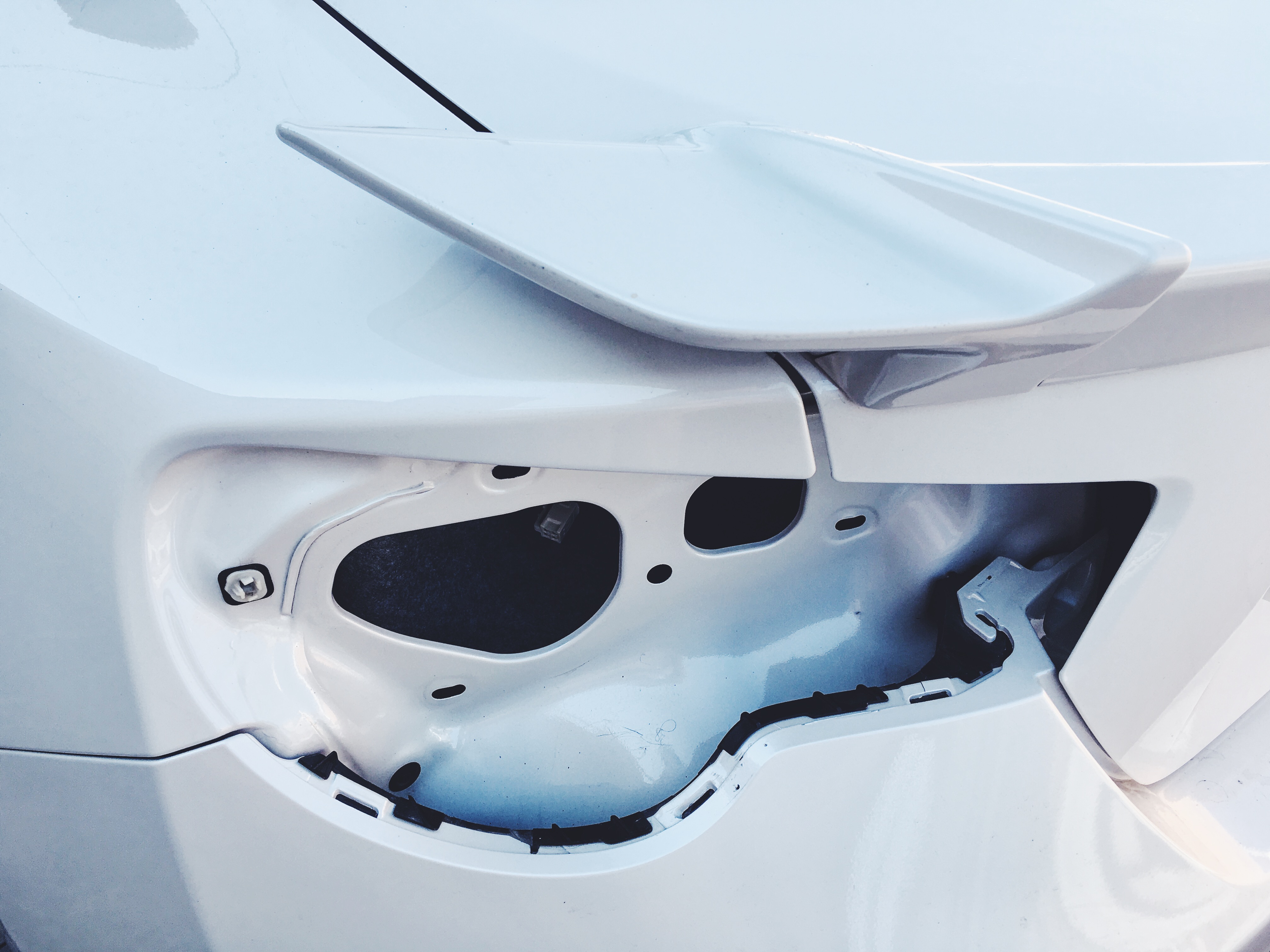

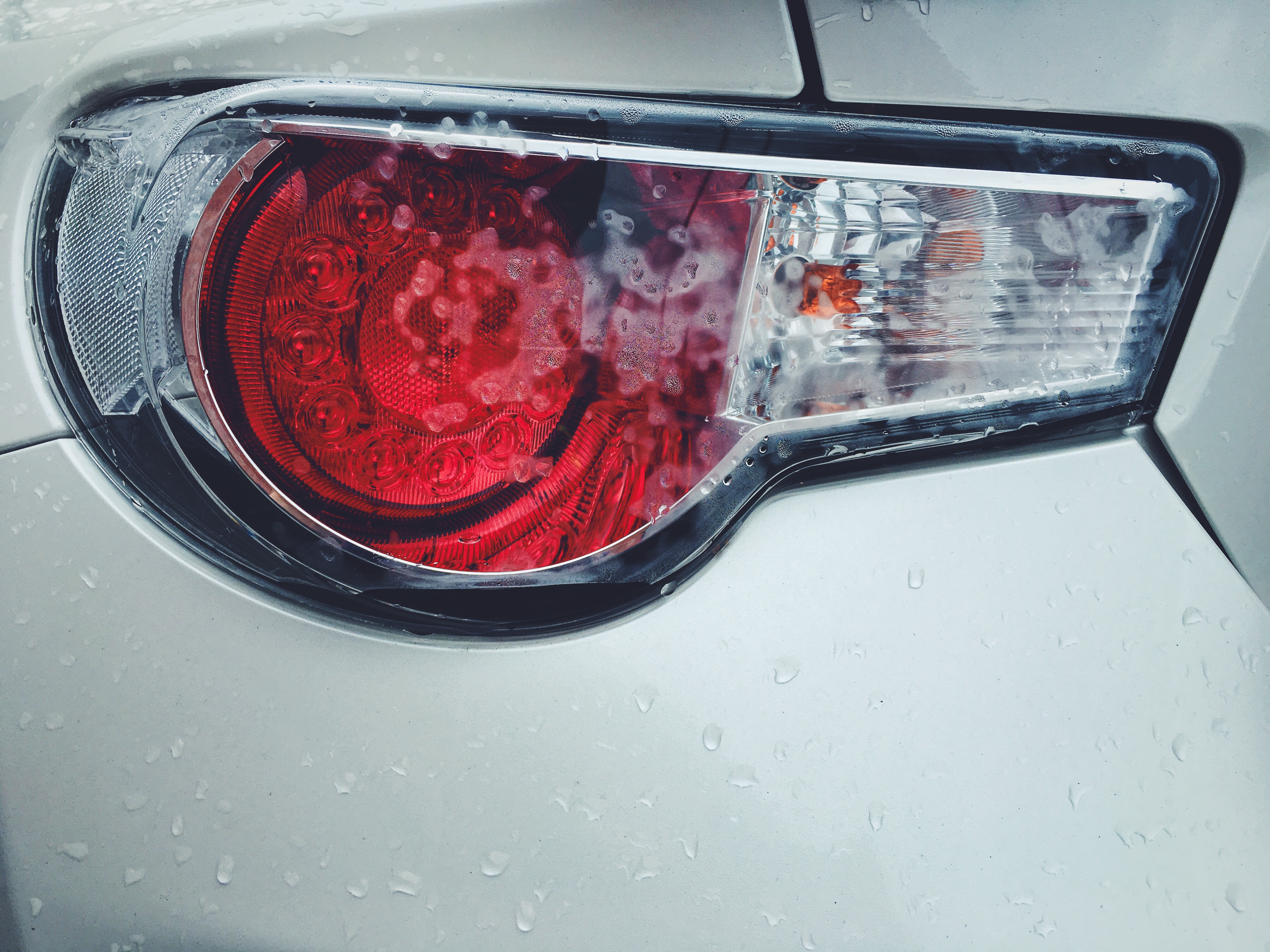

undercharged 17 Report post Posted July 11, 2016 Followed the advice of knightryder and ordered a kit from Gasket Ninja a while ago. The thickness and quality is promising. Tails removed, cleaned, fully dried inside and out and ready for further work. The rear looks clean without them. Showers are forecasted later this week, so my update on the outcome will follow. 1 Keethos reacted to this Share this post Link to post Share on other sites
