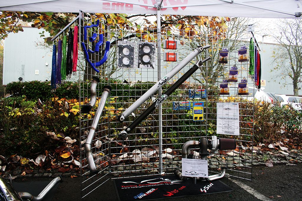

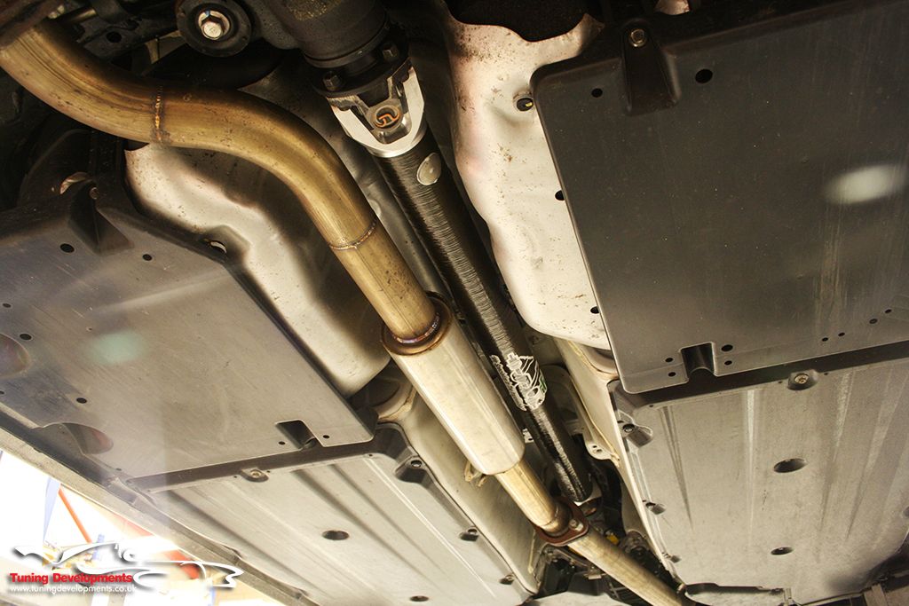

Had these in stock for a little while now, they're a VERY nice piece of kit.
Those that were at the open day towards the end of the day felt the weight of these, they're incredibly light :)  We weighed the Carbon version at 5.1kg and the Aluminium at 5.7kg. Both versions are rated at over 700bhp. Our stock GT86 Propshaft weighed in at 10.9kg so a very healthy saving!
In stock are both the Aluminium & Carbon Fibre versions.
