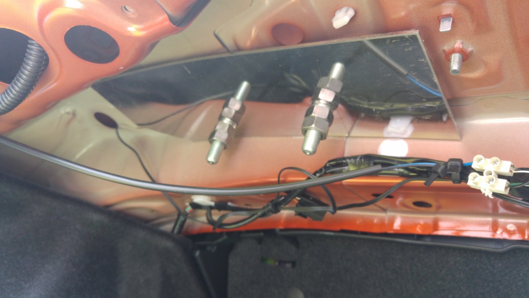

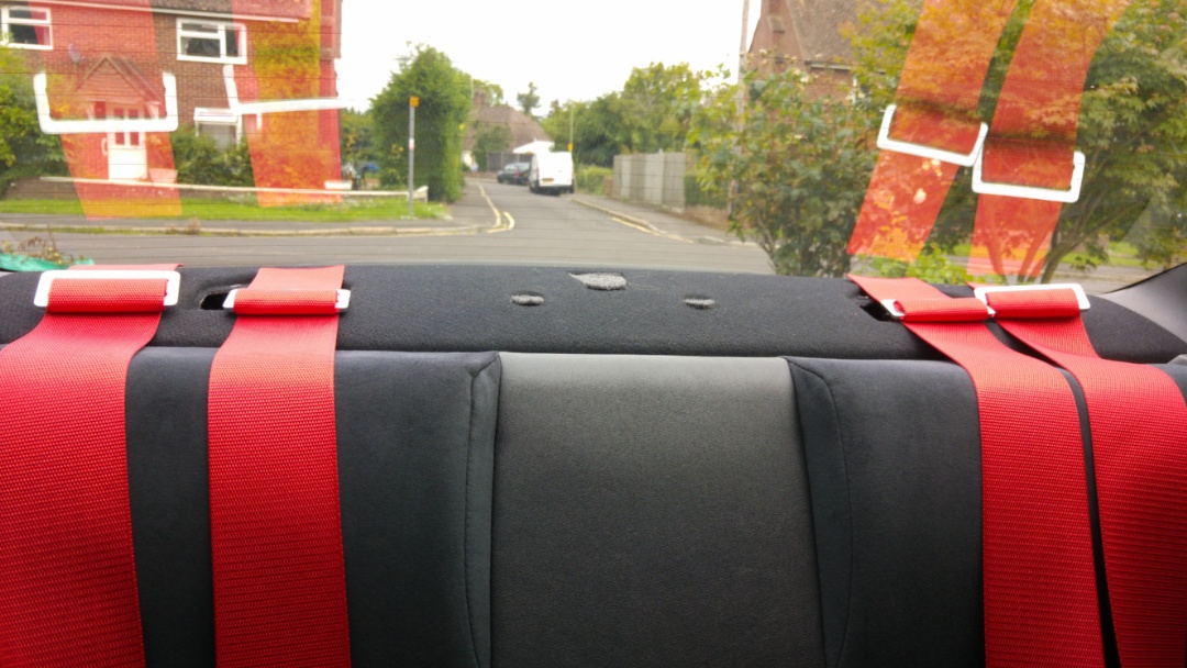

KevinA 695 Report post Posted August 29, 2015 5mm steel plate and double lock nut with washers, passed by MSA scrutineer. 3 Tareim, smudge and Keethos reacted to this Share this post Link to post Share on other sites
smudge 1020 Report post Posted August 29, 2015 Isn't having the straps that long to the mounting point a bit frowned upon though? Think I've made my mind up after visiting GSM Performance today and having a try of a few seats. Just need to do some measurements to make sure and then I'll be ordering soon Share this post Link to post Share on other sites
KevinA 695 Report post Posted August 29, 2015 No or it wouldn't pass scrutineering, angle is what is more important. Share this post Link to post Share on other sites

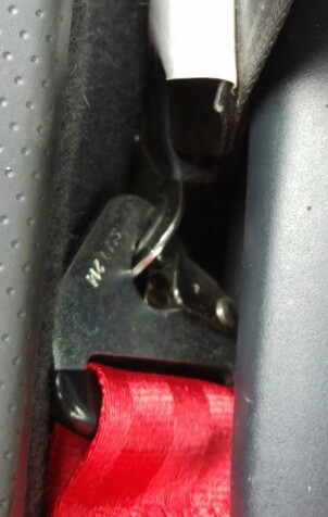

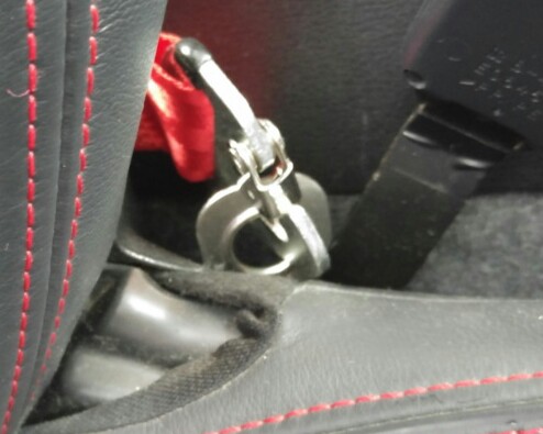

Tareim 343 Report post Posted August 29, 2015 @KevinA how did you manage to attach it around the seat, did you use any existing bolts such as the standard seat buckle clip thingy Share this post Link to post Share on other sites
Lauren 2259 Report post Posted August 30, 2015 Sam, Kev will have used the stock lapbelt bolt holes, with an eyebolt for the harnesses to clip into. Share this post Link to post Share on other sites
KevinA 695 Report post Posted August 30, 2015 Got Scroth eyebolts that use the original lap belt point. Can put a picture up for you later. Share this post Link to post Share on other sites
Tareim 343 Report post Posted August 30, 2015 Got Scroth eyebolts that use the original lap belt point. Can put a picture up for you later. pics would be great thanks Share this post Link to post Share on other sites
KevinA 695 Report post Posted August 31, 2015 1 Tareim reacted to this Share this post Link to post Share on other sites
