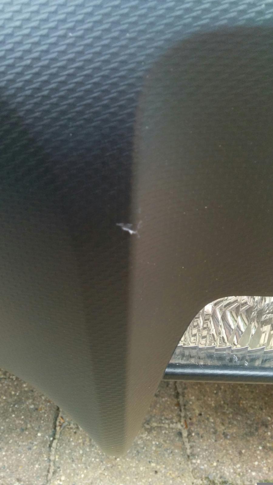

Solwood 10 Report post Posted August 7, 2015 Photo of the damage I am assuming the carbon effect is in in fact a wrap? Share this post Link to post Share on other sites
rob275 1817 Report post Posted August 7, 2015 No it's not a wrap, sand it down a bit lightly then blast it with a heat gun for 2-5 seconds. It'll turn the same colour as the rest of it job done Share this post Link to post Share on other sites
Solwood 10 Report post Posted August 7, 2015 That sounds like the voice of experience!! Thank you I see you are in Surrey too - any chance I could come over and you could show me how (as I don't have a heat gun!?) As I don't have a heat gun, I am a baker so happy to bring cake !!! Share this post Link to post Share on other sites
rob275 1817 Report post Posted August 7, 2015 That sounds like the voice of experience!! Thank you I see you are in Surrey too - any chance I could come over and you could show me how (as I don't have a heat gun!?) As I don't have a heat gun, I am a baker so happy to bring cake !!! Heat guns are great for restoring plactics, it should in theory make it darker. Despite the damage still being there it shouldn't be anywhere near as visible. Bring it over this Saturday if you like, having a BBQ round mine for the club anyway http://www.gt86.org.uk/forums/topic/2763-robs-gt86bq-surrey-part-3/ Share this post Link to post Share on other sites
