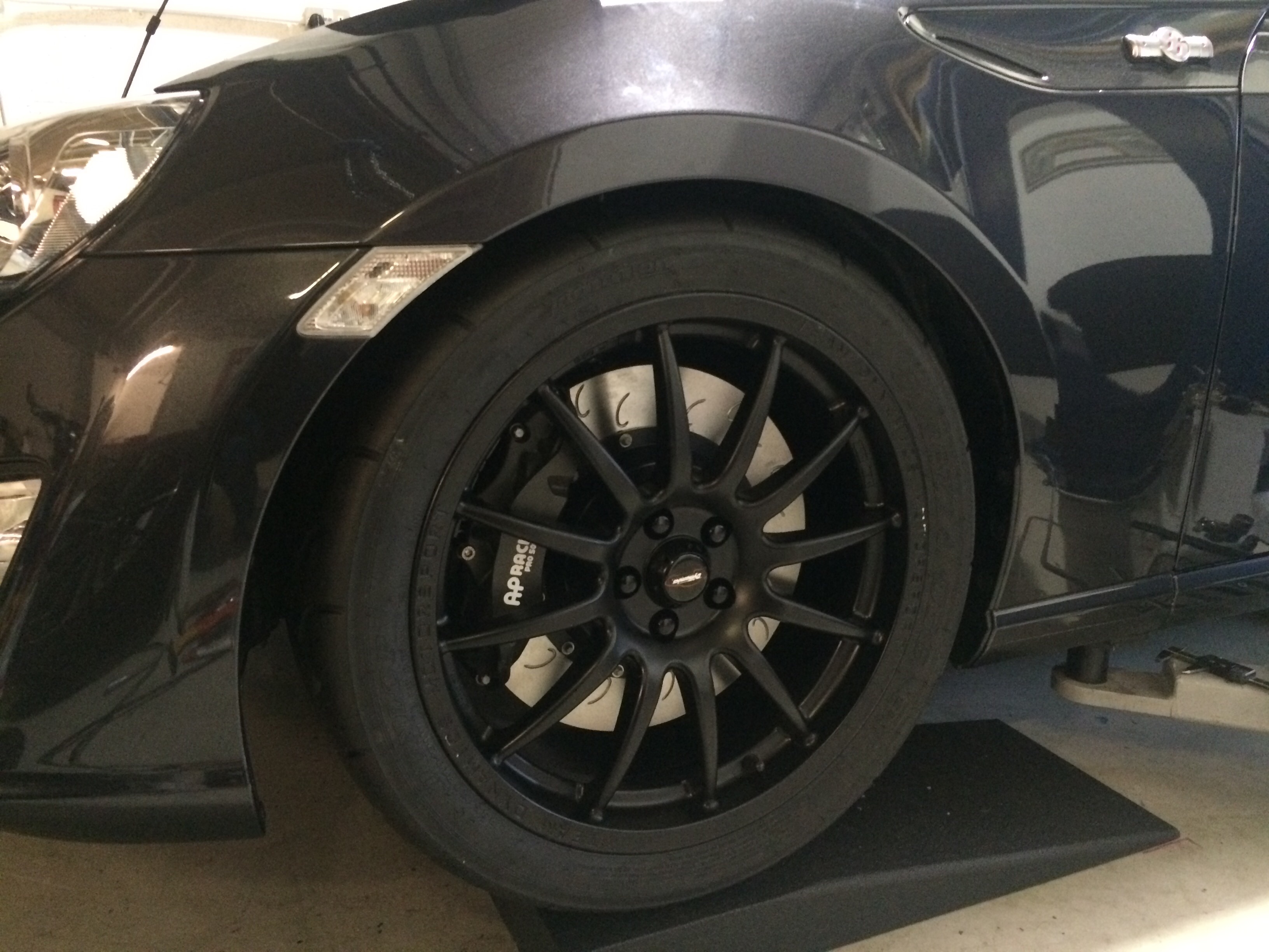

Guest Report post Posted October 19, 2015 I measured my castor last night at this ride height and with the top mount moved back by 4mm it was 6.4 degrees. That was with 2 degrees negative camberThanks Tim,You're obviously measuring this with a gauge?. It correlates with my measurements as you have induced extra at the top but are not as low. That looks like a circa 30mm drop there? Share this post Link to post Share on other sites
Tim Radley 18 Report post Posted October 19, 2015 Thanks Tim,You're obviously measuring this with a gauge?. It correlates with my measurements as you have induced extra at the top but are not as low. That looks like a circa 30mm drop there?Yes with a castor/camber gauge. Two man job, I wish I had a proper machine I actually can't find the stock ride height measurements. If you measure yours from the ground to peak of each wheel arch i'll do the same here in a minute when i get it off the ramp. Share this post Link to post Share on other sites
shiftspark 41 Report post Posted October 19, 2015 Nice info Nigel , you are certainly putting in all the work behind the mods rather than just cutting it all away.Hope your not throwing those "old " wheels away lol Share this post Link to post Share on other sites
Tim Radley 18 Report post Posted October 20, 2015 643mm front and 646mm rear Share this post Link to post Share on other sites

Guest Report post Posted October 23, 2015 (edited) 643mm front and 646mm rear660 front and 678 rear are the stock heights on my daily driver, now known as "Wrighty", cos she's a write off. So, I am the proud owner of Wrighty and Tommy. What a nice pair!! Edited October 23, 2015 by Nigelr32 Share this post Link to post Share on other sites
