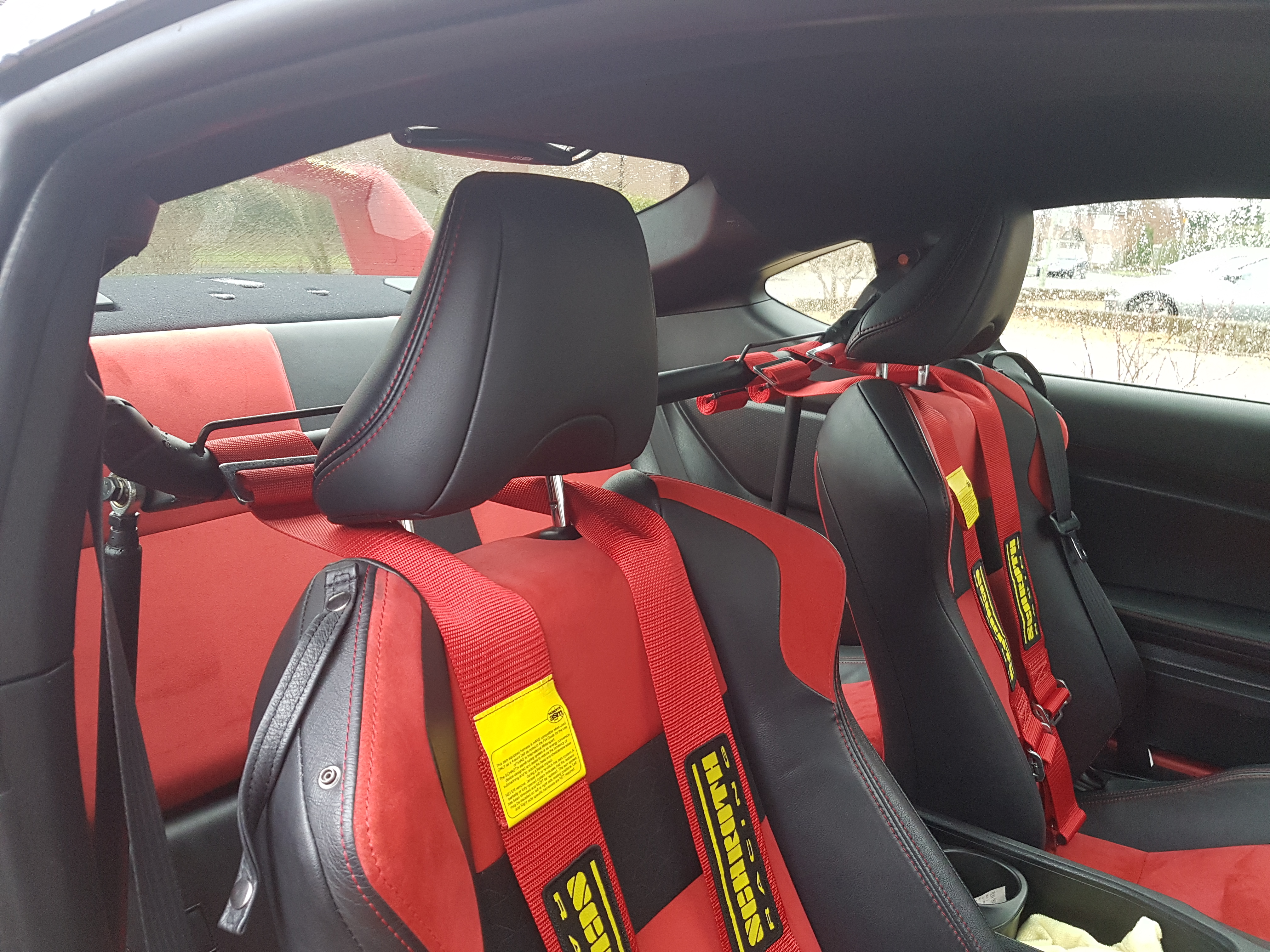

on the B pillar I'd imagine with those 2 rods going down into the footwells somewhere from the middle for rigidity
I wanted to go down the harness bar route, but the options around were all so expensive. The Schroth Rallye 3's were the best choice for me at the time, as per @Tareim's picture. They work well :)

Also are those bars easy to take out if you do need to use the rear seat? I'm actually quite tempted. But I do very occasionally need to lift a kid and stick them in the back. My work you understand! Or maybe having a harness bar will give me a good excuse not to!
1 hour ago, MikeB said:
More pics please Kev, how it mounts to floor and bottom mounts where belts fix too.
Can you still drop back seats down?
Mike will get some more pics tomorrow, the rear seat only goes down about half way.
