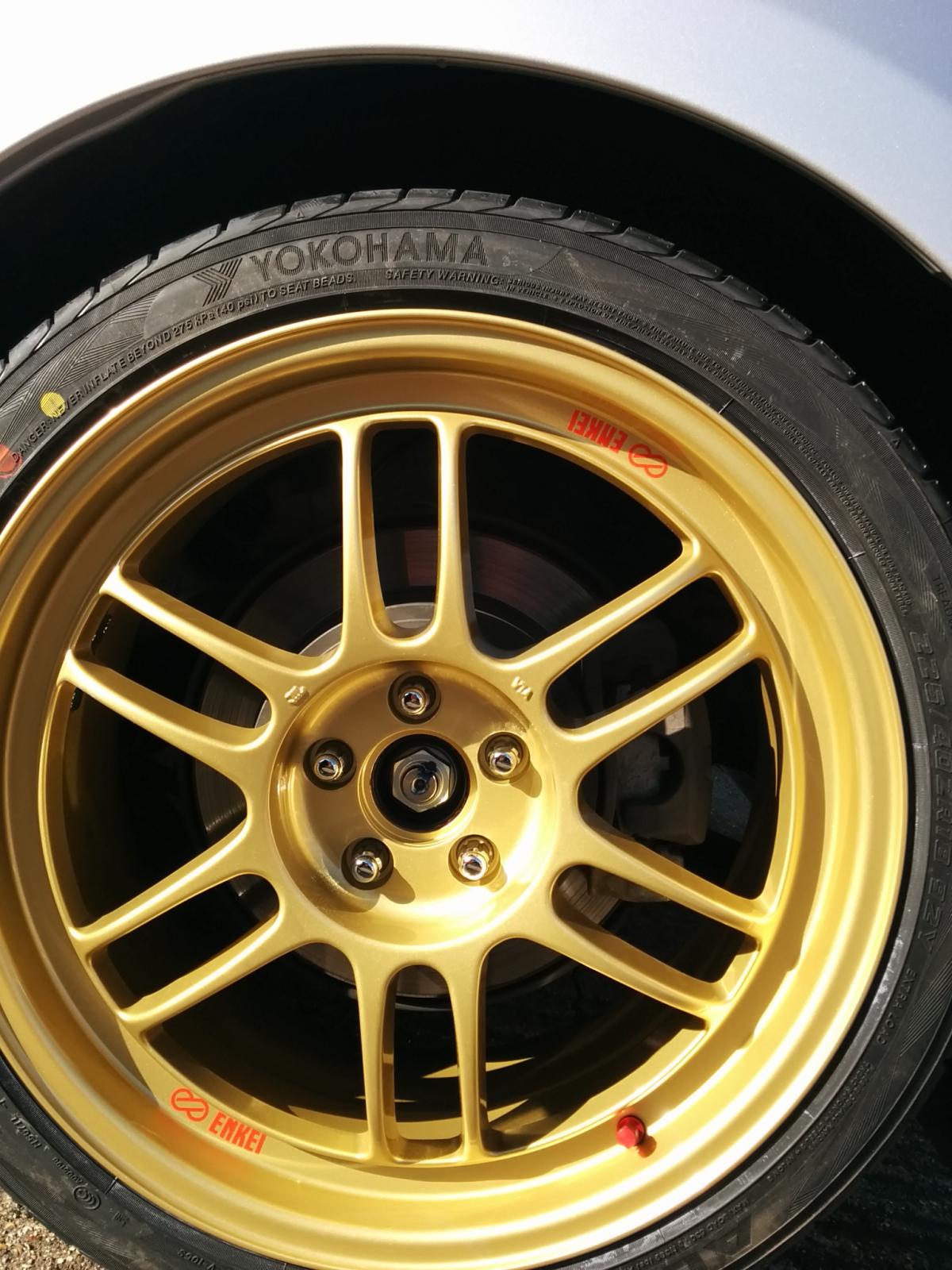

CHOSENMAN007 81 Report post Posted May 16, 2014 Just after 2 weeks of having my enkei's fitted I decided to check my nuts. 120nm of torque dialed in on my wrench. Almost a quarter turn was given on 3 wheels bar 1 which I re- torqued at bhp due to a loose valve washer. Makes you think, its something we don't check! Tire pressures yes. But be honest how often do you check your nuts? Quarter turn after 2 weeks well almost a quarter. Imagine 2 months.. Not so sure on those with older wheels as I'm sure after time they seize slightly. But thoses with new fitments just sanity check your nuts! Share this post Link to post Share on other sites

CHOSENMAN007 81 Report post Posted June 11, 2014 I agree great tires... But I'm a jap man hence the yoko's. Share this post Link to post Share on other sites

CHOSENMAN007 81 Report post Posted June 12, 2014 Lol.. Mate these are the best tires I have ever used. I've had most brands on other cars. The complaints must be for the ad08s or paradas which are track tires. Even the old v103s. The v105s are a different story. Only negative I can say is due to the stickiness of the tire your fuel eco suffers. But who buys a sports car and tunes it with fuel on mind! These yoko's ride very well on 30psi. The reviews say it all really. They beat conti's, Michelin's, bridge stones and the rest bar the good year eagles who gripped better in the dry taking 1st yoko's 2nd. The yoko's had better wet grip taking first. That's a Evo review. And I totally agree. Amazing tire. That's why its the OEM tire for the new rs6.also they look very aggressive compared to euro brands. Share this post Link to post Share on other sites
