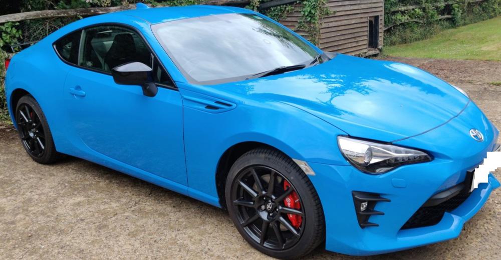

So I'm the owner of a 2019 GT86 Club Series Blue Edition with the added extra Performance Pack...
Picture of my car below! It's awesome and truly very very happy with it.
However, there's one thing I'm not too happy with and that's the wheel arch gaps... they're pretty silly sized.
So I'd like to drop it by 25mm front and back... nothing crazy because lets face it roads in the UK are not the best..
