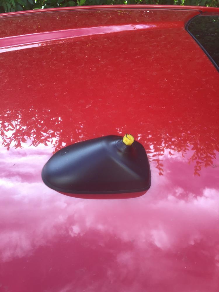

I got a Gt86 at the weekend and all was well. Decided to wash it yesterday, and removed the bee sting aerial while doing so.
The radio no longer has any reception (the aerial was screwed back on obviously)  :-)
Any help / pointers / advice as to what could have gone wrong or how to fix it?

Check that no water got into the connector or wiring.
I know the facelift models have powered aerials, they might all have?  In which case, power to the aerial may have been lost, like a blown fuse.  That's usually behind the head unit.
There’s a pcb in the aerial base I snapped a aftermarket one in it and tried to get it out luckily I found a new aerial dirt cheap and comes with a plastic bung to fit should you remove aerial for any reason

I took the antenna off to wash it, as it says to in the owners manual so it must be designed to be OK to do so, and dried the screw thread hole as best as I could before refitting it.
When I had to change my antenna base when I got a new one it came with a blanking plug for protection well mine did anyway just seems strange after washing car with hole open your radio gets no signal could be a coincidence
It's very likely that water ingress went down the co-ax cable, causing a short for both the signal and the amplifier voltage.  You would have to carefully dismantle the aerial assembly and dry it all with a hairdryer or similar.
