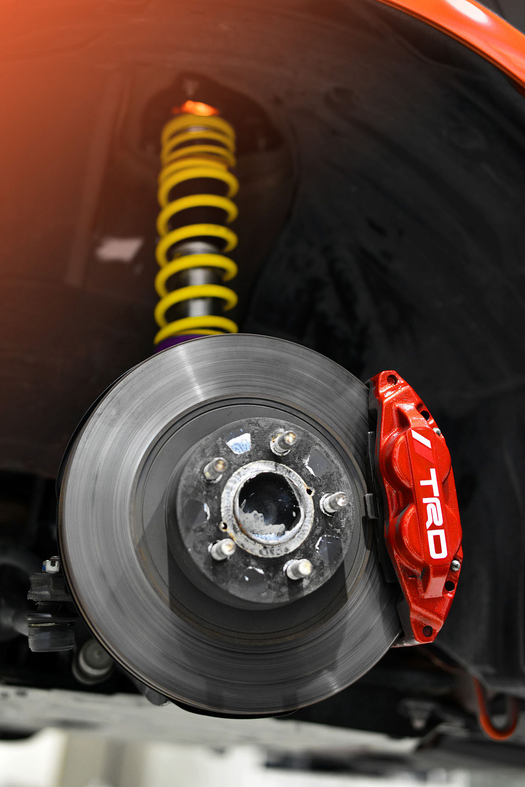

All,
I'm going to be changing to the subaru 4 pot calipers off the wrx (not sti)(my mate gave me his free )) and am aware they may actually provide slightly less overall braking performance vs the stock gt86 calipers shifting the brake bias from what I have read about 4% rearward
However, if I was to add a decent pad up front e.g ds2500/CLrc5+ etc and just run oem rear pads surely under hard (and possibly normal) use that would neutralize the difference in brake bias presuming that the 4% would even be noticeable with stock pads all around?
I may have got my head all confused about this but I know theres some very clued up folks here!
Any help greatly appreciated
Dan

I had a look on the spreadsheet but there is no brz :( would i be right in thinking maybe the legacy GT uses the same brakes? If so it was 5.4% rearward on stock pads but 15% forward on performance pads...
@br0wny Here are the stats for the WRX calipers, based on those figures its a 5.2% 2.4% increase in rear bias.

So 5% more rear bias still leaves me confused regarding brake pad choice. Do I match them all round or get new oem rears and decent fronts or decent rears and even better fronts hahaha.

Ignore me, it's 2.4% bias rear (I was comparing the stock with my own setup). Just run the same pad type all round.
Not changing the rears to the wrx 2 pots so probs nearer the 5%
The WRX 2 pots are exactly the same size pistons as our stock floating caliper, so wont change bias.
