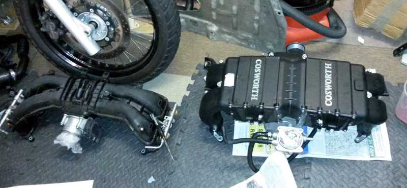

thetyrant 30 Report post Posted September 13, 2017 Ok that's the Cosworth kit all carefully removed, standard parts refitted and fired up no problems so now I can move car out the garage I will get on checking,cleaning and sorting all Cosworth parts ready for a new owner, get in touch if you want some boost More pictures to follow but here is a quick snap as I started to swap over parts showing difference in size between weedy stock plastic intake and the Cosworth setup! Cheers Ian Share this post Link to post Share on other sites

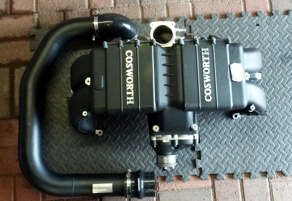

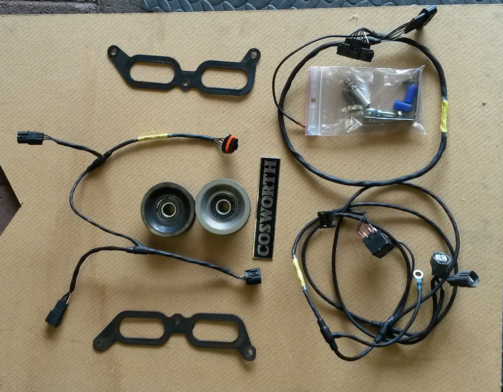

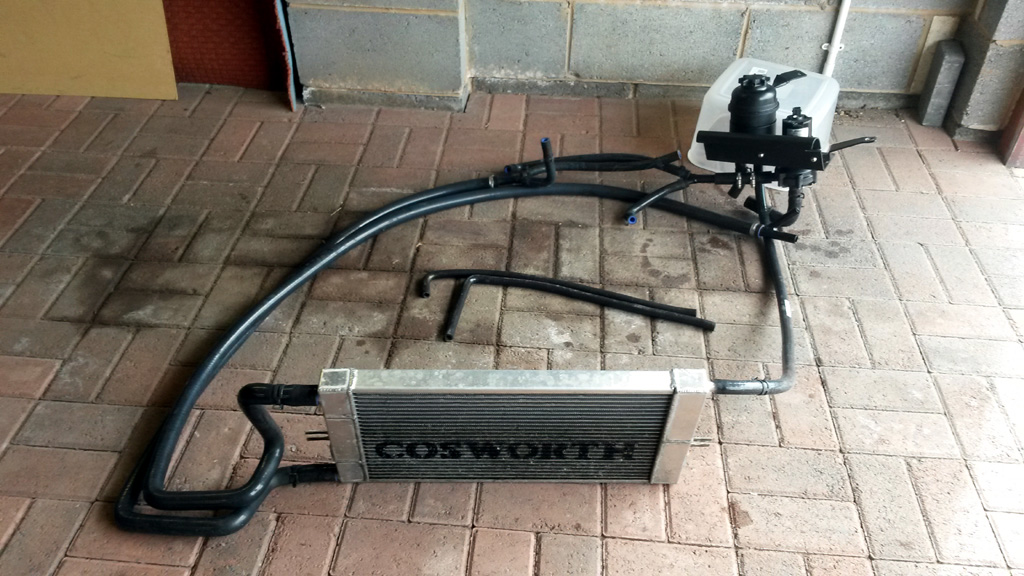

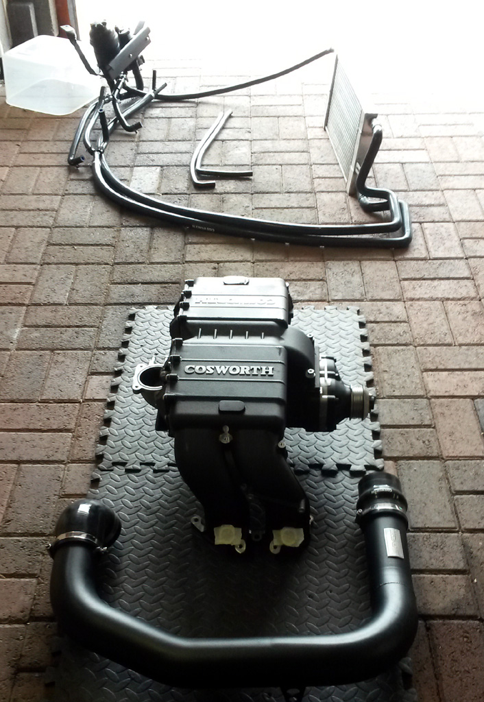

thetyrant 30 Report post Posted September 16, 2017 Few more pics taken today after a check over and clean up, all ready for someone else to enjoy now Ian 2 shiftspark and Kal reacted to this Share this post Link to post Share on other sites
