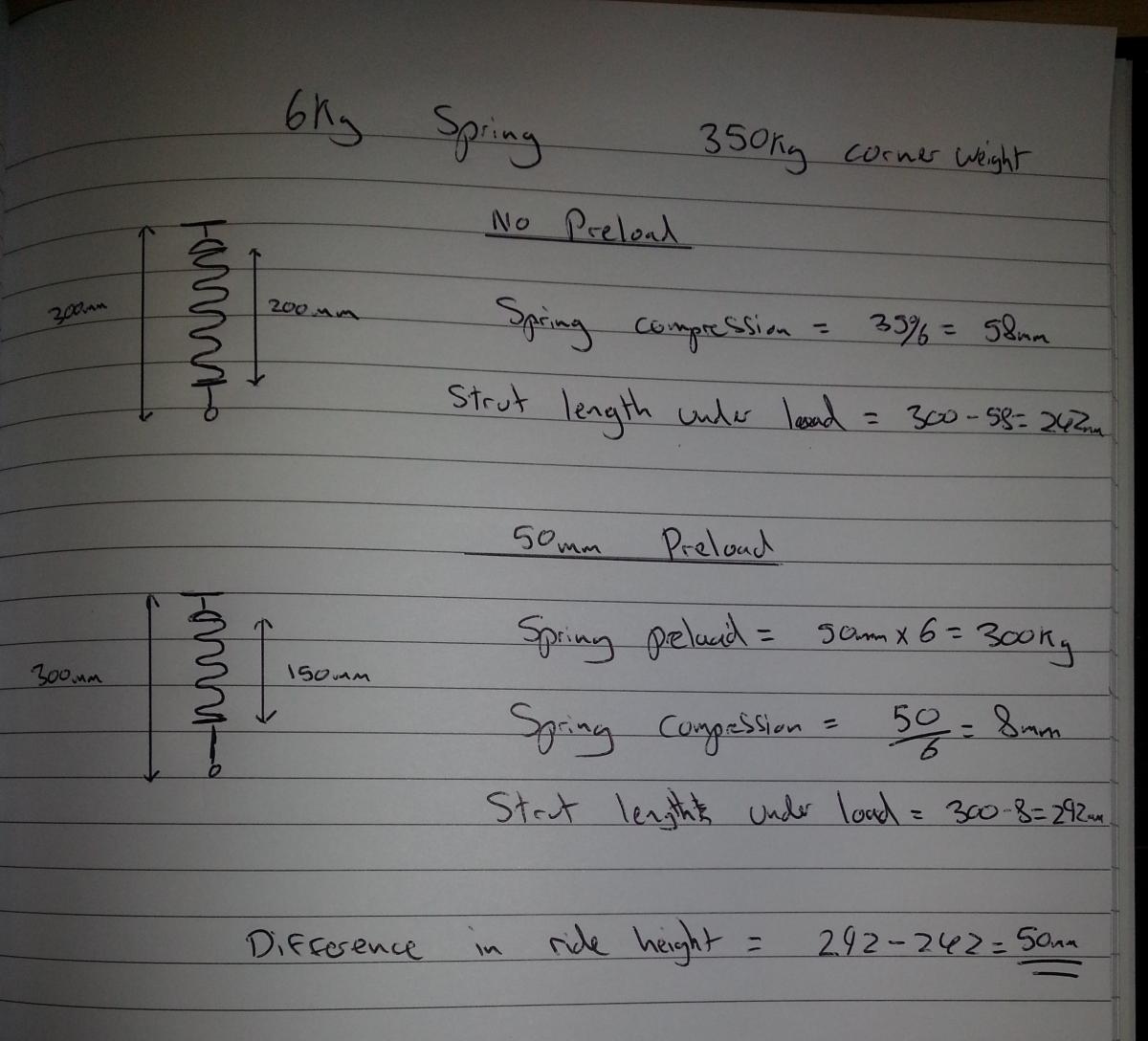

I am often wrong so here is a diagram to show what I mean by adusting preload to change the ride hight (but losing or gaining droop travel):
8mm vs 58mm droop travel
Am I doing something wrong?

Your error is that you are imagining the top mount is fixed. The difference is indeed 50mm, but your description of "preload" is incorrect as you are just lifting the top seat higher when the spring is pushed upwards. So, the car will sit 50mm higher.
Of course, if you extend the shocker to its limit on extension, you can preload the spring as much as you like, but why on earth would you do that?? You will lift the car higher and increase bump travel, but you will lose all rebound.
