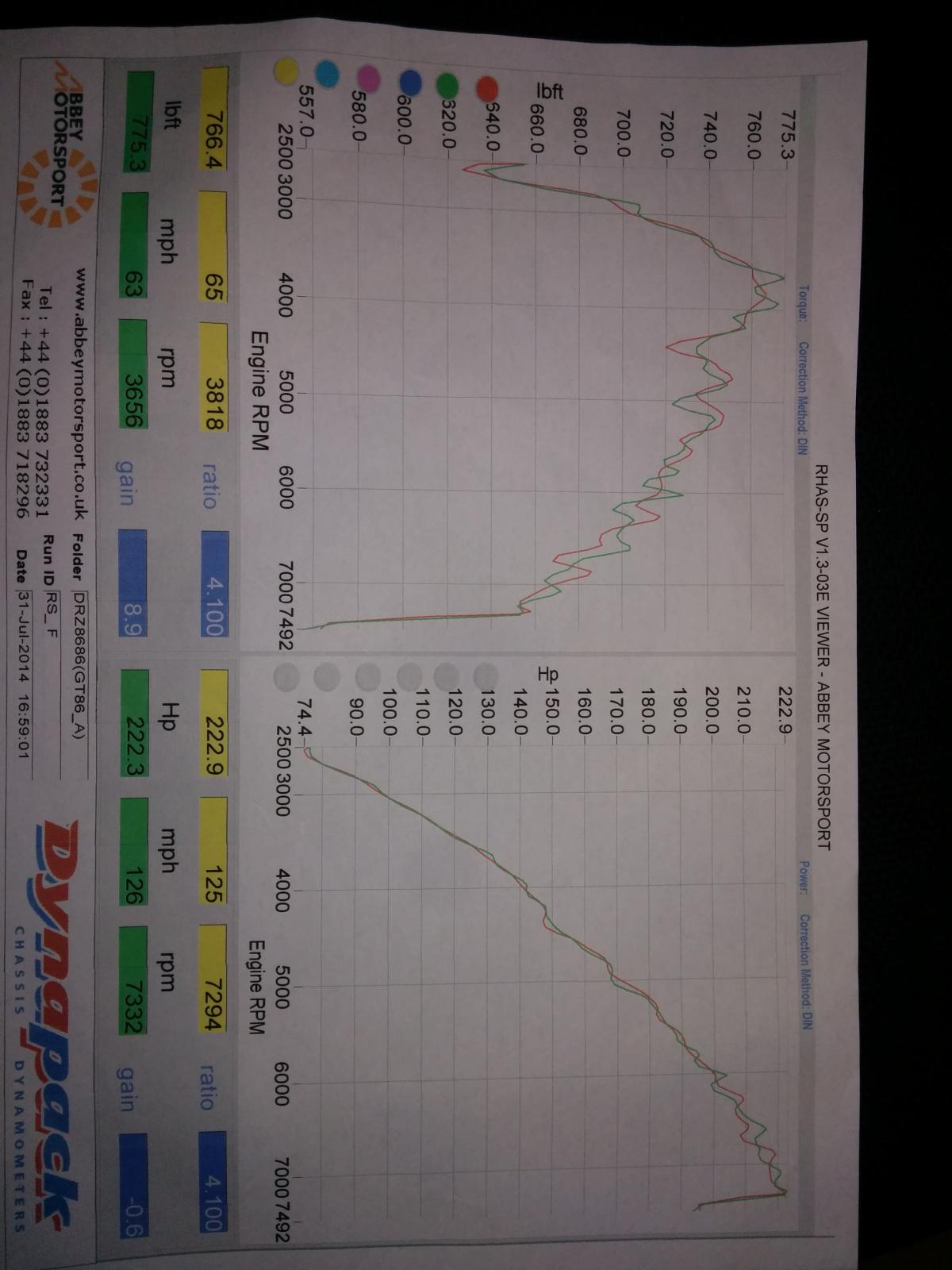

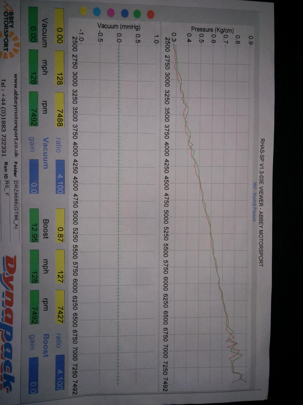

rob275 1817 Report post Posted September 2, 2014 Let the methanol discussion continue! James has his car back, he will post dyno plots up. Think Mark will swing by with the AIT in due course Share this post Link to post Share on other sites
CHOSENMAN007 81 Report post Posted September 2, 2014 So as you all know I have had a devils own kit fitted. We had had a awesome debate. So it is data that was needed and I will post it below. There is a before and after water methanol injection dyno runs. Point to note I'm running a stock 75mm pulley and the other point to note is I'm an auto and results are always 10whp or so less than manual cars.Mark himself will post iat data to follow. For him to post data says it all really in my mind. Also since I'm the first fa20 in u.k to have this set up and mark and I are very pleased thus far. Obviously I left abbey with a massive smile as that's the normal effect they have on me over there. Before. S.c no water meth. Share this post Link to post Share on other sites
