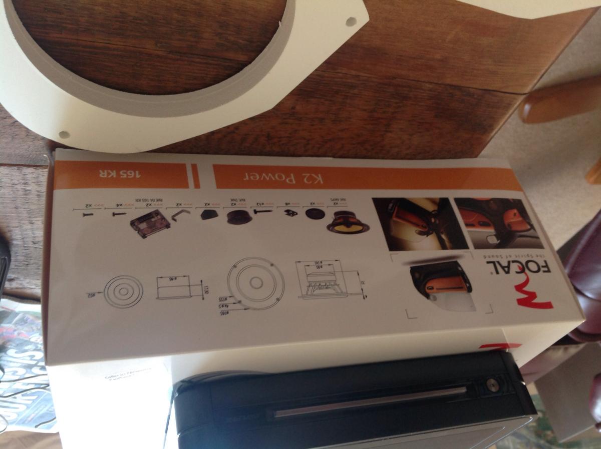

Components for consideration are
6.5" Focal door speakers and tweeters
mounted using spacer plates

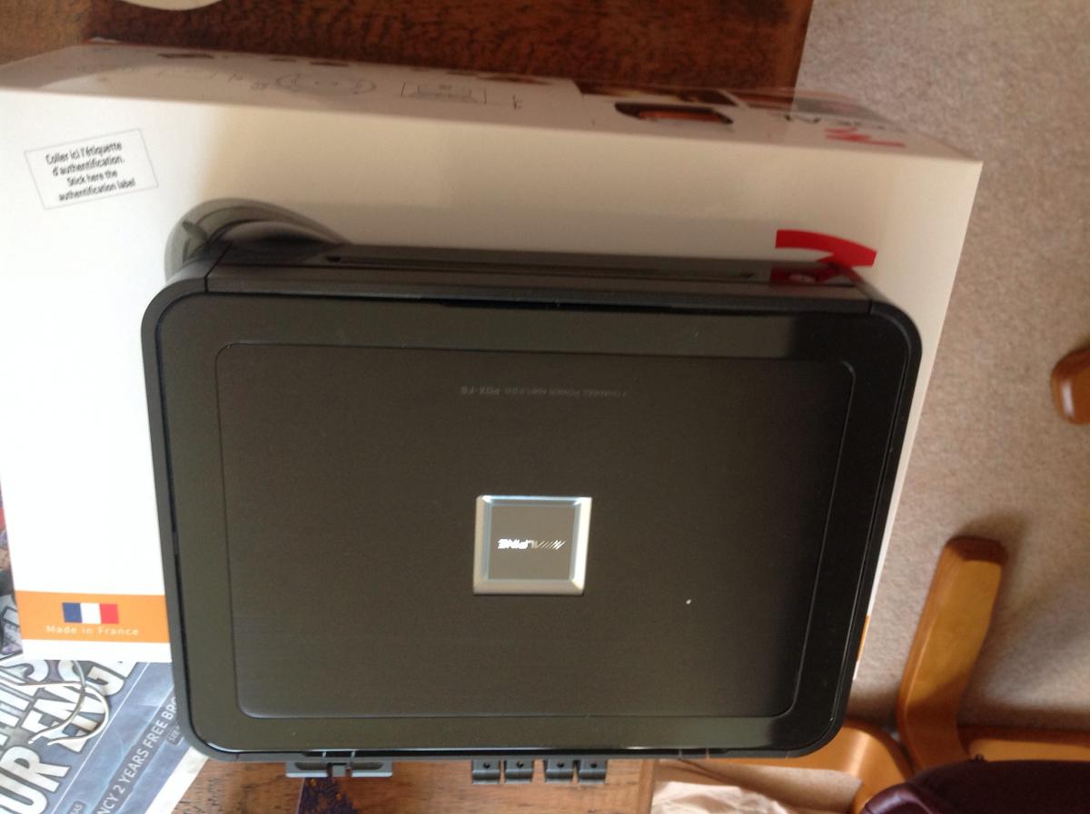

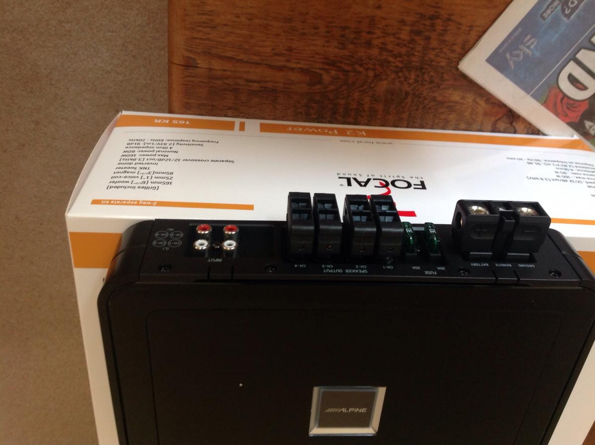

Just bought an Alpine amp,
seemed cheap enough, dealer was selling it off as "demo unit" PDX-F6 4 channel,
will probably look to mount it together with the crossovers in the boot.

Just need to decide on which Focal 6.5" speakers to fit?
Any ideas?

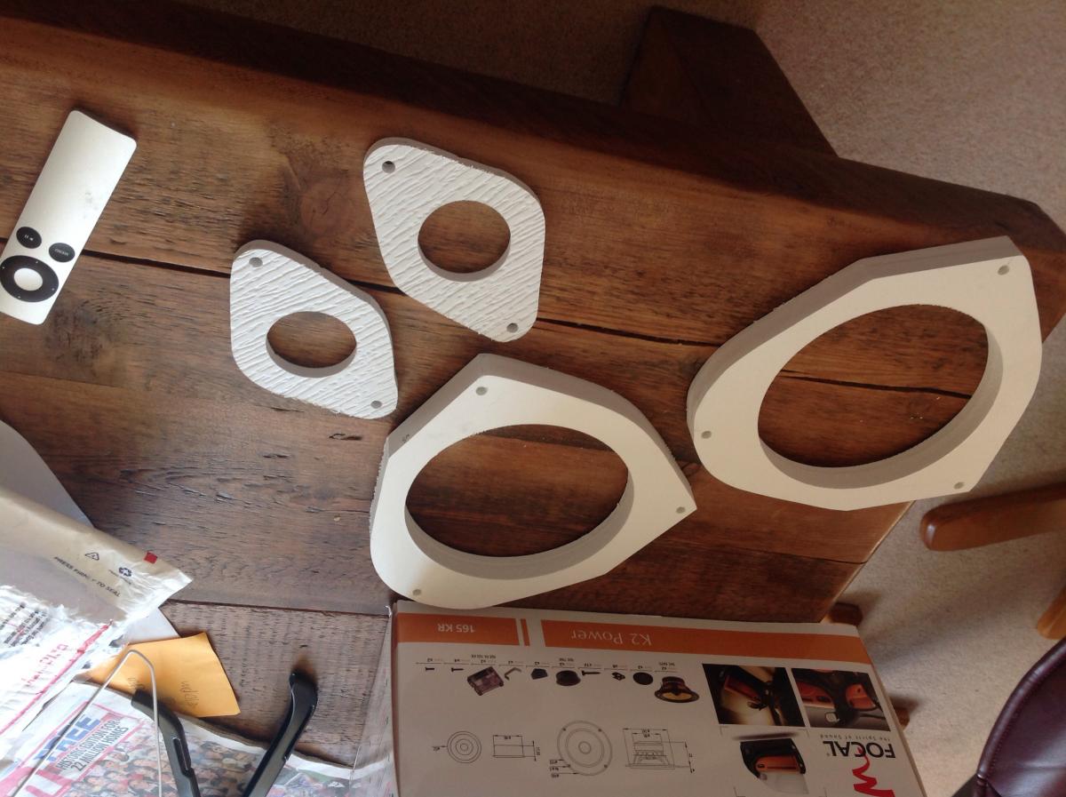

Just ordered the speaker template/baffle from Patrick Henry today,
which will place the tweeters in the oem position
