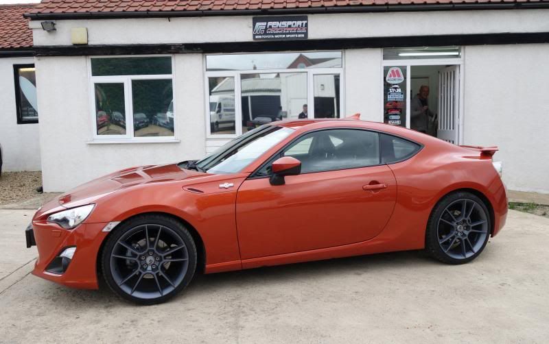

We had this gorgeous orange GT86 owned by Peter Talos all the way from Hungary for Avo installation no 11 :)

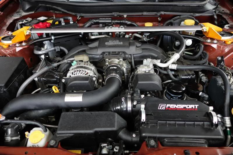

This one was fitted with Avo stage 2 kit including electronic boost control and 2 maps. map 1 is low boost, 0.45 bar and map 2 is high boost 0.65 bar ... switchable on the cruise control stalk.
At the same time the clutch was upgraded with the Helix organic to take the torque, a Berk sports cat and Miltek system were also fitted.
Suspension has also been upgraded with Koni shocks and Tein springs and of course the stunning Five Axis S5:F 18 inch alloys in gunmetal :)
Our first LHD car, the kit fitted no problem at all and we and Peter were very pleased with the whole package :)
Ready for surgery!
Underneath finished
All done

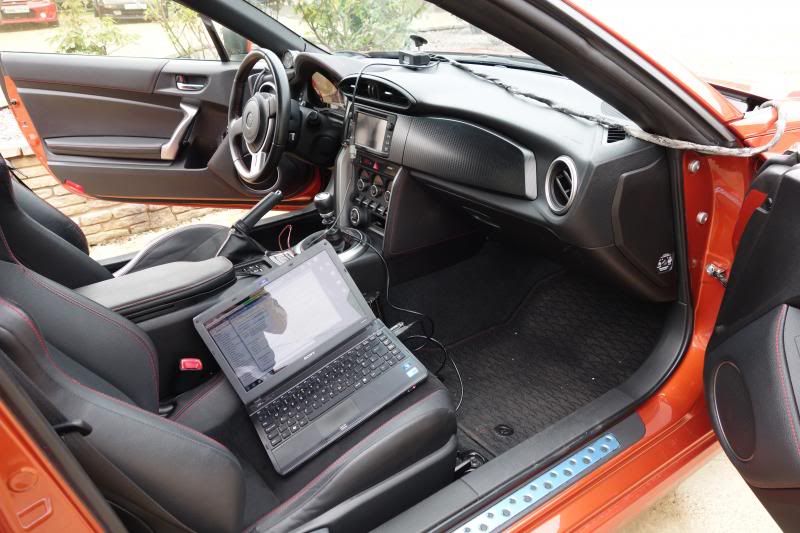

Map time

LHD ... looks just like a mirror image :)

Nice work! Looks so good! Interesting wireing going on in the Map Time Picture! :)
Are the wheels 18" or 19"?
Thanks Jay,
and well spotted ... it's the Motec wideband lambda meter :)
Wheels are 8 x 18 :)

Hi Adrian,
I have to correct you: they are actually 8.5 x 19" wheels :-)
Woops sorry Peter !!  I thought they were 18's ..... my bad  :)
Stunning car though, how is it going?
