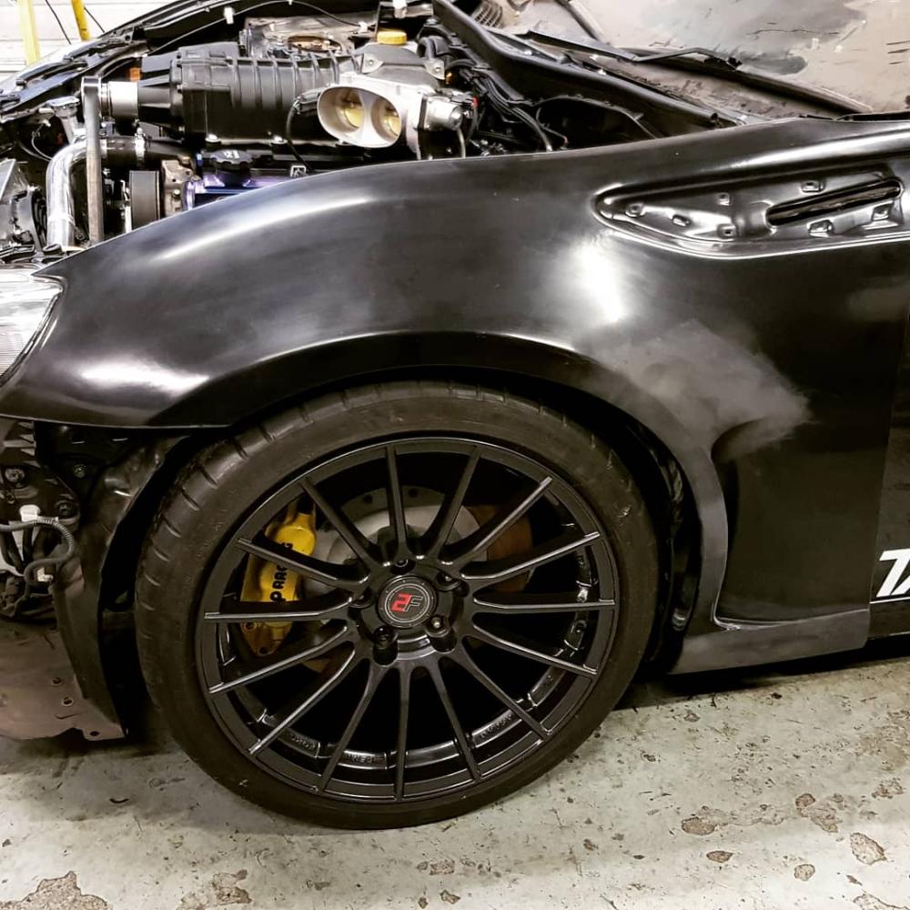

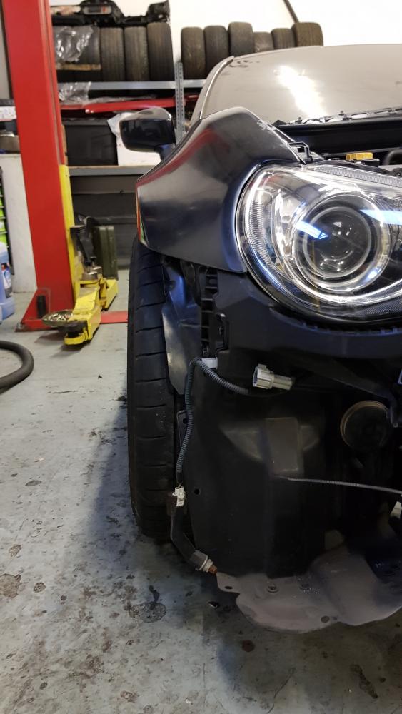

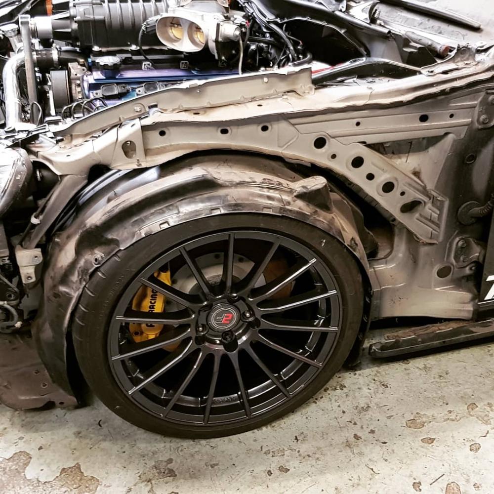

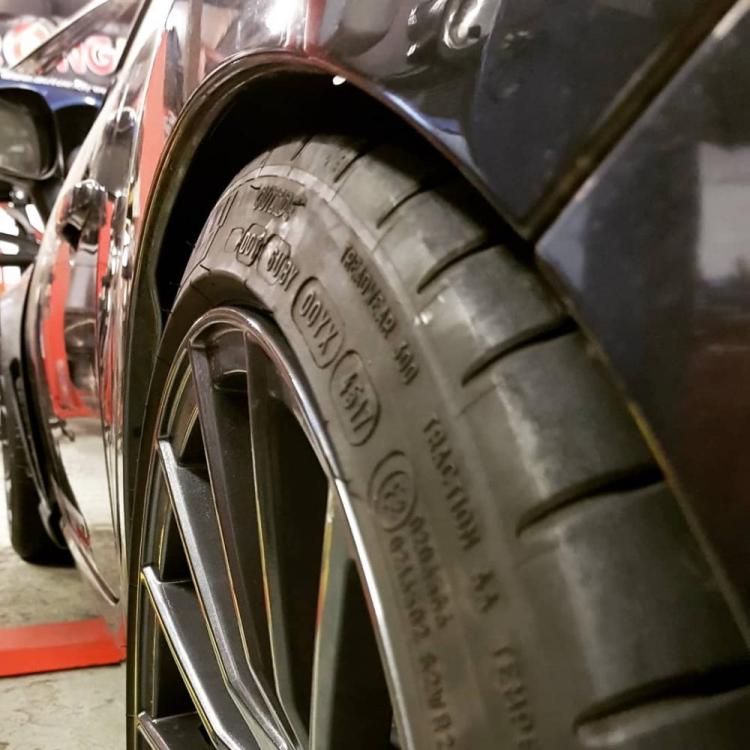

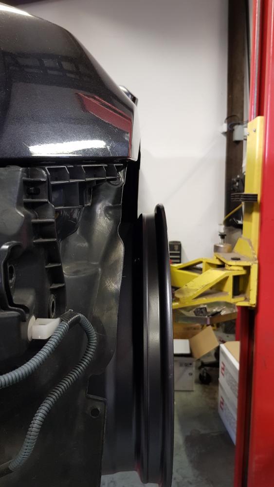

In the meantime, Michelin Pilot Super Sports mounted to the 2Forge ZF1 wheels and fitted along with the Todoroki 30mm wider front wings too.
Fitment looks spot on, just a tad of fettling to be done where the wings meet the sills.

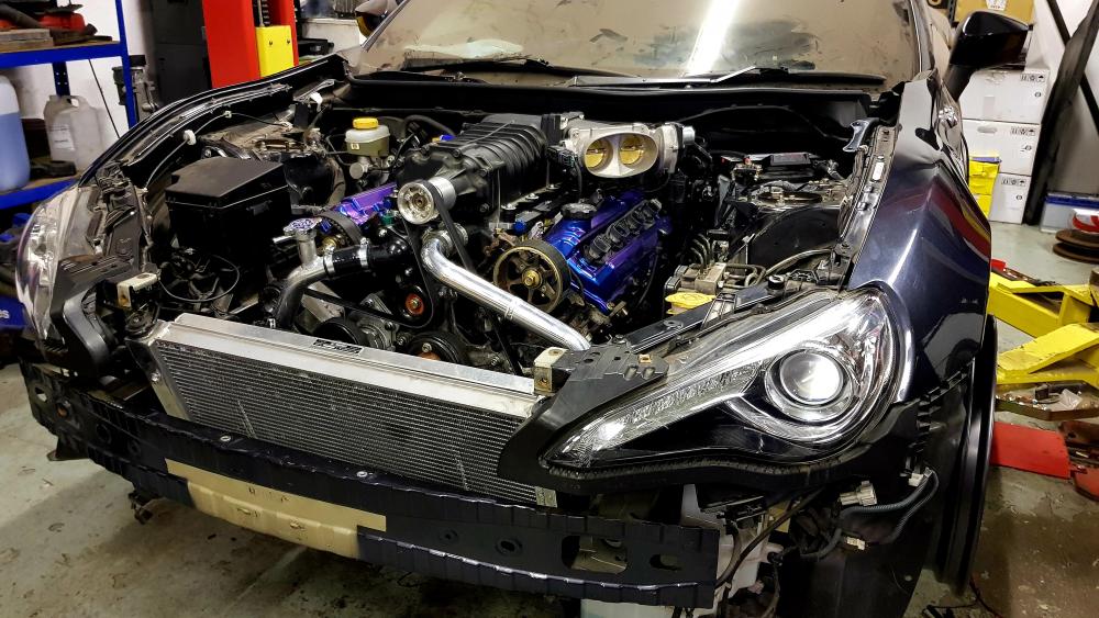

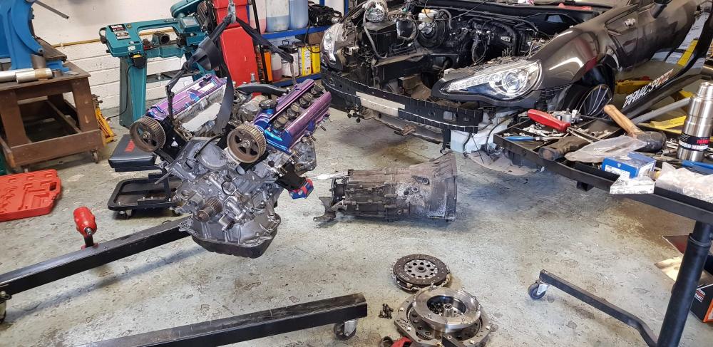

It's taken Carson Performance just 4 days to completely change the engines over and get the new one ready to fire! Their work and determination has been astounding. Never afraid to overcome and issue and put in the extra effort to get things done right.
Today I helped put the finishing touches to the water pipes, reinstall the supercharger and wiring loom. All ready for us to load the base map into the Motec and push the start button.
Unfortunately after hours of trying, we got stuck with the ECU software. Turns out the map was written for 2017 firmware and mine has 2016 firmware on it
such a tiny mistake has halted us at the final hurdle
Obviously not getting my Christmas miracle, but here's hoping some good news still to come for 2019.

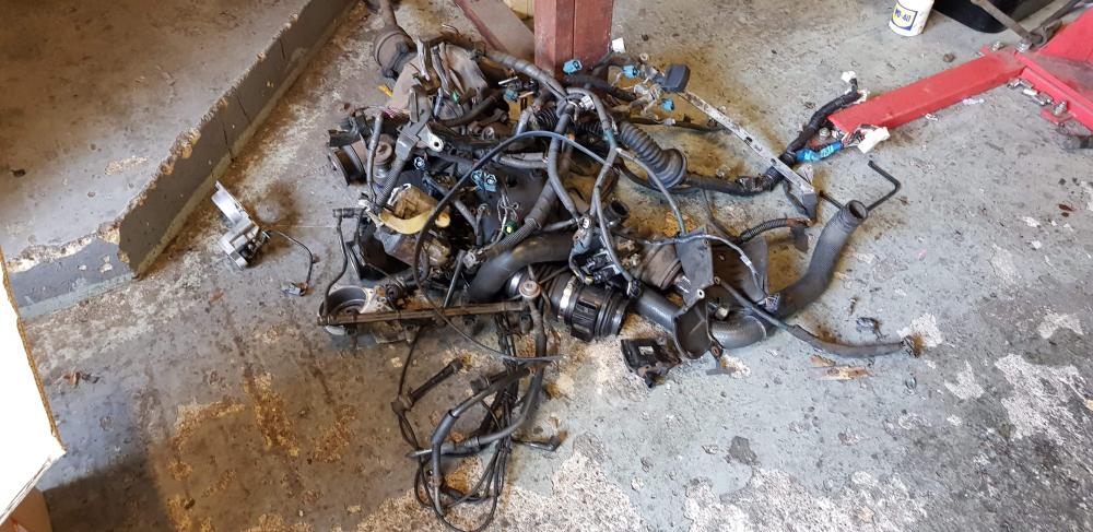

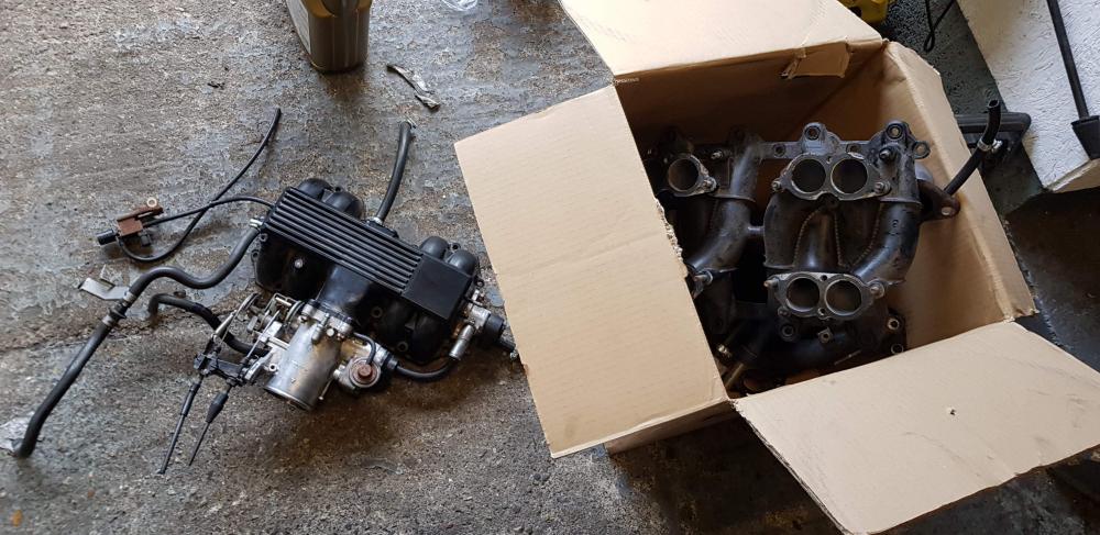

Luckily, I've managed to source an engine that I've seen working previously that's already out of a car and only about 90mins from me. So I'm picking it up tonight and dropping it off at Carson Performance for them to crack on with the change over.
Saves me a bit of money not buying a whole car, saves Carson a day or so of labour getting it out of the car and also saves me a load of hassle having to split the LS400 to make my money back.

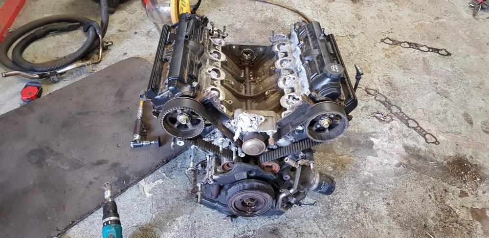

Water pump doesn't change anything, so it appears we have a fucked engine.
Only thing we can possibly think of is that the heads have been skimmed WAY too much, causing the cams to sit down too low and therefore make the belt slack.
2 options:
1. Source some replacement heads and pray that the block hasn't also been skimmed to death
2. Source a completely new engine/donor car to transplant into the 86.
I'm thinking option 2 is the best, albeit the more expensive and time consuming, as at least then we'll know the engine is in decent shape rather than guessing what state it's in.

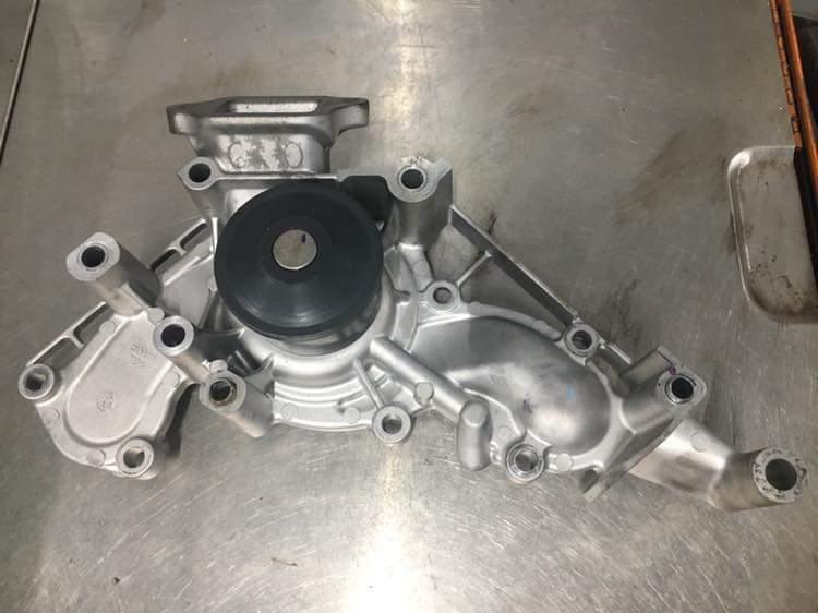

We found late last night that the timing belt wasn't tight enough for some reason. There was so much slack that you could spin the water pump by hand with the belt in place. So we assumed there must be an issue with the timing belt kit and I was on the road at 7.30am to pick a new one up from Birmingham (the only place I could find one in stock available to pick up on a Saturday).
Turns out, the idler and tensioner pulley were fine and the belt is correct. So just 10miles outside Birmingham I turned round to come home again 🙄
After much deliberation, we believe that the water pump itself isn't quite right. When comparing ours to Google images and other 1UZ owners, it just doesn't match. So once again, I'll be on the road early hours of tomorrow morning to fetch a brand new OEM replacement all the way up in Ipswich 😴 I pray that this solves our issue otherwise I'm completely stumped and just about ready to set this sodding thing on fire.
On a lighter note, I installed the rear 5x114.3 hubs today so the 86 is now fully Jap fitment! 🎉 and I had a seat in the car for the first time in about 2.5 years so we could bleed the clutch. Felt very odd sitting inside my own car.
Let's hope Monday morning we have some good news concerning the timing belt mystery...🤞

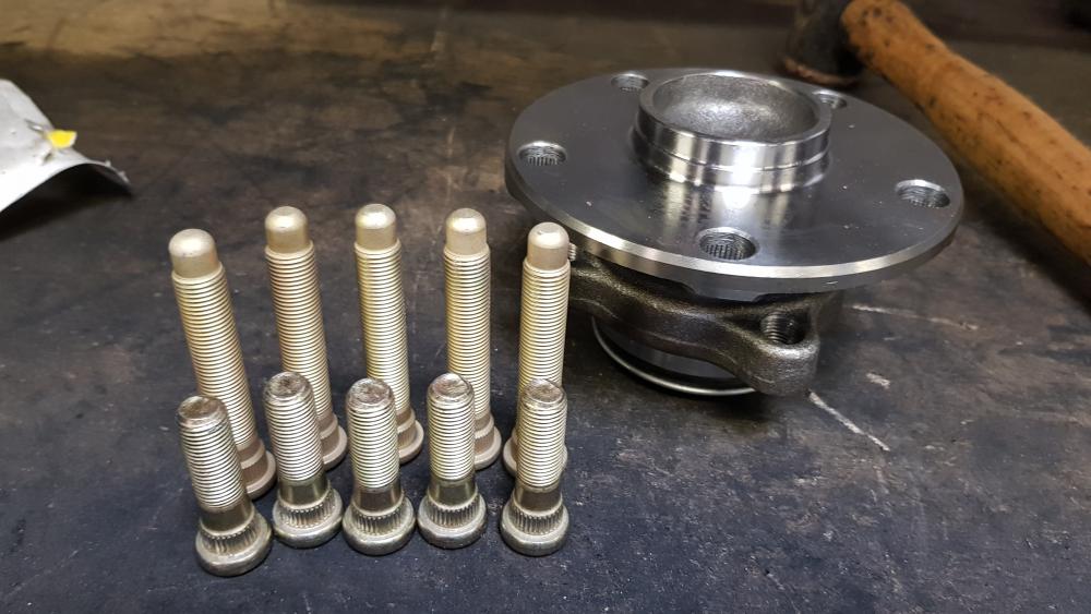

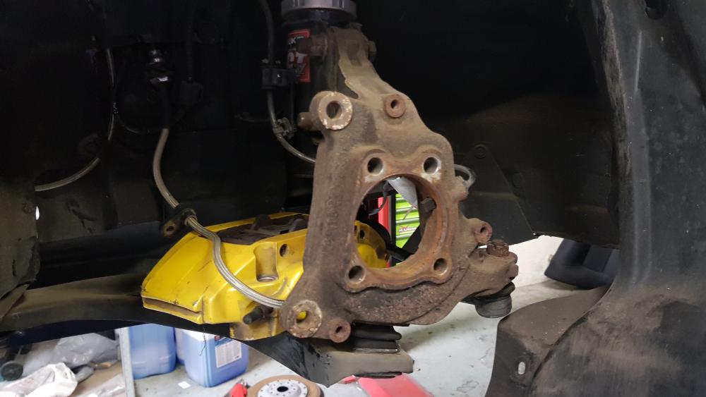

1st chance I've had to do some work of my own on the car today!

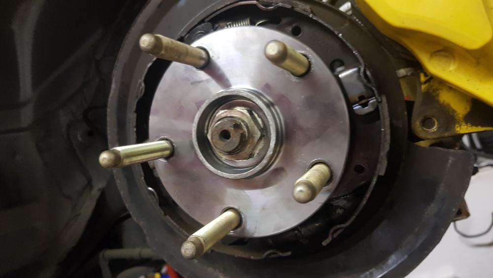

Finally got round to installing the new 5x114.3 hubs, complete with new ARP studs for extra strength and length.
Fairly simply procedure taking about 2 hours in total, didn't manage to do the rears yet as I had to leave the garage just after lunch. Had a quick test fit of the new 2Forge ZF1 wheels, should be a nice fitment with the new front wings.

35 minutes ago, Luke said:They are nice wheels and look similar to the brz sti wheels. How have you changed the hub pcd, is it re drilled oem hubs, modified subaru wrx sti hubs?
Also why would you go through all that effort to fit a wheel that comes in 5x100?
What spec were those zf1's you got from tarmac sports?
I didn't do the conversion specifically for this wheel. I did it for a wider choice of wheel in the future.
Partshopmax do the front hub conversion, whereas the rears simply bolt on from an 08+ Impreza WRX STI.
I would've gone with my usual 18x9.5 but 2Forge only do 8, 9 and 10J. So I've got 18x9 ET32 on the rear and ET2 on the front to accommodate my new Todoroki wings.
Then once I've sorted the rear end out I'll get another pair in a wider width and offset.

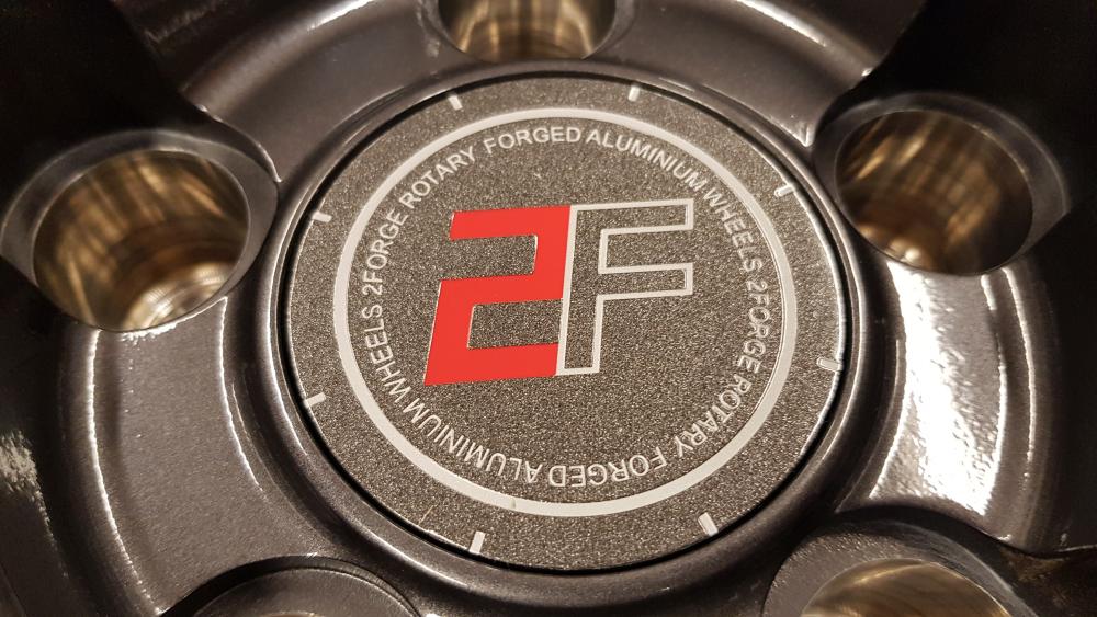

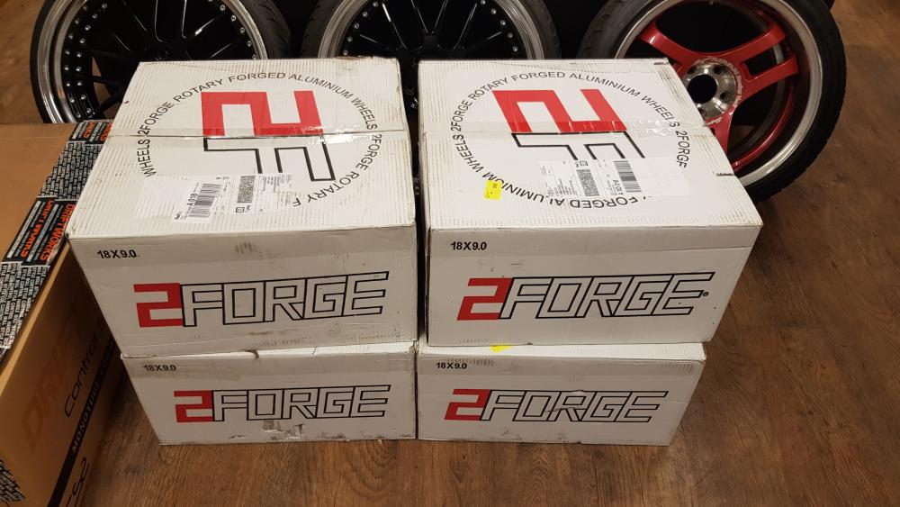

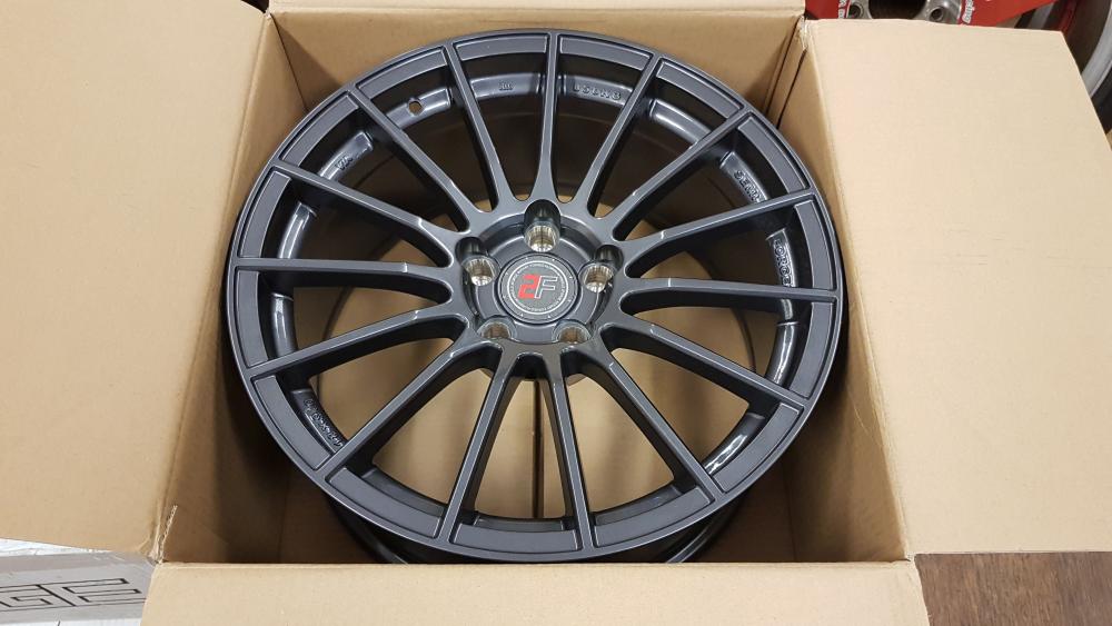

In the meantime, a few more goodies turned up today.
2Forge ZF1 wheels courtesy of @Tarmac. Lovely forged units so nice and light, but at an affordable price compared to most forged wheels!
AEM water/meth injection kit courtesy of @Mark@Abbey M/S. Went for the upgraded 5gallon tank as I think my charger will eat through the meth, especially on track.
Also had my rear 5x114.3 hubs arrive so I can change all 4 over the weekend.

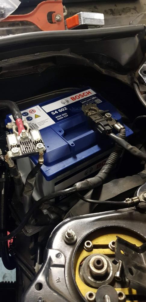

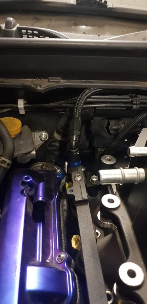

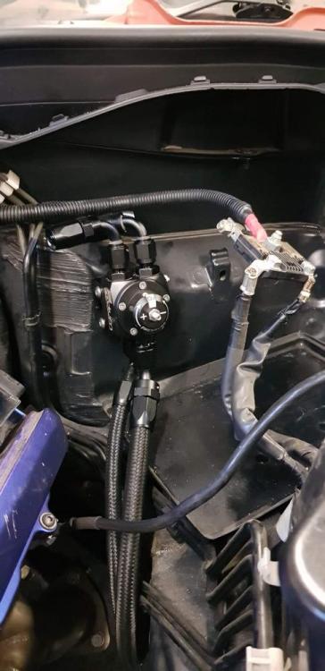

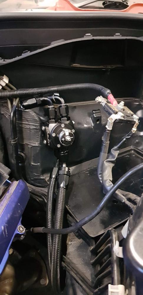

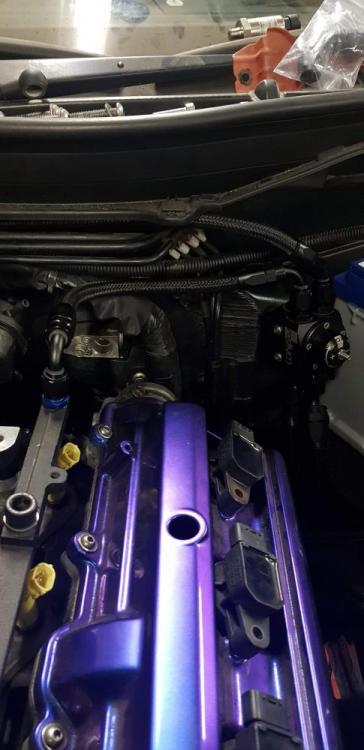

Fuel system installed, lines run, pressure regulator mounted and connected into the fuel rails.
The new FPR has to be mounted near the battery so we bought a slightly smaller unit. Unfortunately didn't realise the terminals were opposite to the OEM setup
so another slight delay until next week.
