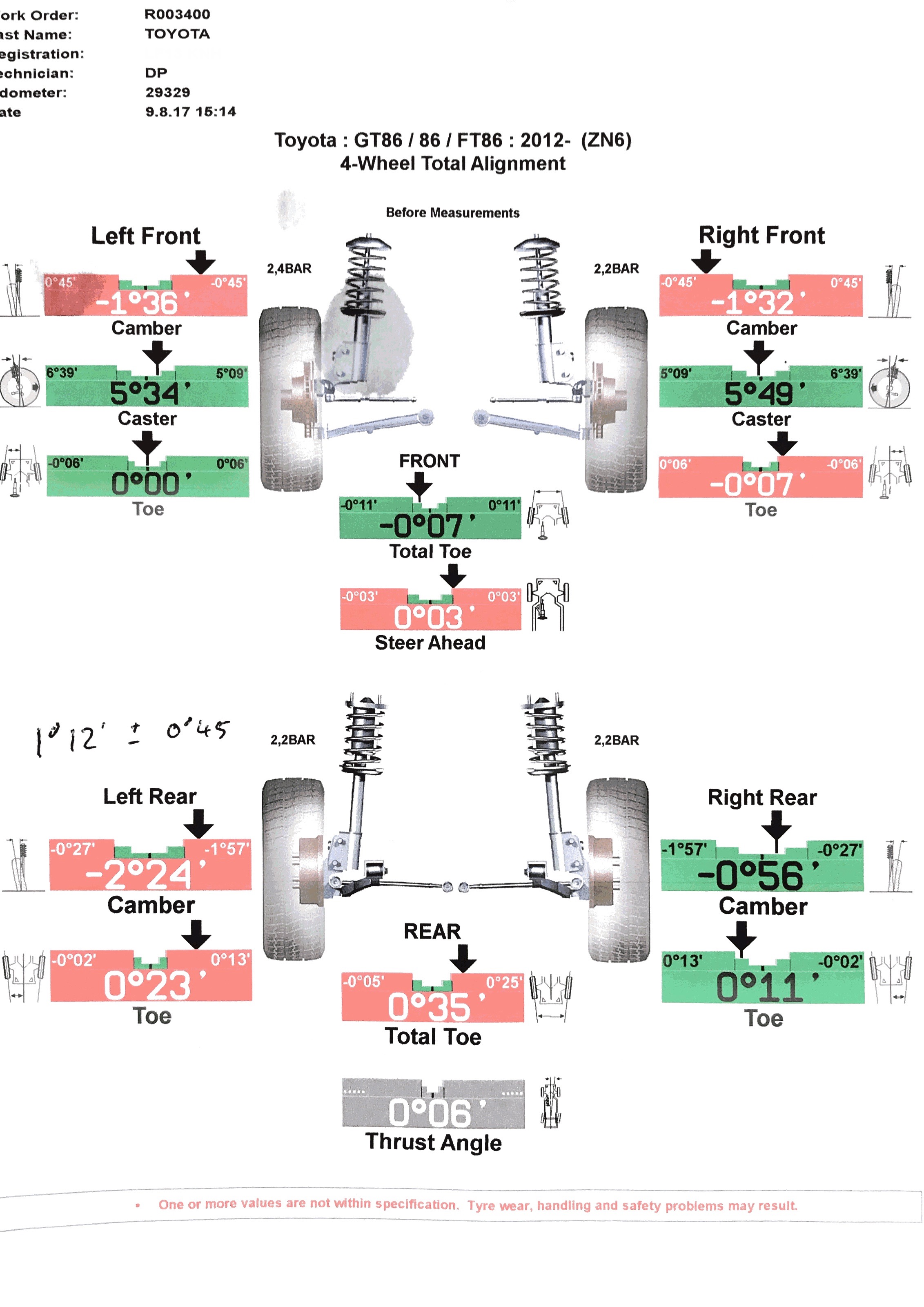

My results are in and they are not very pretty.  I am still about 90% sure the issue I am having is not alignment but rather the tyres, but the alignment sure isn't helping the rear of the car.  The front is still pretty acceptable (toe needs fixing) and seems like an intentional setup (using camber bolts), but the rear is just broken and has no adjustment available. See attached image for fun evidence
Going to chat to Toyota to see their suggestions and if nothing useful, will probably be looking at some camber arms.  Any suggestions on those? The ones I have seen are:
Don't know, maybe track specifics, or cheap tires i usually got, or my lacking driving skills or all of the above. Most often times i've been to small tracks (made for karting) with slow awg/max speed & tight/slow curves, eg. this or this, ones that are 95% driven in 2nd gear :). Only this year i got to "real" track too. (of course none of these videos are mine, just something googled up on those tracks).
Innersphere: WTH with camber on left rear? Have you heavy hit something with it? Most probably that s the culprit, or rather that much difference from right.

Imho you don't need rear aftermarket toe arms. Toe is adjustable on ours both front and rear. Camber on stock twins is which is not adjustable. Adjustable aftermarket toe arms usually are needed only for cases, where stock adjustment range is not sufficient.
Great question Church...  I wish I knew WTH....  I have only had the car for just over a week and I haven't hit anything, so who knows before that :blink:

Your toe is just terrible, it's all over the place. Things like this will be the likely cause in all honesty. The car isn't tracking straight at all. It's not going to feel good.
As for adjustable rear lower arms, I have the SPL ones. Billet aluminium and things of beauty. Undoubtedly the best you can get. They are rose jointed too. £540. A lot of money, but they are just a lovely bit of kit. If you could you would, I reckon. ;)
Hahaha - well put - terrible indeed!
I didn't want to try sort the toe till I get the camber sorted otherwise I will have to do it all again.  As for the SPL LCA's, they are just a bit past my threshold of want vs need :)  If you weren't getting those, what would be your next best option?
