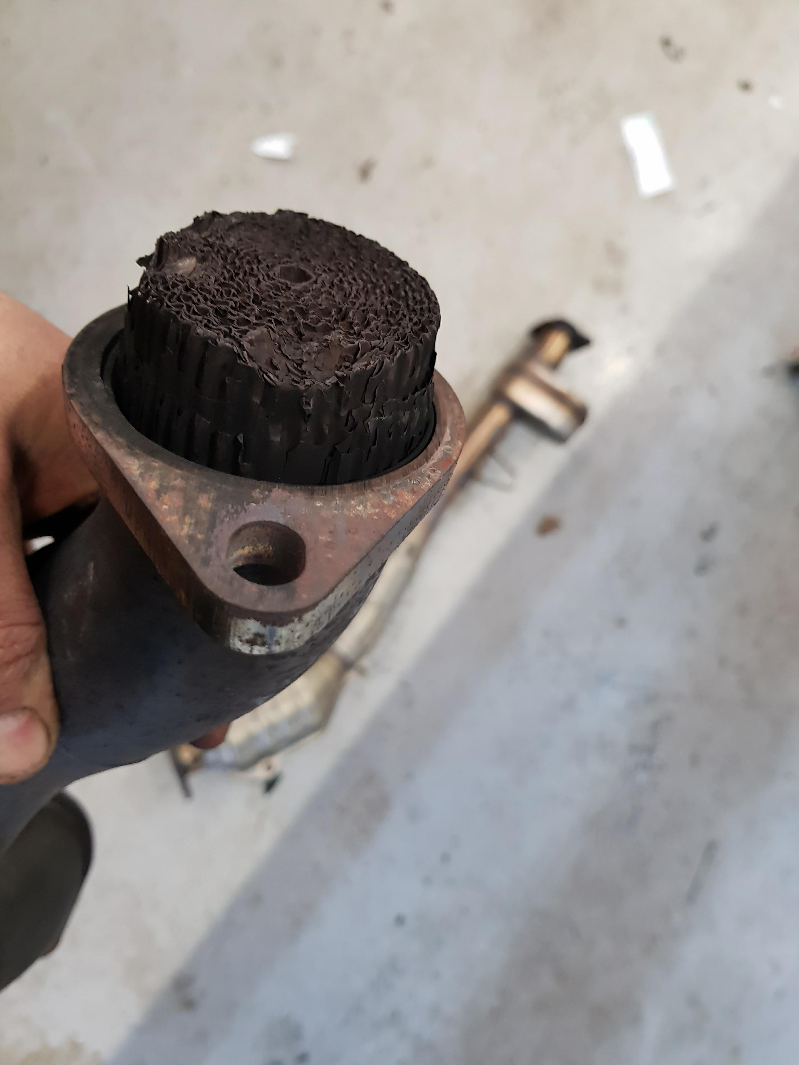

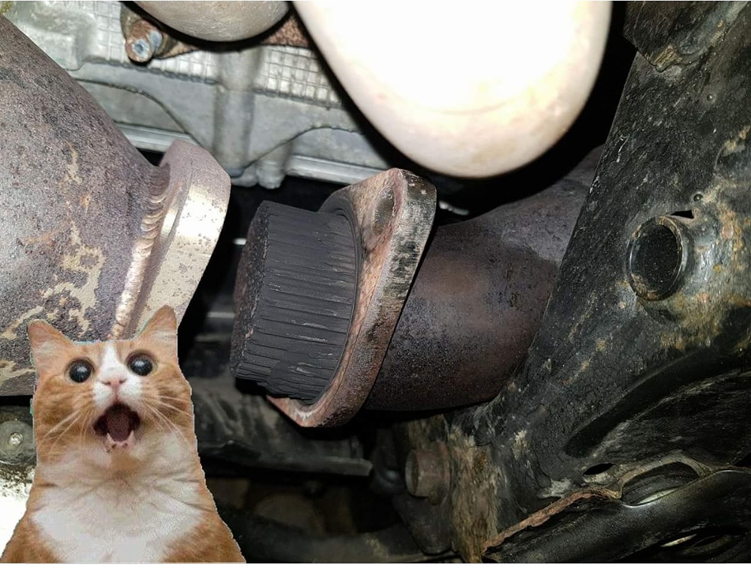

Yeah, how does the standard manifold hold up from your research?Yep, catted manifolds and track work don't seem to mix well. From what I'd read before I knew it was likely to be a case of when and not if for it failing so it wasn't altogether unexpected.

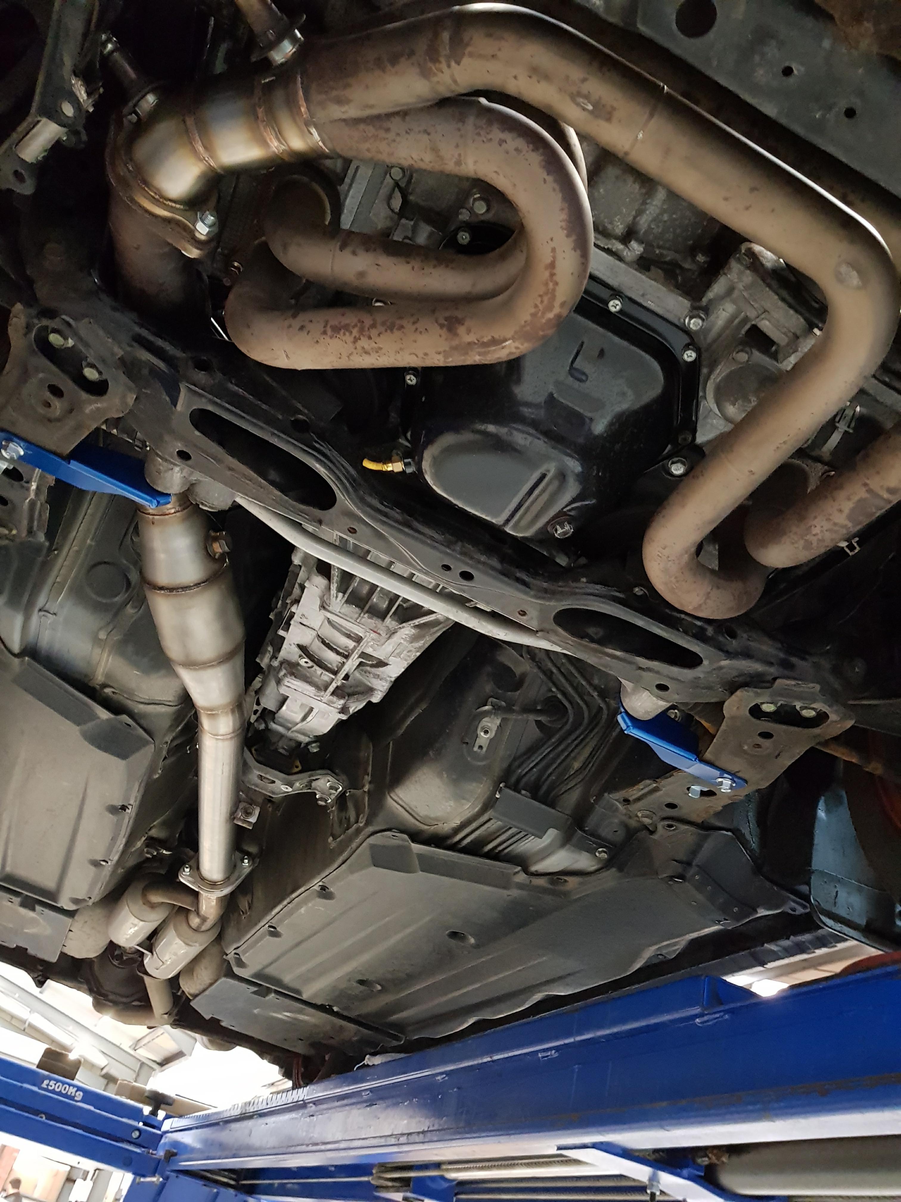

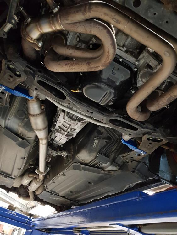

Oops!! 🤣🤣I had a few exhaust tweeks done at Rogue Motorsport this week the main one of which was swapping the 2nd oem cat for a high flow item. While Rogue were doing the work they found that the cat in my JDL manifold had come out and got itself rammed into the overpipe! They replaced the overpipe for me and also reworked the catted manifold to make it into a catless version.Couple of pictures below:-
And the reworked manifold and high flow sports cat in place:-

As you can see it's a little louder now but not massively so. I'm not sure how it'll get on with Bedford's noise limits but I had a reasonable amount of headroom before so I'm hoping it'll be OK. If not then I'll look to have a resonator added to the second cat pipe.
