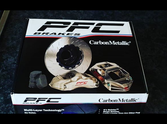

i had a trackday at angelsey booked so decided to upgrade the brake pads to some PFC Z rated pads after reading good reviews on here about them however i think i broke them when bedding in so not sure i got the full effect on track but they alas they worked well enough thanks to a cold day with lots of rain in the afternoon but we shall move on quickly from that brake pad situation i still had a great time and anglesey is an amazing track

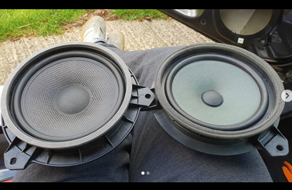

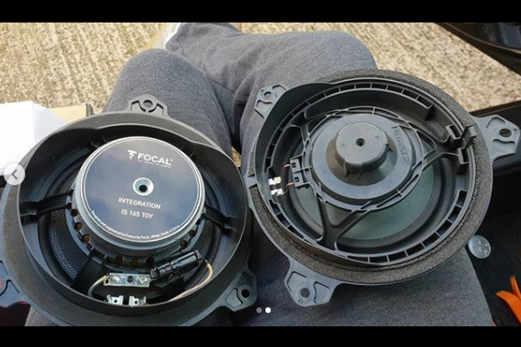

next up was to do something with the stock speakers as lets face it theyre shocking... even moreso when my previous bmw had the harmon kardon upgrade... i decided on the plug and play focals along with some sound deadening for the doors, rear quarters, under the rear seats and bits under on the boot floor - alas some decent (enough) sounding music whilst driving my fave ever car!

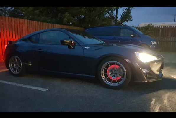

the most recent thing is that the car has had some new brakes thanks to my mate giving me his wrx 4 pots and the car has had the TD NA package which i can only describe as wizardry as to how much of a different it makes to the car 😍 much more driveable, much more fun, much more (a bit too much tbh) noise

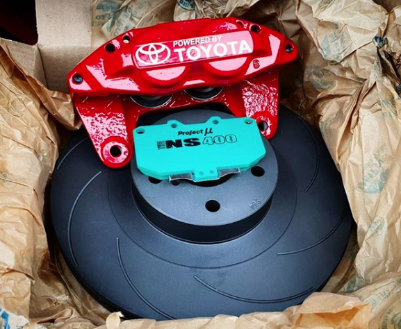

the boots on my stock brakes melted
ive just changed to wrx 4 pot calipers on the front with braided lines and pmu ns400 pads also fitted slotted discs
whilst actual braking "force" is a bit less, the caliper and pads/discs should handle heat better -

On 12/22/2018 at 12:30 PM, Lmc said:Treated the car to a couple of xmas pressies.
Got a beatsonic sharkfin aerial from Fensport which i must say was fantastic service, & finally got around to buying the focal is165toy speakers.
just fitted them both & at last i can listen to music without the crackling noise.
the focals get better and better the more theyre used too
