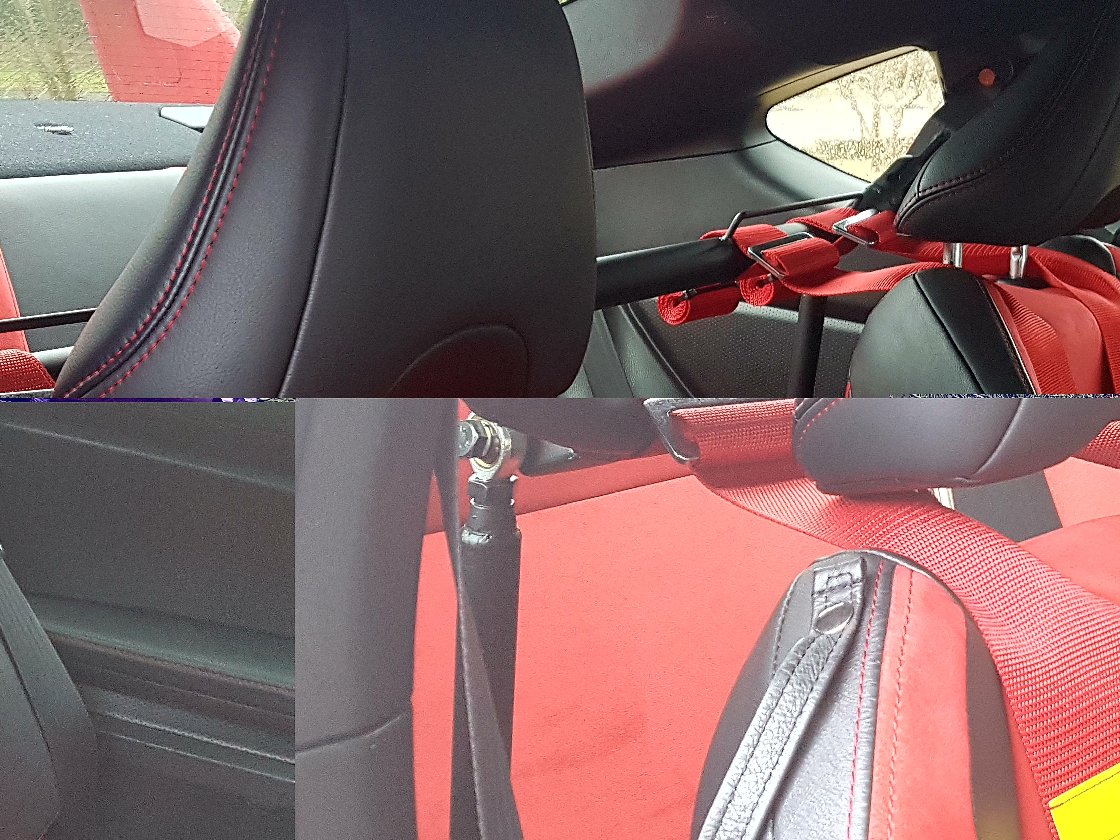

KevinA 695 Report post Posted April 19, 2017 I have harness bar with harness and stock seat, my Hans device is fine too. 1 GT86Bob reacted to this Share this post Link to post Share on other sites
KevinA 695 Report post Posted April 19, 2017 1 GT86Bob reacted to this Share this post Link to post Share on other sites
