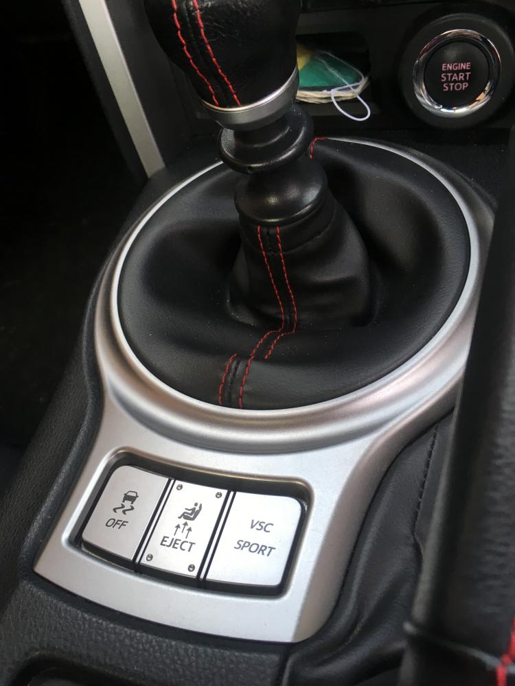

On 11/6/2018 at 2:32 PM, TommyC said:;-) Where did you get this from?
ok, I found them
https://everythingvinyldecal.com/collections/fr-s-brz-86-faux-button
3 hours ago, TommyC said:Or standard ones for about half the price...
