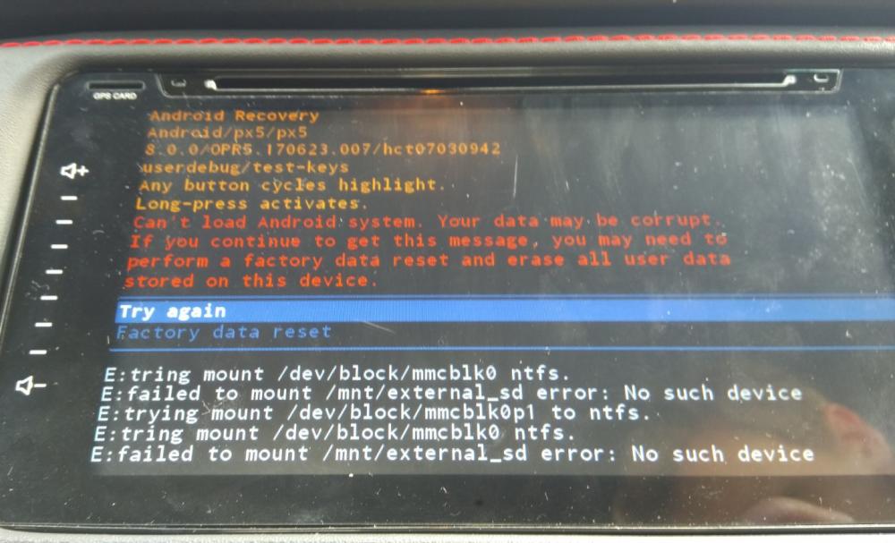

4 hours ago, Graham86 said:Looks like it's a hardware issue. I've taken the dash off and run it without this fitted, no issues. So it looks like it could be overheating. I can't see why, it has plenty of air flow around it.
I've seen a few issues with overheating on the px5 unit this is based on and people installing new thermal paste and heat sinks. Can you download a temperature app and check? Are you using the head units amp to power speakers? I've used a separate amp since installing which is why I may not have encountered any overheating.

2 hours ago, Graham86 said:Never had that but I loaded another firmware pretty much as soon as I got it. You could try start in bootloader/recovery and delete the cache. Other than that do a factory reset on that screen and hope it's not hardware related.

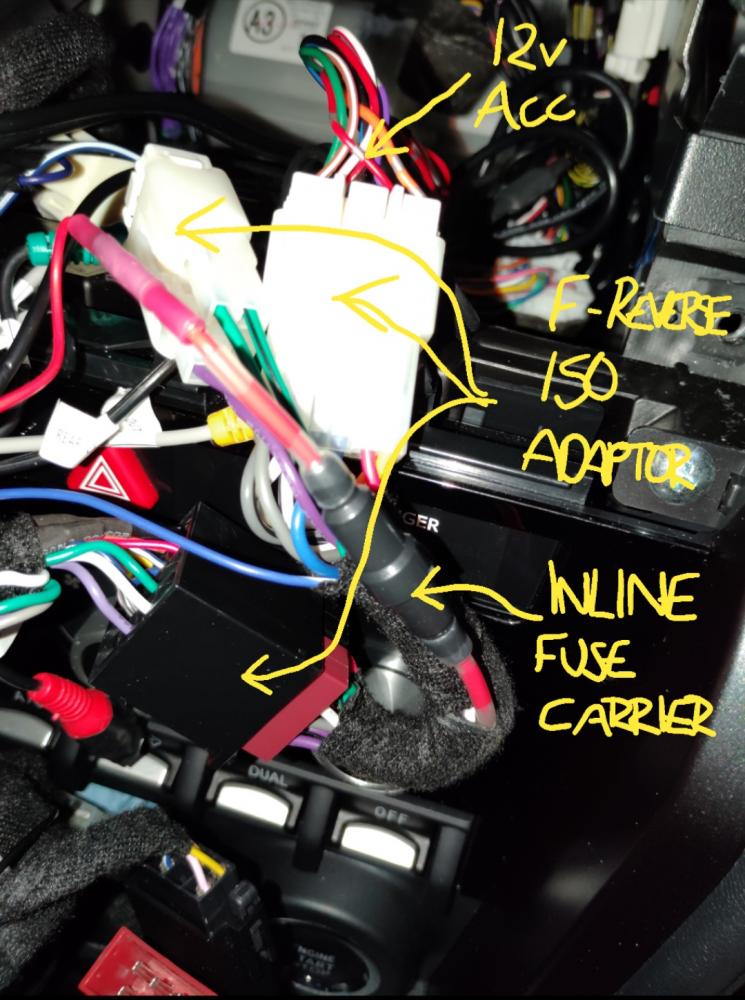

9 hours ago, Cadders96 said:Where is the 12v acc? I bought the camera and adapters from incartec not a genuine one
Does the camera have a power lead running along side the yellow RCA cable? It's been a while since I installed mine but just had a look. I remember that I bought an F Reverse ISO harness so that I didn't have to cut into the factory wiring. Took the 12v from the Acc/Switched wire which is the grey and red striped one. Put an inline fuse carrier in with a 1A fast blow fuse to protect the cable. You can take it from here or like Leeky said you can take it from the cigarette lighter.
Probably not the 'correct' way but I paid £10 for my camera & £10 for an adaptor. Rather than the £130 for a kit. Already had inline fuses and crimps etc. Camera is 12v so doesn't have a step down transformer so nothing to get hot. It is permanently on, it's fused so the camera and wiring is safe, and it's worked flawlessly for the past 18 or so months.

As stated above that is the correct one.
The camera also has to be powered up before the head unit as I found out when I wired mine in with the reverse lights initially.
Mine is wired from the 12v ant power behind the head unit with an in line fuse to protect the cable. Running 2 years with a cheap Chinese £10 camera with no issues.
