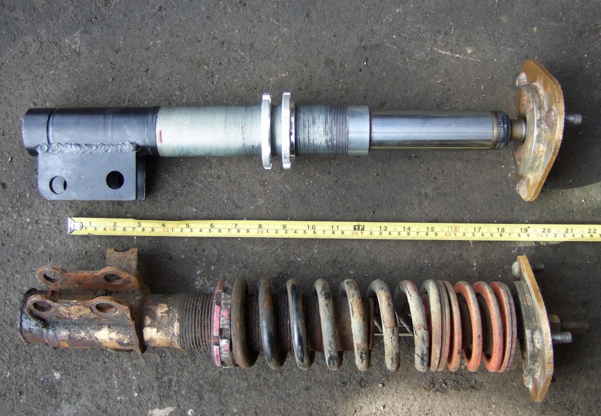

Guest Report post Posted August 25, 2014 Thanks for that detailed reply Lauren. As for labour cost, there wont be any, as I will fit the set up myself. I may pay for an alignment, but if I do, it would be my first?? I will look into the Tein set up, I wasn't aware you could buy AM programmable suspension? As a 51 yr old Engineer, I know exactly where you're coming from when considering Taiwanese materials. I'm just not convinced?? One thing I did notice on the HSD set up is that the front lower strut section is fabricated from steel, whereas the Ohlins is alloy. I wonder if this would be a better option for a UK based road car. We've all suffered issues where steel and alloy meet water and salt!! Thanks again. Share this post Link to post Share on other sites

toyokid 27 Report post Posted August 27, 2014 a pic Share this post Link to post Share on other sites
