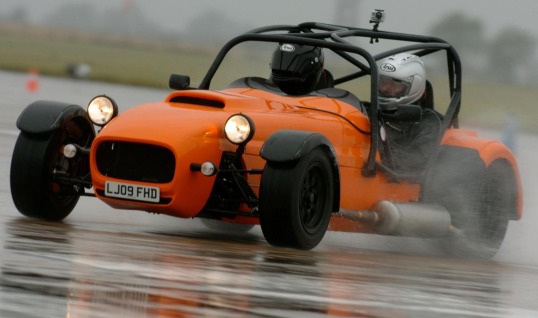

Here's a picture of my current toy
It's a Westfield Megabusa, 528 kilos and just shy of 180 bhp. Built by me at our old workshop with a few mods during the process.
It's now got a decat exhaust,flatshifter expert and I remapped the ecu.
