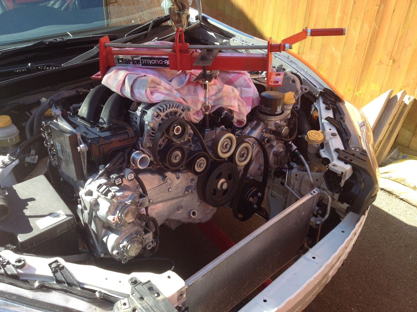

It is very easy.. I finish work at 16:00. The last time I took the engine out of mine, I finished work, went home, changed and had the engine out by 18:05.

There is a bolted on lifting bracket on the rear right of the engine. For the front, there is an M14 x 1.5 tapped hole next to the air con compressor. I have made a lifting tool using a long bolt and a 7/16" eyebolt.. you can see it here..
The fuel lines on UK cars have jubilee clips holding the rubber pipes to the steel pipes.
