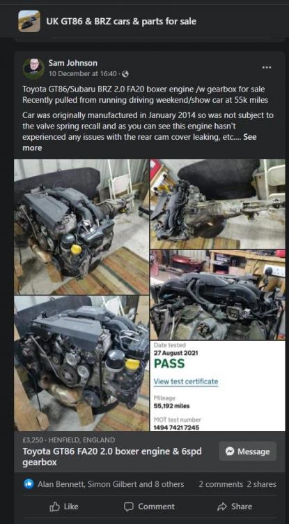

will300 812 Report post Posted December 20, 2021 A full rebuild is around the £4K mark, if you only need the top half of an engine it might be cheaper. Here's a couple of places / people that might be able to help you source an engine. They can be found from £2000 to £4000. @Samwise has one for sale - see attached image. Abbey Motorsport, Fensport, Tuning Developments, Rogue Motorsport Sam Nadeem - https://www.facebook.com/Saam27 Matt Baker - https://www.facebook.com/MBDevelopments1 2 imonw1 and Samwise reacted to this Share this post Link to post Share on other sites
